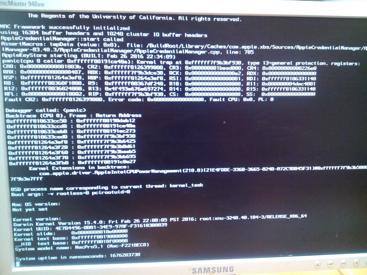

Hi Rockey, the modified DSDT loads fine but I am still getting the panic with the modified config.plist and I get this boot screen. If I use the original one It lets me boot without problem into the regular clover boot screen and normal boot on the OSX hard drive.
Thanks.

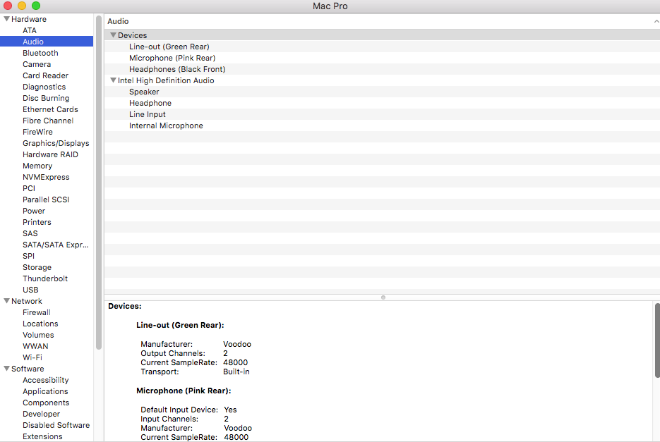

Hi Rockey, I think the config.plist is fine. I wanted to fix the GPU showing as ethernet and having working audio. You mentioned a few posts back that we must eliminate Voodoo kext from the system. I tried to get rid off it but I think the Voodoo drivers are embedded into the AppleHDA.kext. I can still see audio from voodoo even thought I eliminated all the kexts related to it.
I am using your AppleHDA.kext but for some reason I still get voodoo audio.

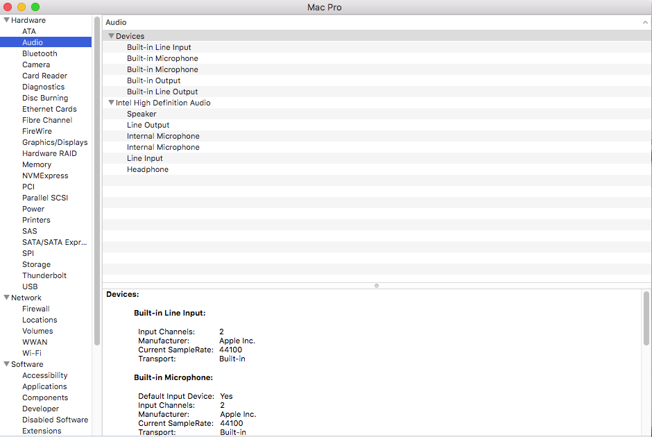

Hi Rockey, I have audio on the Z800 tower speaker and on the headphones! I looked on all the clover kexts folders and voodoo was on the other kexts folder. Once I got rid off it, audio is working natively.

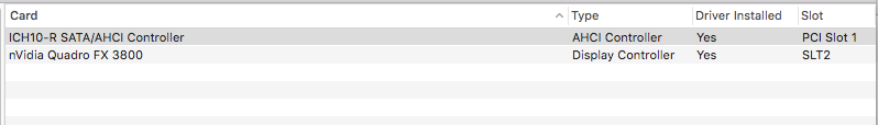

I now also have GPU showing as display controller with your last modified config.plist.
I cannot thank you enough. Absolutely amazing work.

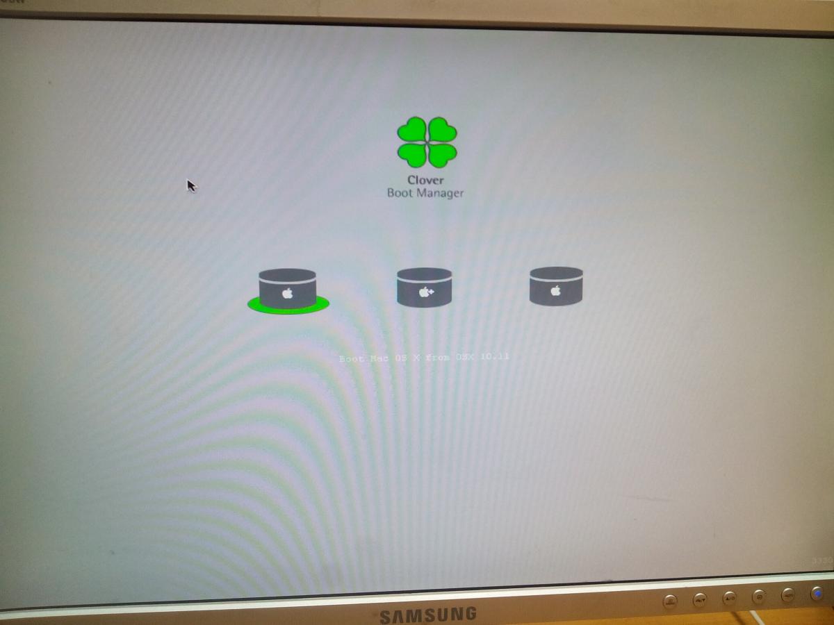

i use the tool Clover OS X El Capitan V7 by Chris111, i select Clover legacy 3320,  i create a DSDT from aida64 and complete with MaciASL.... Reboot with USB, first problem, ACPI panic, then i used a DSDT from other user with un Z400(My pc is Z600), BINGO... boot an begin installation. Reboot and init Clover, select the HD 10.11.4, and show the Message
"No kernel cache file"
"Cant find /mach_kernel"   :(
What happened, any user in equal case?, is possible fix or use other tool, or other BootLoader... in other disk i do have OSX 10.09, is posible that error is for second disk present?
