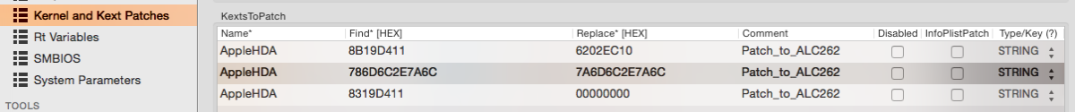

MacPeet Posted March 4, 2016 Share Posted March 4, 2016 @Rockey12 Here some testing for you and other users: Clover on the fly audio is the best method. No problems and no intervention for updates. Clover_Audio_on_the_fly_patch.zip The package includes: Original (Vanilla) AppleHDA for Capitan including layout28.zml.zlib and Platforms.zml.zlib realtekALC.kext for ConfigData instructions: 1. Install AppleHDA by S/L/E with SIP 0x67 2. Copy realtekALC.kext by EFI/Clover/kexts/10.11/ 3. Inject Clover's Kext to activate "Yes" 4. Add the following in a config.plist with CloverConfigurator: 5. rebuild cache (sudo kextcache -prelinked-kernel) 6. Reboot and have fun 2 Link to comment https://www.insanelymac.com/forum/topic/307064-hp-z400z600z800-workstations-os-x-1010x1011x-installation/page/5/#findComment-2220598 Share on other sites More sharing options...

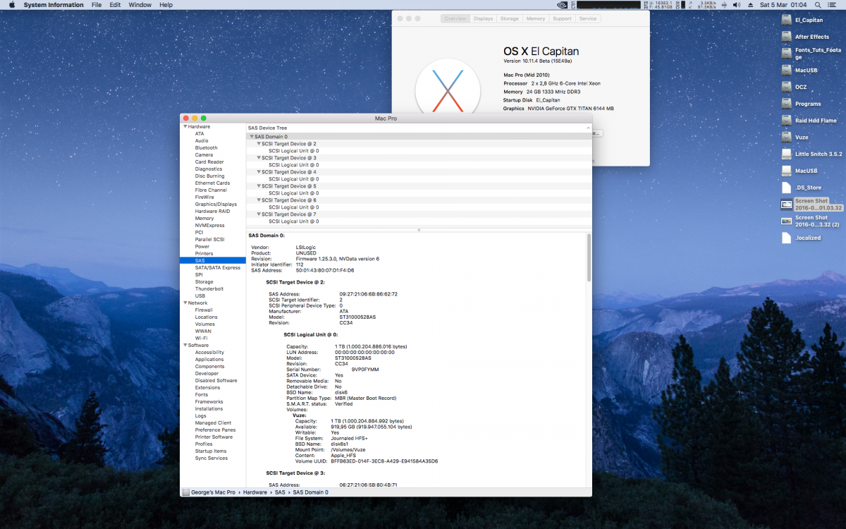

gkourk6522 Posted March 4, 2016 Share Posted March 4, 2016 Hi After a lot try to setup my z800 with el capitan 10.11.4 Beta (15E49a) finally almost done First I would like to thanks the forum and all the users that sharing information My setup procedure is: first using http://www.insanelymac.com/forum/topic/307920-guide-clover-dell-precision-690-workstation/?st=0 this clover setup to make the usb with 10.11.3 then Post Installer HP Z800 http://www.insanelymac.com/forum/topic/307920-guide-clover-dell-precision-690-workstation/page-12?do=findComment&comment=2220137 I boot without any bootflags in this step i have many freezes in finder then i update to 10.11.4 Beta (15E49a) and now all works normal and the sas controller many thanks to Chris 1111 and the Clover team the only problem are the audio and the memory banks i haven't audio but i didn't try to fix it and the memory i have 12 banks of 4gb =48gb ram and el capitan recognise 6 banks = 24gb i don't now if it is any configuration in clover thanks ps i don't know how to upload screenshots 1 Link to comment https://www.insanelymac.com/forum/topic/307064-hp-z400z600z800-workstations-os-x-1010x1011x-installation/page/5/#findComment-2220661 Share on other sites More sharing options...
gkourk6522 Posted March 4, 2016 Share Posted March 4, 2016 please don't forget to give the credit to Chris 1111 who made these wonderful Installer and the Clover team for the Execelant bootloader AppleHDA+CodecCommander+DSDT in post 135 AppleHDA+CodecCommander+DSDT is that for audio Link to comment https://www.insanelymac.com/forum/topic/307064-hp-z400z600z800-workstations-os-x-1010x1011x-installation/page/5/#findComment-2220678 Share on other sites More sharing options...
gkourk6522 Posted March 4, 2016 Share Posted March 4, 2016 audio works 1 Link to comment https://www.insanelymac.com/forum/topic/307064-hp-z400z600z800-workstations-os-x-1010x1011x-installation/page/5/#findComment-2220682 Share on other sites More sharing options...
gkourk6522 Posted March 4, 2016 Share Posted March 4, 2016 I will stay here for the next year 1 Link to comment https://www.insanelymac.com/forum/topic/307064-hp-z400z600z800-workstations-os-x-1010x1011x-installation/page/5/#findComment-2220688 Share on other sites More sharing options...
keksonja Posted March 4, 2016 Share Posted March 4, 2016 I am finally booted inside OS X now i have to do a post install..... THANKS! ROCKEY AND CHRIS!!! Gkoruk how did you make LSI work i have 2 LSI cards inside now with 2 raids and also another ATTO card... I did not disconnect anything it booted 2 Link to comment https://www.insanelymac.com/forum/topic/307064-hp-z400z600z800-workstations-os-x-1010x1011x-installation/page/5/#findComment-2220694 Share on other sites More sharing options...
gkourk6522 Posted March 4, 2016 Share Posted March 4, 2016 I am finally booted inside OS X now i have to do a post install..... THANKS! ROCKEY AND CHRIS!!! Gkoruk how did you make LSI work i have 2 LSI cards inside now with 2 raids and also another ATTO card... I did not disconnect anything it booted It works by default when i update to 10.11.4 beta Link to comment https://www.insanelymac.com/forum/topic/307064-hp-z400z600z800-workstations-os-x-1010x1011x-installation/page/5/#findComment-2220701 Share on other sites More sharing options...

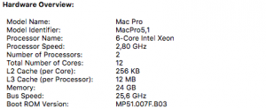

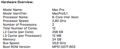

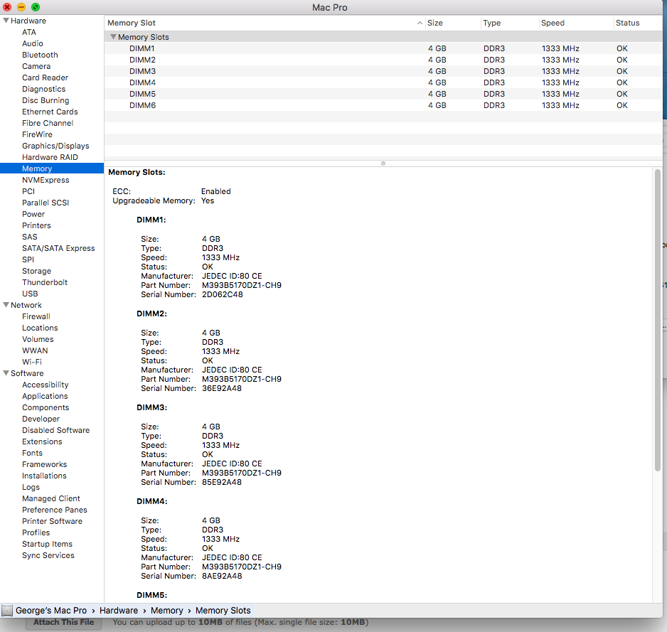

gkourk6522 Posted March 5, 2016 Share Posted March 5, 2016 Hi I have a problem with memory banks my system configuration has 12 banks of 4gb ram for 2 x cpu the problem is el capitan recognise the half memory (mavericks recognise all banks) can anyone help me to solve i think is inside clover configuration config.plist.zip thanks a lot Link to comment https://www.insanelymac.com/forum/topic/307064-hp-z400z600z800-workstations-os-x-1010x1011x-installation/page/5/#findComment-2220734 Share on other sites More sharing options...
gkourk6522 Posted March 5, 2016 Share Posted March 5, 2016 Try this Thanks A LOT It works Clover is the best Link to comment https://www.insanelymac.com/forum/topic/307064-hp-z400z600z800-workstations-os-x-1010x1011x-installation/page/5/#findComment-2220936 Share on other sites More sharing options...

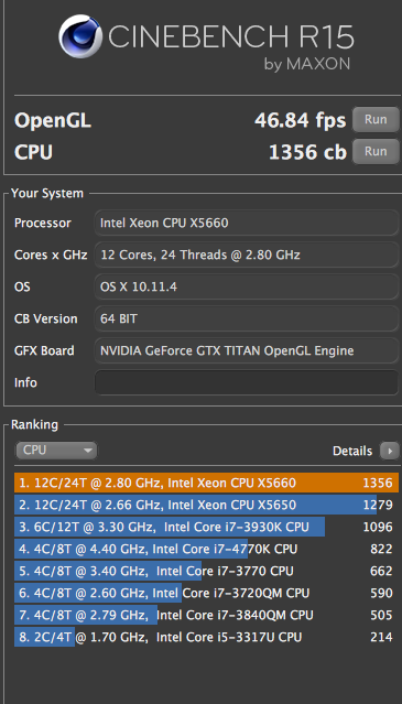

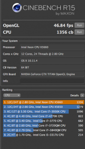

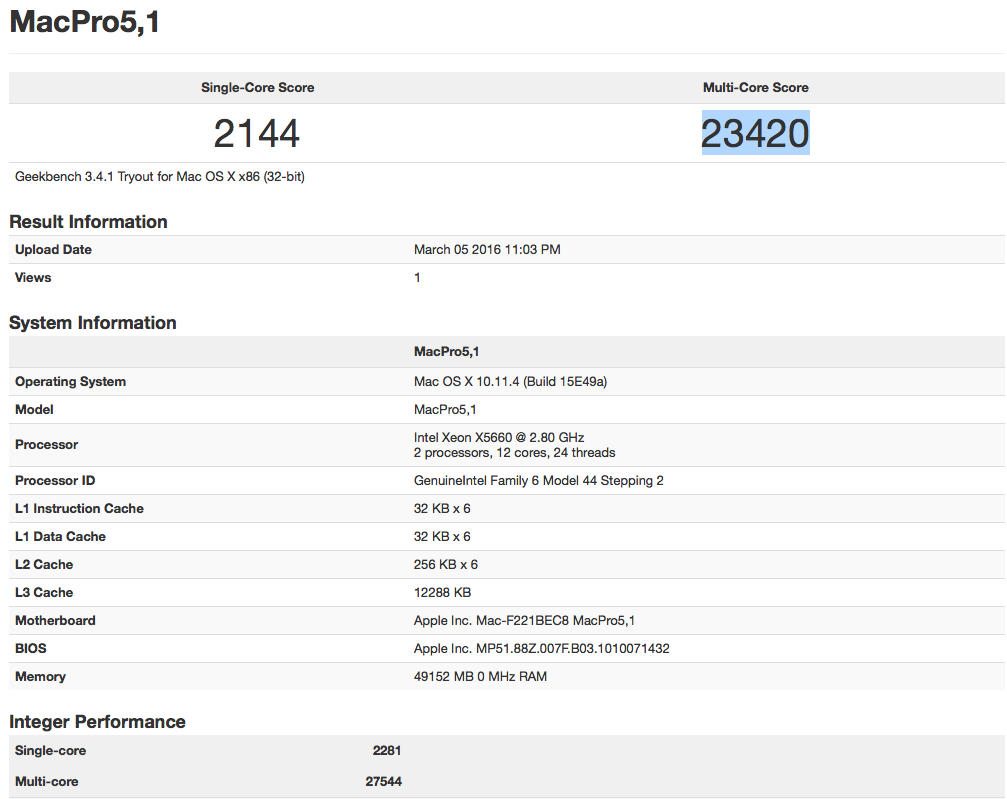

gkourk6522 Posted March 5, 2016 Share Posted March 5, 2016 Some performance 2 Link to comment https://www.insanelymac.com/forum/topic/307064-hp-z400z600z800-workstations-os-x-1010x1011x-installation/page/5/#findComment-2220943 Share on other sites More sharing options...

MacPeet Posted March 6, 2016 Share Posted March 6, 2016 Yes, the best method for Capitan is Clover. I wonder about the use of CodecComander. Your ALC262 has no EAPD. The Kext includes nothing for ALC262. The patched AppleHDA of Mavericks or Yosemite also work with Capitan. The best method is on the fly. Some fixes are not necessary because they are in DSDT it (AddDTGP, FixIPIC and more). Audio-Inject 28 with Clover is not necessary if HDEF is fixed in the DSDT. rootless is no longer necessary (it was only during the Capitan beta < GM. Was replaced by SIP.) PCIRootUID=0 is standard in Clover, I think Here's what to test: try.zip I have "HDA / hda-gfx" inserted for HDMI audio when non-native HDMI support (AMD and Nvidia): HDMIAudio.kext.zip to EFI/Clover/kexts/10.11/ Here what for cosmetics: Folder icon z800 for your desktop to store important data for the love HP: z800_folder.zip ... z600_folder.zip z400_folder.zip For About This Mac: SystemLogo.tiff.zip ... z600_SystemLogo.tiff.zip z400_SystemLogo.tiff.zip copy to /Applications/Utilities/System Information.app/Contents/Resources/ For About This Mac, Change the black Monitor: public.generic-lcd.icns.zip copy to /System/Library/CoreServices/CoreTypes/Contents/Resources/public.generic-lcd.icns For About This Mac, Memory: insert, add or replace your free text at MAC_MEMORY_TEXT at /Applications/Utilities/System Information.app/Contents/Resources/German.lproj/SPInfo.strings or /Applications/Utilities/System Information.app/Contents/Resources/English.lproj/SPInfo.strings or ... have fun 2 Link to comment https://www.insanelymac.com/forum/topic/307064-hp-z400z600z800-workstations-os-x-1010x1011x-installation/page/5/#findComment-2220991 Share on other sites More sharing options...
