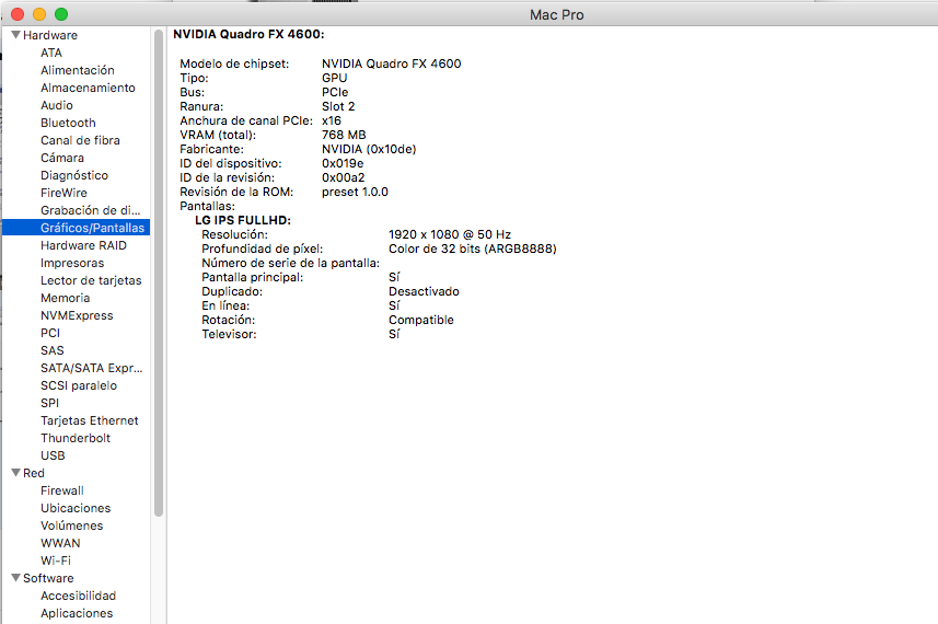

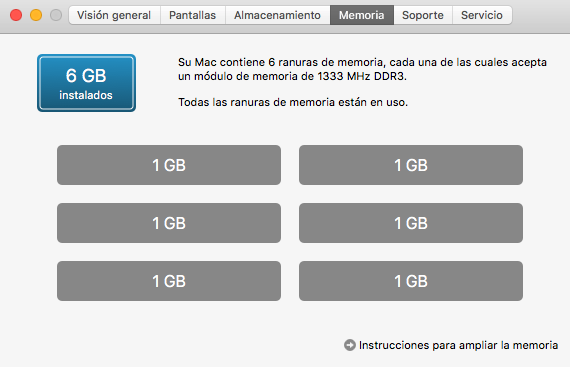

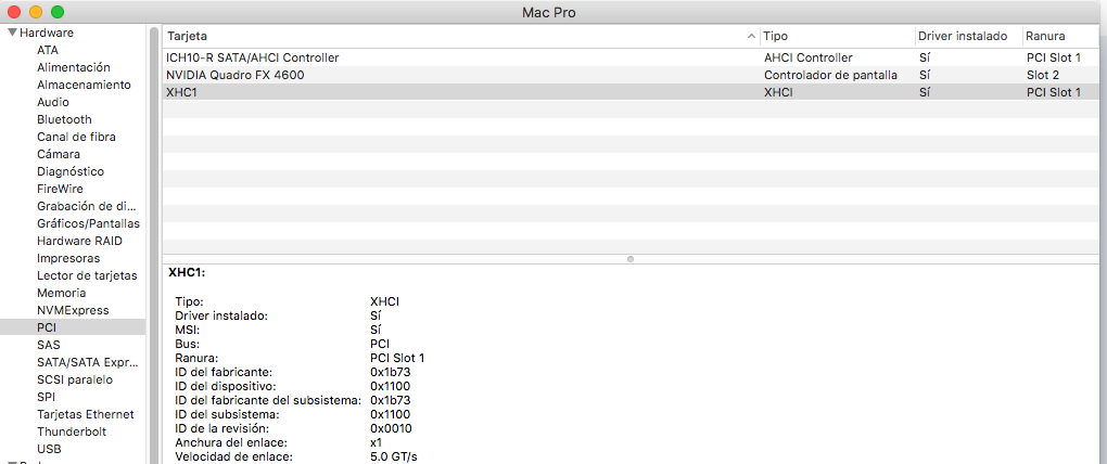

atrapero Posted May 5, 2016 Share Posted May 5, 2016 Hello! Another who has managed to install El Capitan in the HP Z600 thanks to the Chris1111 Installer and this great thread. Many thanks to Chris1111. I have the problem of RAM which only recognized half of the 6gb. and the graphics card that was on network devices. All managed it following the steps of Rockey12. Now I have two problems. First, the firewire build in don´t recognize. Second, the graphics card, an nvidia quadro fx 4600, don´t let me use the nvidia driver. I can choose to use the nvidia driver, but when i restart, the system again using the OS X default driver and i install cuda but don´t work. What can I do? Sorry my english 2 Link to comment https://www.insanelymac.com/forum/topic/307064-hp-z400z600z800-workstations-os-x-1010x1011x-installation/page/10/#findComment-2236285 Share on other sites More sharing options...
atrapero Posted May 5, 2016 Share Posted May 5, 2016 This is what i say: What can i do to solve this? Link to comment https://www.insanelymac.com/forum/topic/307064-hp-z400z600z800-workstations-os-x-1010x1011x-installation/page/10/#findComment-2236300 Share on other sites More sharing options...
atrapero Posted May 5, 2016 Share Posted May 5, 2016 I can´t attach files Link to comment https://www.insanelymac.com/forum/topic/307064-hp-z400z600z800-workstations-os-x-1010x1011x-installation/page/10/#findComment-2236302 Share on other sites More sharing options...
