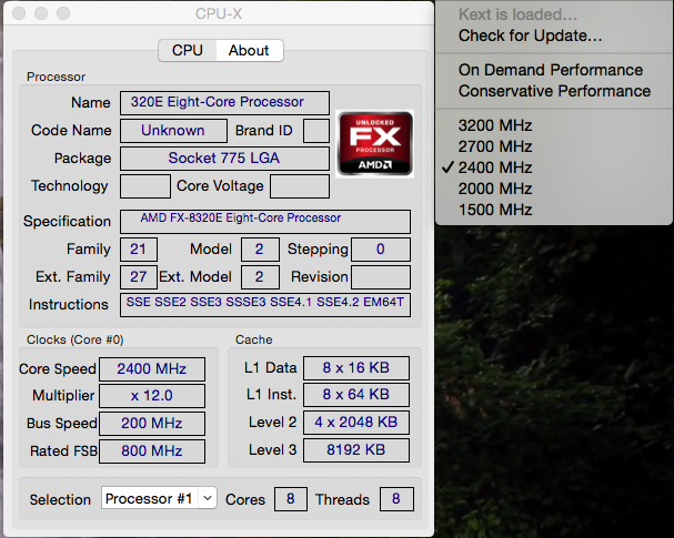

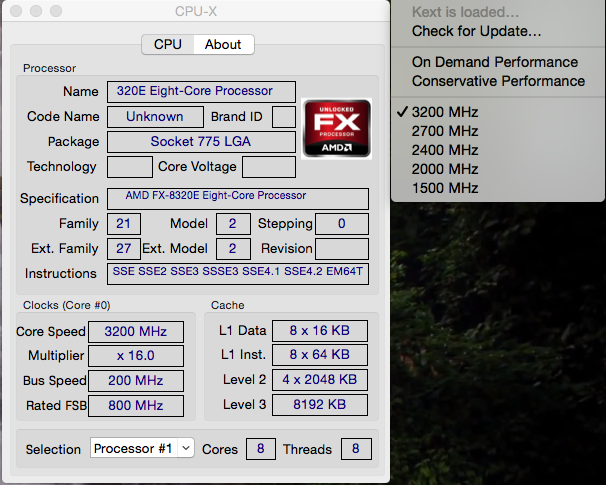

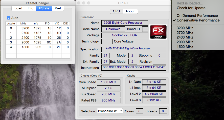

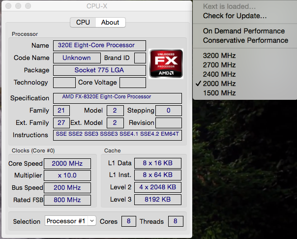

gils83 Posted September 6, 2015 Share Posted September 6, 2015 glis83 Hi! I've tried to use voodoopstate.kext and no success, maybe you could make some video, where you can show what did you do, to make it work? It would be nice if you do that, and if you upload voodopstate.kext, because I think I could use wrong one and of course if you have a free time to do all this. I'm sure that I doing something wrong. I've read, that for make it work there should be removed some other power management kexts but which one? That's the question. And I read something about AppleHPET.kext, should it be removed or something? And then again, if it will not work, then it's ok, I actually don't need power management, everything is working fine without it, like I said earlier, I don't have much time for experiments. That't the problem: the frequency is false but works very good woh !! the win10 is very fast on Parallels 10 /Yosemite look the video :http://www.sendbox.fr/a64e23a4f9078d33/dossier_sans_titre.zip VoodooPState.kext.zip 1 Link to comment https://www.insanelymac.com/forum/topic/302075-amd-yosemite-kernel-testing-for-help-use-the-help-topic/page/60/#findComment-2165912 Share on other sites More sharing options...
J0hny Posted September 6, 2015 Share Posted September 6, 2015 (edited) Thank you very much! I'll try this kext, and report here! And I will watch your video soon! upd. Yes it's working, but like you said with false frequency. But the result is much better, cpu frequency is closer to real one. And still i feel that performance reducing with that driver little bit. Again thanks for that driver! upd2. Nice video! What did you do, to make parallels work on amd? On my mac I have only two crashing apps: parallels/vbox, like in everyone else I think... Which version of parallels did you used? Edited September 7, 2015 by ImmortalSoulL Link to comment https://www.insanelymac.com/forum/topic/302075-amd-yosemite-kernel-testing-for-help-use-the-help-topic/page/60/#findComment-2165913 Share on other sites More sharing options...

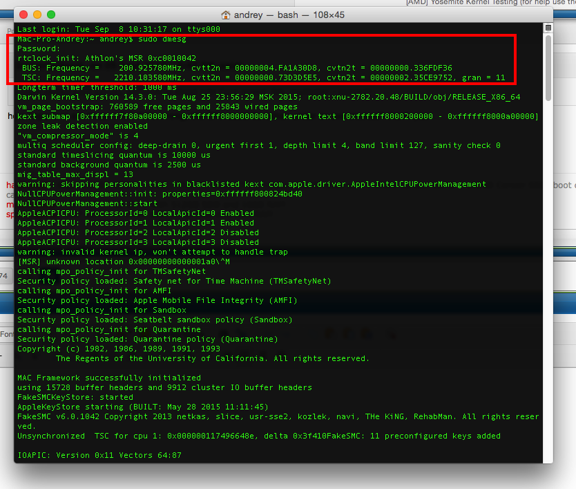

lpukraine Posted September 8, 2015 Share Posted September 8, 2015 how important are these info? if it's wrong, the CPU could be either under or overclocked? thank you Think that you asked about that: Link to comment https://www.insanelymac.com/forum/topic/302075-amd-yosemite-kernel-testing-for-help-use-the-help-topic/page/60/#findComment-2166253 Share on other sites More sharing options...
Bronya Posted September 8, 2015 Share Posted September 8, 2015 Think that you asked about that: Снимок экрана 2015-09-08 в 10.34.21.png hi , in picture i see " invalid kernel ip ... and msr - unknown location ... this no good . need fix this . thank for picture ))) 1 Link to comment https://www.insanelymac.com/forum/topic/302075-amd-yosemite-kernel-testing-for-help-use-the-help-topic/page/60/#findComment-2166299 Share on other sites More sharing options...
lpukraine Posted September 8, 2015 Share Posted September 8, 2015 hi , in picture i see " invalid kernel ip ... and msr - unknown location ... this no good . need fix this . thank for picture ))) Not at all. Thanks, Bronya! Kernel works very well, even with these errors. But will wait for fix) Link to comment https://www.insanelymac.com/forum/topic/302075-amd-yosemite-kernel-testing-for-help-use-the-help-topic/page/60/#findComment-2166301 Share on other sites More sharing options...

gils83 Posted September 8, 2015 Share Posted September 8, 2015 (edited) works good for me with voodooPstate and kernel Bronya 14.3 vidéo encode m2ts 10 GO "Lucy" Handbrake H265 HEVC .mp4 = 1,88 go full HD I prepare you a video capture 60 fps 12 Mbit / s 1080p SF 4.5 to show you the image quality, the sound is perfectly synchronized, the kernel Bronya really works very well. http://www.sendbox.fr/435db605278ebed8/fichier_brut_2.zip Edited September 9, 2015 by gils83 1 Link to comment https://www.insanelymac.com/forum/topic/302075-amd-yosemite-kernel-testing-for-help-use-the-help-topic/page/60/#findComment-2166361 Share on other sites More sharing options...

gils83 Posted September 9, 2015 Share Posted September 9, 2015 look my speed native CPU is true (8320E) but o/c is false but works good 1 Link to comment https://www.insanelymac.com/forum/topic/302075-amd-yosemite-kernel-testing-for-help-use-the-help-topic/page/60/#findComment-2166536 Share on other sites More sharing options...
francescophp Posted September 9, 2015 Share Posted September 9, 2015 in relation to the VoodooPState.kext .... I think that the problems be solved by booting with the SSDT.aml. According to instructions on the rampagedev website, rampagedev describes how you can generate a SSDT.aml. there are the P-state and C-state values determined and generated in the SSDT, ( how-to create a SSDT ) or I understand something wrong? Spakk, that applies to Intel CPUs only, not to AMD. Tried, nothing change! look my speed native CPU is true (8320E) but o/c is false but works good Hi! Can you post your VoodooPState.kext? Another user told to use a different version, but version 1.0.3 doesn't work Link to comment https://www.insanelymac.com/forum/topic/302075-amd-yosemite-kernel-testing-for-help-use-the-help-topic/page/60/#findComment-2166543 Share on other sites More sharing options...
gils83 Posted September 9, 2015 Share Posted September 9, 2015 Tried, nothing change! Hi! Can you post your VoodooPState.kext? Another user told to use a different version, but version 1.0.3 doesn't work vpste.zip 2 Link to comment https://www.insanelymac.com/forum/topic/302075-amd-yosemite-kernel-testing-for-help-use-the-help-topic/page/60/#findComment-2166553 Share on other sites More sharing options...
