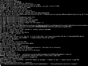

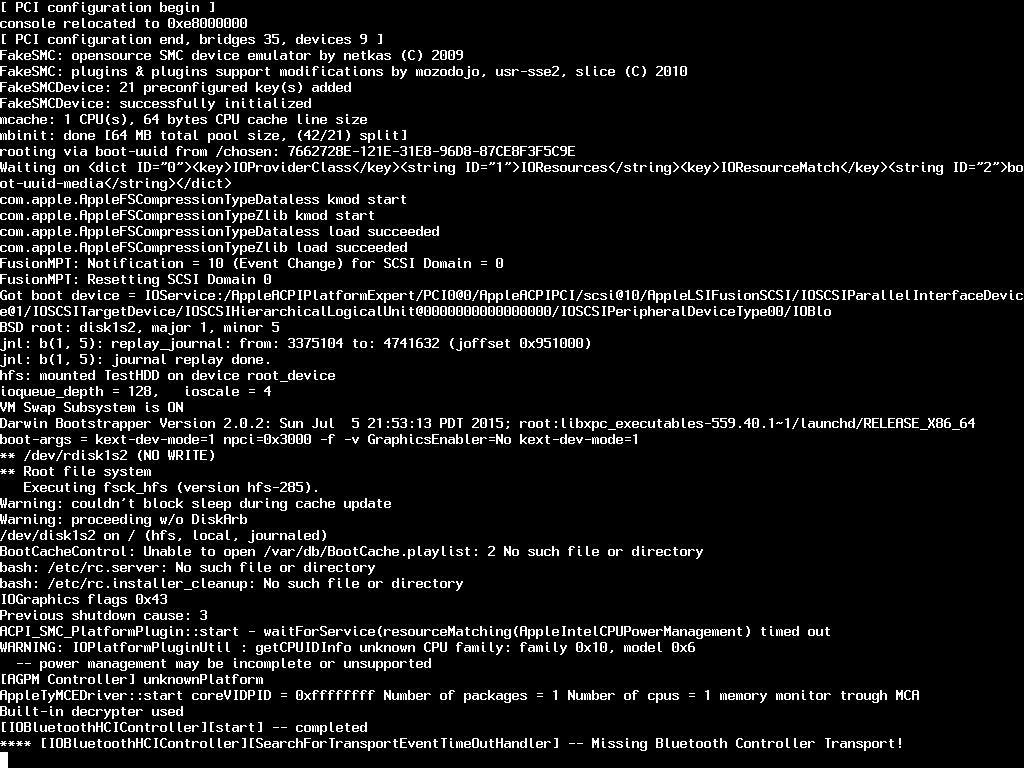

Shaneee Posted August 30, 2015 Share Posted August 30, 2015 Facing same issue trying to boot system with VMWare. I'm trying to isolate the kexts that cause the issue unless its kernel related Edit: Out of curiosity can someone on an Intel rig try booting 10.10.5 with Bronya's latest kernel? 1 Link to comment https://www.insanelymac.com/forum/topic/302075-amd-yosemite-kernel-testing-for-help-use-the-help-topic/page/58/#findComment-2164539 Share on other sites More sharing options...
y2k4u Posted August 31, 2015 Share Posted August 31, 2015 Facing same issue trying to boot system with VMWare. I'm trying to isolate the kexts that cause the issue unless its kernel related Edit: Out of curiosity can someone on an Intel rig try booting 10.10.5 with Bronya's latest kernel? Same issues with my AMD patched kernel & Bronya on Intel running 10.10.5. Test data suggest that the problems are outside of the kernel. It seems that Apple has found ways to invalidate binary signing on 10.10.5 system running AMD patched kernel. 1 Link to comment https://www.insanelymac.com/forum/topic/302075-amd-yosemite-kernel-testing-for-help-use-the-help-topic/page/58/#findComment-2164573 Share on other sites More sharing options...

pico joe Posted September 1, 2015 Share Posted September 1, 2015 Hey Guys ... long time no see . .. FYI today I did update combo 10.10.5 unfortunately I can't reach to desktop just stuck likes shanee post in http://www.insanelymac.com/forum/topic/302075-amd-yosemite-kernel-testing-for-help-use-the-help-topic/page-74?do=findComment&comment=2164539.. tried with bronya kernel 10.10.3 rc2, y2k4u 10.10.3r2 with combination Pthread kexts or not, boot with chameleon and clover still get that stuck .. .... Link to comment https://www.insanelymac.com/forum/topic/302075-amd-yosemite-kernel-testing-for-help-use-the-help-topic/page/58/#findComment-2164907 Share on other sites More sharing options...

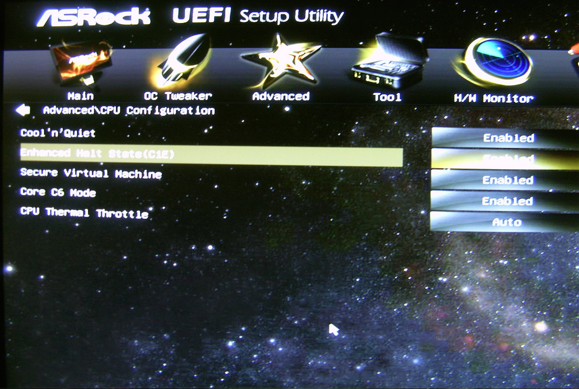

Bronya Posted September 1, 2015 Share Posted September 1, 2015 No, safari is not crashing, it's working well! Just this sound delay when watching videos in youtube - that's all! And i've tested again bronya rc7, and the problem back. So I switched to y2k4u kernel, with that kernel no youtube problem, as with 8N kernel.Hi! You tried my bootloader with c1e ? Link to comment https://www.insanelymac.com/forum/topic/302075-amd-yosemite-kernel-testing-for-help-use-the-help-topic/page/58/#findComment-2164941 Share on other sites More sharing options...

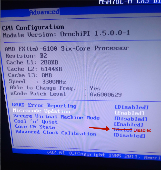

J0hny Posted September 1, 2015 Share Posted September 1, 2015 (edited) Not yet, but I will try, when I get home... And still, I need Colover Bootloader. update: I think I just figure out why it was happening, since I don't have "C1E Support/Enhanced Halt" option in my bios, i have switched "Core C6 State" from auto to disabled. And then that sound delay on youtube was gone. Thank you Bronya for getting me to right direction!) My CPU Config menu in bios: Edited September 1, 2015 by ImmortalSoulL 1 Link to comment https://www.insanelymac.com/forum/topic/302075-amd-yosemite-kernel-testing-for-help-use-the-help-topic/page/58/#findComment-2164951 Share on other sites More sharing options...
gils83 Posted September 1, 2015 Share Posted September 1, 2015 Not yet, but I will try, when I get home... And still, I need Colover Bootloader. update: I think I just figure out why it was happening, since I don't have "C1E Support/Enhanced Halt" option in my bios, i have switched "Core C6 State" from auto to disabled. And then that sound delay on youtube was gone. Thank you Bronya for getting me to right direction!) My CPU Config menu in bios: no , C6State enable HPET is enable ? Link to comment https://www.insanelymac.com/forum/topic/302075-amd-yosemite-kernel-testing-for-help-use-the-help-topic/page/58/#findComment-2165014 Share on other sites More sharing options...
Bronya Posted September 1, 2015 Share Posted September 1, 2015 Yes , but try boot_c1e and answer here )) 1 Link to comment https://www.insanelymac.com/forum/topic/302075-amd-yosemite-kernel-testing-for-help-use-the-help-topic/page/58/#findComment-2165019 Share on other sites More sharing options...

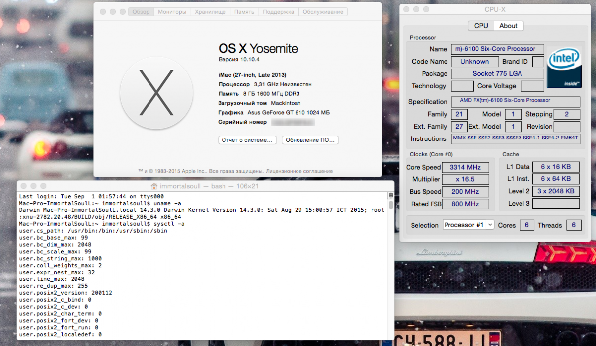

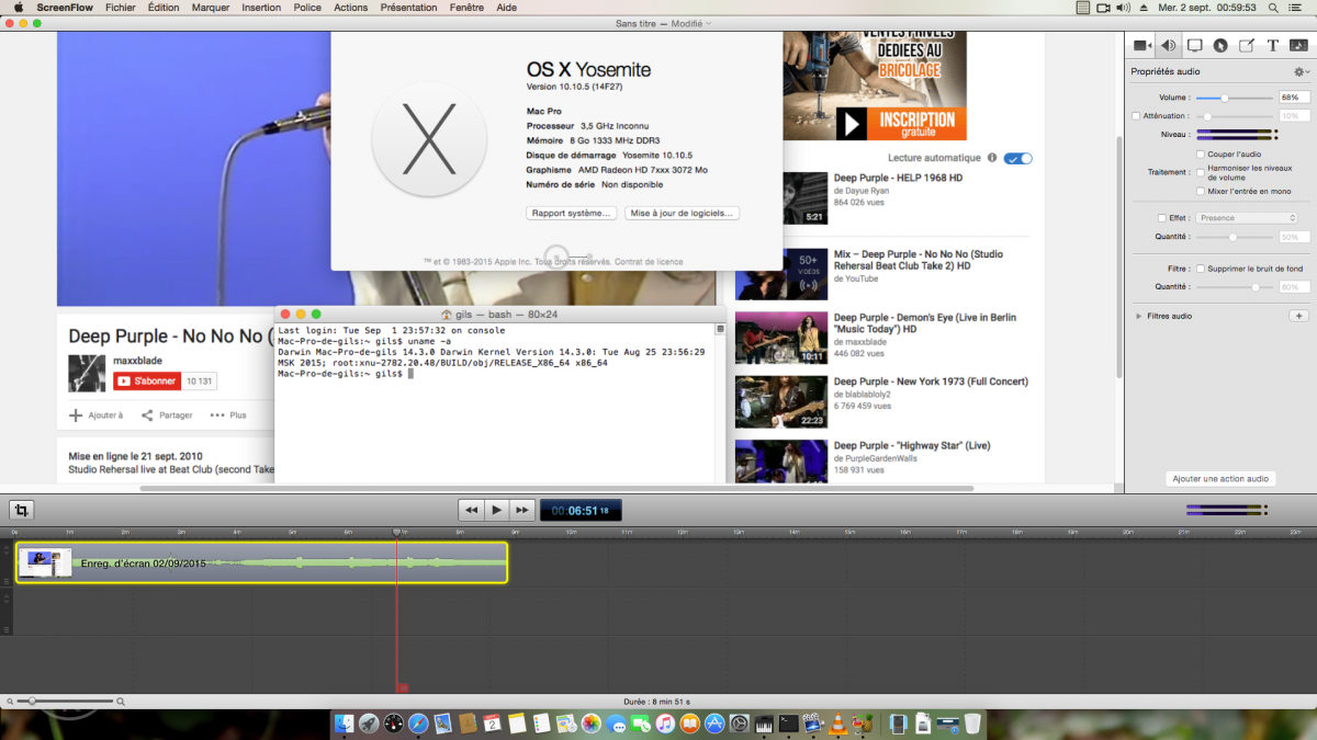

gils83 Posted September 1, 2015 Share Posted September 1, 2015 look and listen small video , no problem synchro audio/video http://www.sendbox.fr/15685a2ed5dc7531/Archive.zip cool n'Quiet = enable C1E = enable C6State = enable and use voodooPstate + PstateMenu works good 10.10.5 with kernel Bronya 14.3 and flag : fsb=200 Mhz so after a long pause, without a runnable hackintosh and without my real Mac, I rise with the new kernel based on recent kernel. Please test if everything works. no works spakk idem ps : no change iokit Link to comment https://www.insanelymac.com/forum/topic/302075-amd-yosemite-kernel-testing-for-help-use-the-help-topic/page/58/#findComment-2165025 Share on other sites More sharing options...
