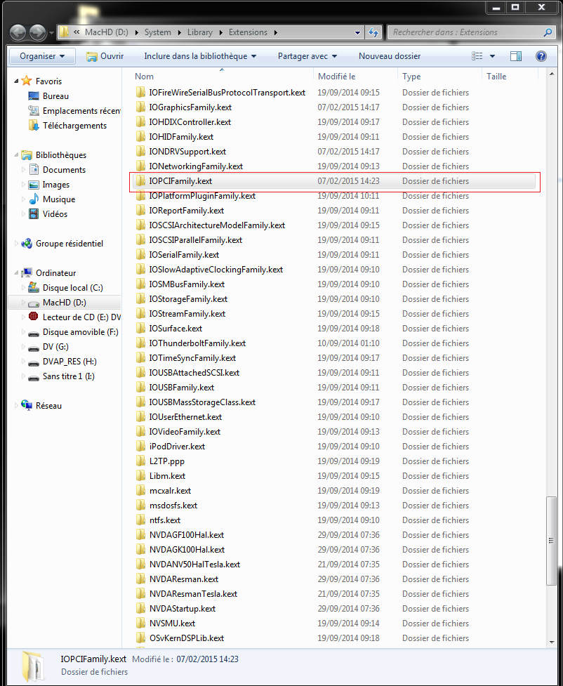

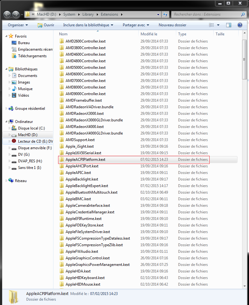

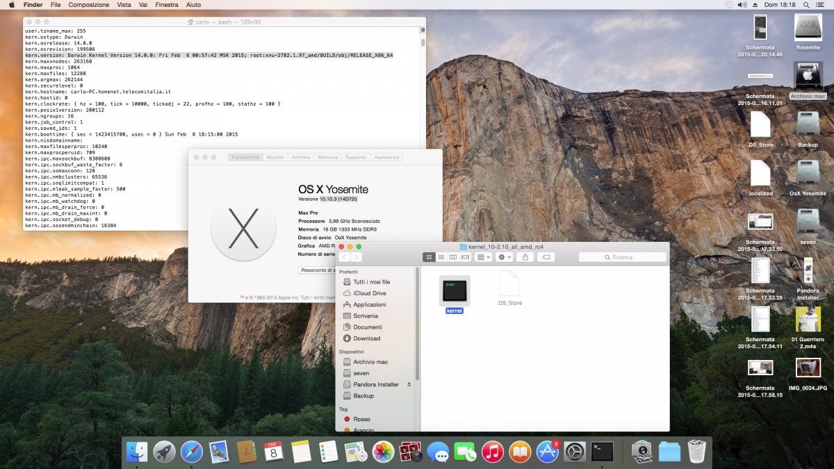

invalid opcode 64  (kabini)  :)
(10.10.1 - 10.10.2)
copy and paste content Extensions 10.10.1 inside extensions
10.10.2 with kext wizard put the kext replace
10.10.2  -  10.10.3
copy and paste content Extensions 10.10.2 inside extensions
10.10.3 with kext wizard put the kext replace

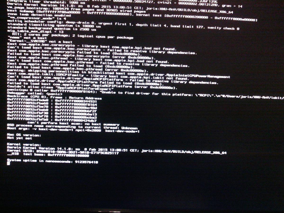

replace iopci and acpip but no boot ( KP or invalide opcode 64 )   :worried_anim:

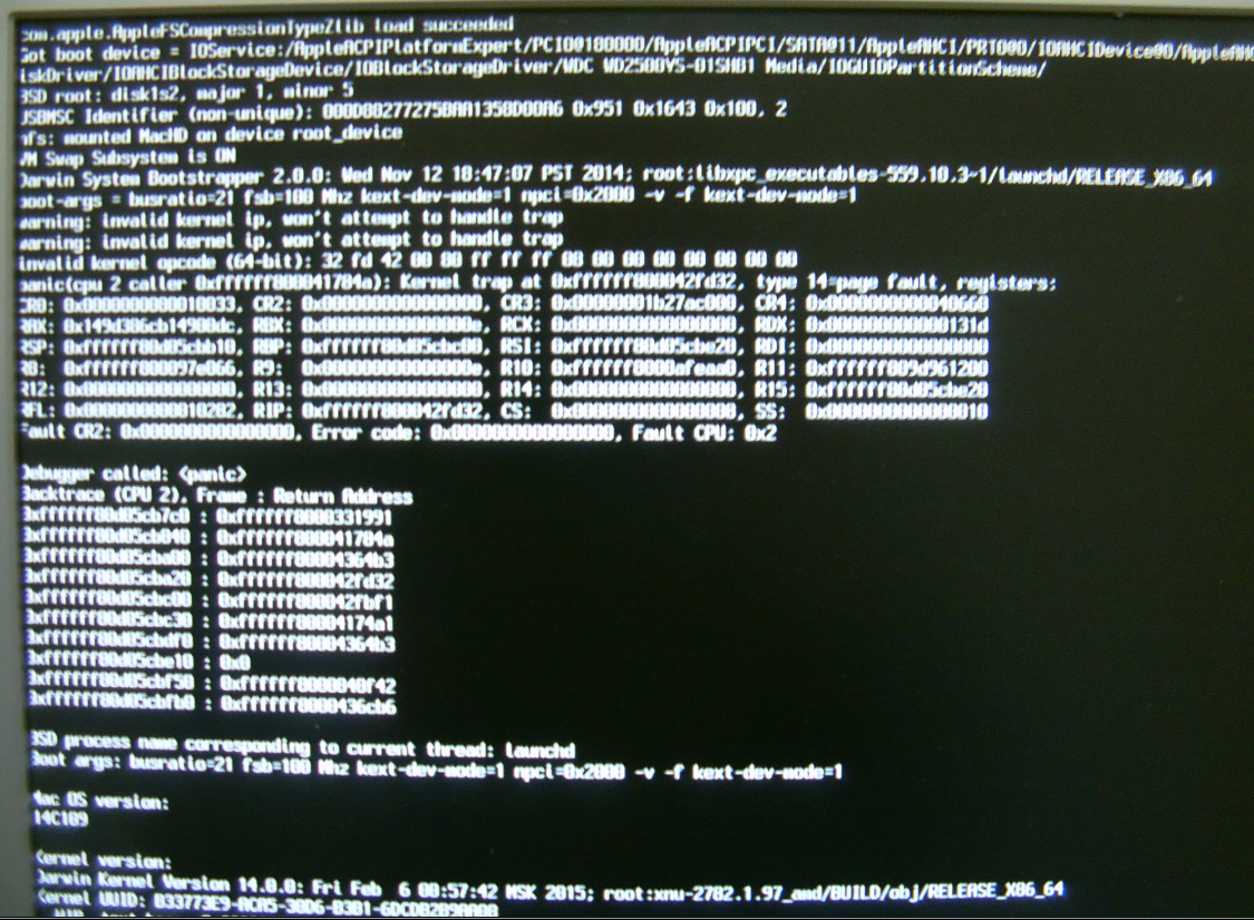

invalid kernel opcode Analysis 10.10.2 v2
invalid kernel opcode (64-bit): 44 0F B6 1F
this x86 opcode 0F B6 movzx
Add REX Prefix to 64-bit Opcode
44 0F B6 1F
movzx r11d, byte [ds:rdi]
mod 0 r/m 7 digit 3
0x44 = REX Prefix
0xB6 = opcode
0x1F =  modrm
dst 32-bit r11d reg <— src 64bit reg get ptr rdi 1-byte (movzx Convert to 32bit zero-extension)
example:
if  PTR RDI = 0x0000000000001234
addr 0x0000000000001234 Value = 0x05 0x06 0x07 0x08
get ptr 0x0000000000001234 byte 0x05
Convert to 32bit zero-extension = 0x00000005
src 0x00000005 move to r11d Register
My K10 Athlon seem Not support this Opcode
REX Mode
mod 3 mode
40 0F B6 C0
movzx      eax, al
41 0F B6 C0
movzx      eax, r8b
44 0F B6 C0
movzx      r8d, al
45 0F B6 C0
movzx      r8d, r8b
May be required add new register r8d-r15d
10.10.2 xnu version number is xnu-2782.10.72

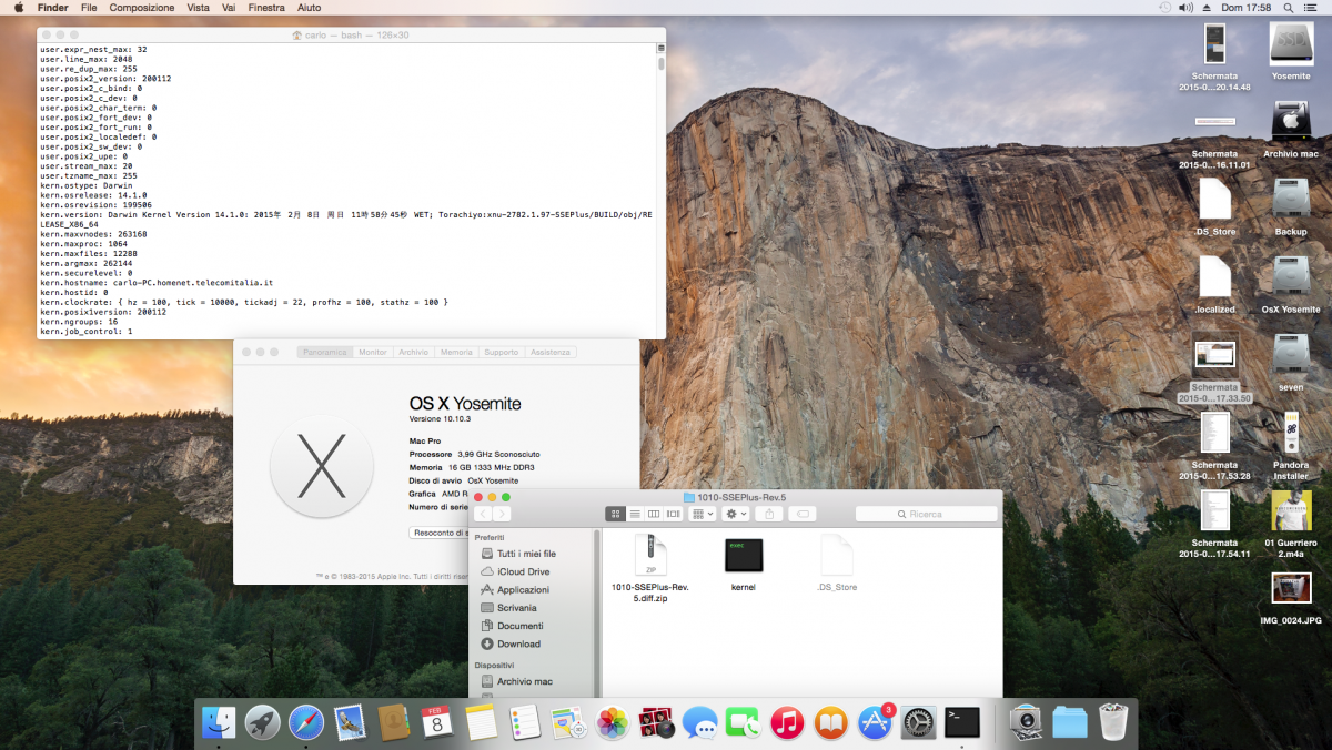

Hello Tora Chi Yo !
Many thanx for your work, 1010-SSEPlus-Rev.6 works very well on my old Athlon 64 x2 3800+ !
AppStore, iCloud, Safari, Flash, are all OK on 10.10.1 with AMD Replacement kexts :thumbsup_anim:
Tried 10.10.2 update but stuck at invalid kernel opcode so I'll wait for a fix before retry :D
But I'm confident ! :thumbsup_anim:  You guys made a wonderful job so far !!!
44 0F B6 1F
mod 0 r/m 7 digit 3
0x44 = REX Prefix
0xB6 = opcode
0x1F =  modrm
example:
REX Mode
mod 3 mode
40 0F B6 C0
movzx      eax, al
41 0F B6 C0
movzx      eax, r8b
44 0F B6 C0
movzx      r8d, al
45 0F B6 C0
movzx      r8d, r8b
