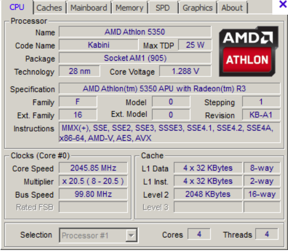

Meowthra Posted February 17, 2015 Share Posted February 17, 2015 You really not realized ! If no support L3 , then auto enable emulation L3 !!!! You realized ???? Or you want speak that i don't understand ??? rc3 cpuid /* Emulate virtual cache Start */ /* Bronzovka: Emulate virtual cache size */ if(cache_size == 0) { //no L3 - emulate enable size =) info_p->cache_size[L1I] = 65536; info_p->cache_size[L1D] = 16384; info_p->cache_size[L2U] = 2097152; info_p->cache_size[L2U] = 8388608; info_p->cache_sharing[L1I] = cores; info_p->cache_sharing[L1D] = cores; info_p->cache_sharing[L2U] = cores; info_p->cache_sharing[L3U] = cores; info_p->cache_partitions[L1I] = 1; info_p->cache_partitions[L1D] = 1; info_p->cache_partitions[L2U] = 1; info_p->cache_partitions[L3U] = 1; info_p->cache_linesize = 64; linesizes[L1I] = info_p->cache_linesize; linesizes[L1D] = info_p->cache_linesize; linesizes[L2U] = info_p->cache_linesize; linesizes[L3U] = info_p->cache_linesize; info_p->cache_size[L2U] = 8388608 8388608 = 8MB windows cpu-z Sorry I do not know to add L3 8MB Cache Athlon Can to Become FX 2 Link to comment https://www.insanelymac.com/forum/topic/302075-amd-yosemite-kernel-testing-for-help-use-the-help-topic/page/37/#findComment-2112538 Share on other sites More sharing options...
Bronya Posted February 17, 2015 Share Posted February 17, 2015 rc3 cpuid info_p->cache_size[L2U] = 8388608 8388608 = 8MB windows cpu-z Sorry I do not know to add L3 8MB Cache Athlon Can to Become FX Yes , info_p->cache_size[L2U] = 8388608 - this emulation !!! I added this for normal work . If i no added this emulation - this slow work . Because system 10.9.x need in use L3 cache . If you are not want to use emulation, i can delete the emulation . Sorry ! I found error in cupid rc3 . Need replace info_p->cache_size[L2U] to info_p->cache_size[L3U] . Then info_p->cache_size[L3U] = 8388608 )))))) This emulation for VMware and parallel desktop , because if vmware don't support amd , then need enable emulation L1,2,3 . )) Link to comment https://www.insanelymac.com/forum/topic/302075-amd-yosemite-kernel-testing-for-help-use-the-help-topic/page/37/#findComment-2112548 Share on other sites More sharing options...

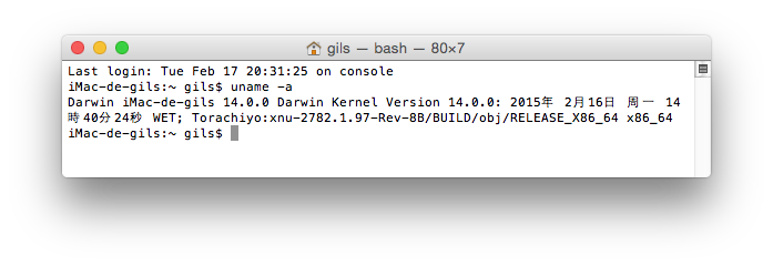

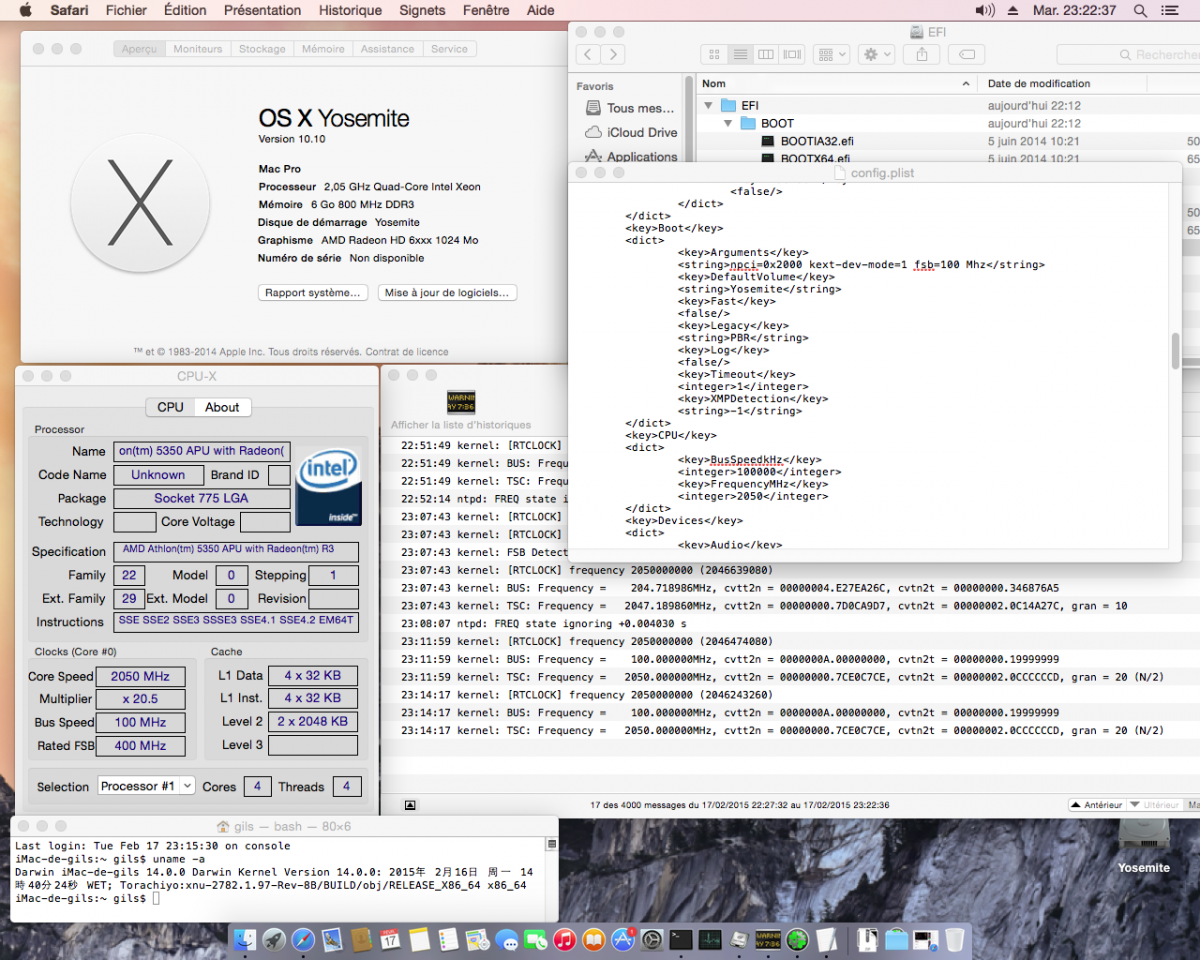

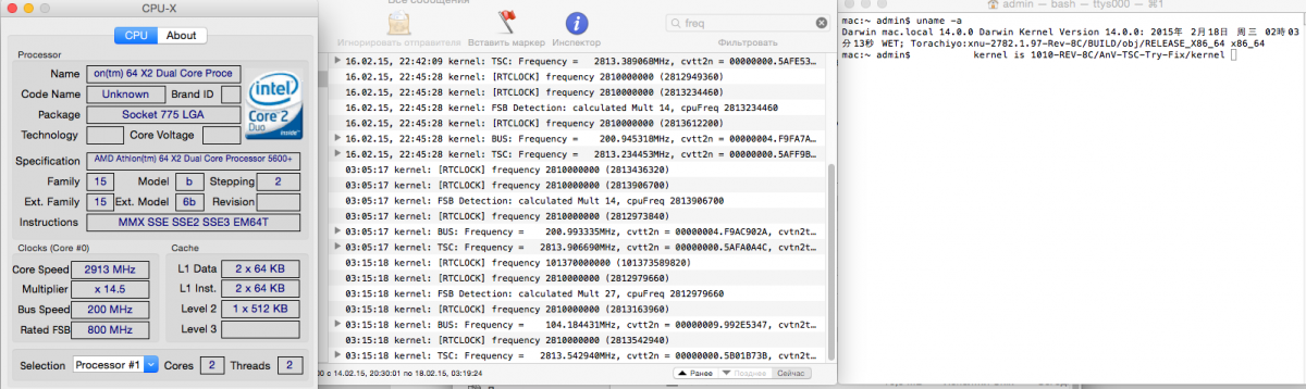

yakei Posted February 17, 2015 Share Posted February 17, 2015 Try FiX TSC V1 RealFreq Feedback TEST CPU frequency & Audio Cutoff Problems results 1010-REV-8C test result from 1010 Rev 8C function ok. Can no changes to 1010_Rev 8B determine Torachiyo:xnu-2782.1.97-REV-8C/BUILD/obj/RELEASE_X86_64 x86_64 Link to comment https://www.insanelymac.com/forum/topic/302075-amd-yosemite-kernel-testing-for-help-use-the-help-topic/page/37/#findComment-2112631 Share on other sites More sharing options...

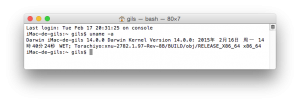

gils83 Posted February 17, 2015 Share Posted February 17, 2015 test result from 1010 Rev 8C function ok. Can no changes to 1010_Rev 8B determine DSC04925.JPG Torachiyo:xnu-2782.1.97-REV-8C/BUILD/obj/RELEASE_X86_64 x86_64 Link to comment https://www.insanelymac.com/forum/topic/302075-amd-yosemite-kernel-testing-for-help-use-the-help-topic/page/37/#findComment-2112637 Share on other sites More sharing options...

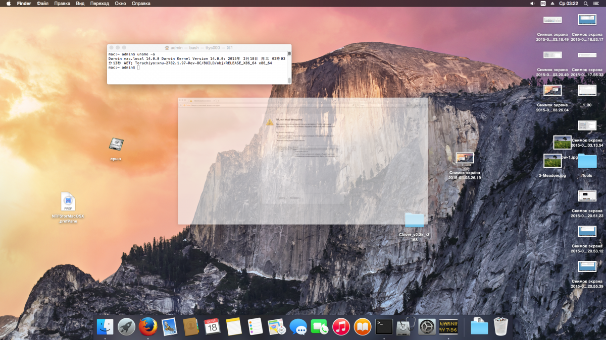

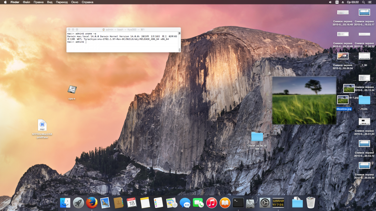

kyh3im Posted February 18, 2015 Share Posted February 18, 2015 Try FiX TSC V1 RealFreq V2 AnV-TSC-Try-Fix Feedback TEST CPU frequency & Audio Cutoff Problems results Could those glitches be because i don't have l3 cache? I haven't opened anything webkit related and i still have them. I pressed a spacebar on my desktop to open a picture and another pic is just how firefox started after it crashed. Link to comment https://www.insanelymac.com/forum/topic/302075-amd-yosemite-kernel-testing-for-help-use-the-help-topic/page/37/#findComment-2112658 Share on other sites More sharing options...

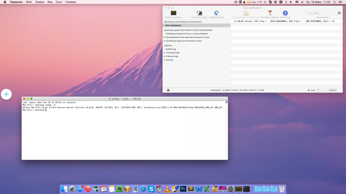

lpukraine Posted February 18, 2015 Share Posted February 18, 2015 Try to Fix TSC for Intel Pentium & Cpuid L3 Cache open /Applications/Utilities/Console.app Search for string : CPU Freq TEST CPU Frequency & L3 Cache Working well with my CPU. 1 Link to comment https://www.insanelymac.com/forum/topic/302075-amd-yosemite-kernel-testing-for-help-use-the-help-topic/page/37/#findComment-2112699 Share on other sites More sharing options...
tragediana150 Posted February 18, 2015 Share Posted February 18, 2015 Could those glitches be because i don't have l3 cache? I haven't opened anything webkit related and i still have them. I pressed a spacebar on my desktop to open a picture and another pic is just how firefox started after it crashed. This is TSC error. Tora Chi Yo has right. I had these problems with Mountain Lion and Mavericks when I was working on Athlon X2. TSC Fix should resolve the problem Link to comment https://www.insanelymac.com/forum/topic/302075-amd-yosemite-kernel-testing-for-help-use-the-help-topic/page/37/#findComment-2112766 Share on other sites More sharing options...

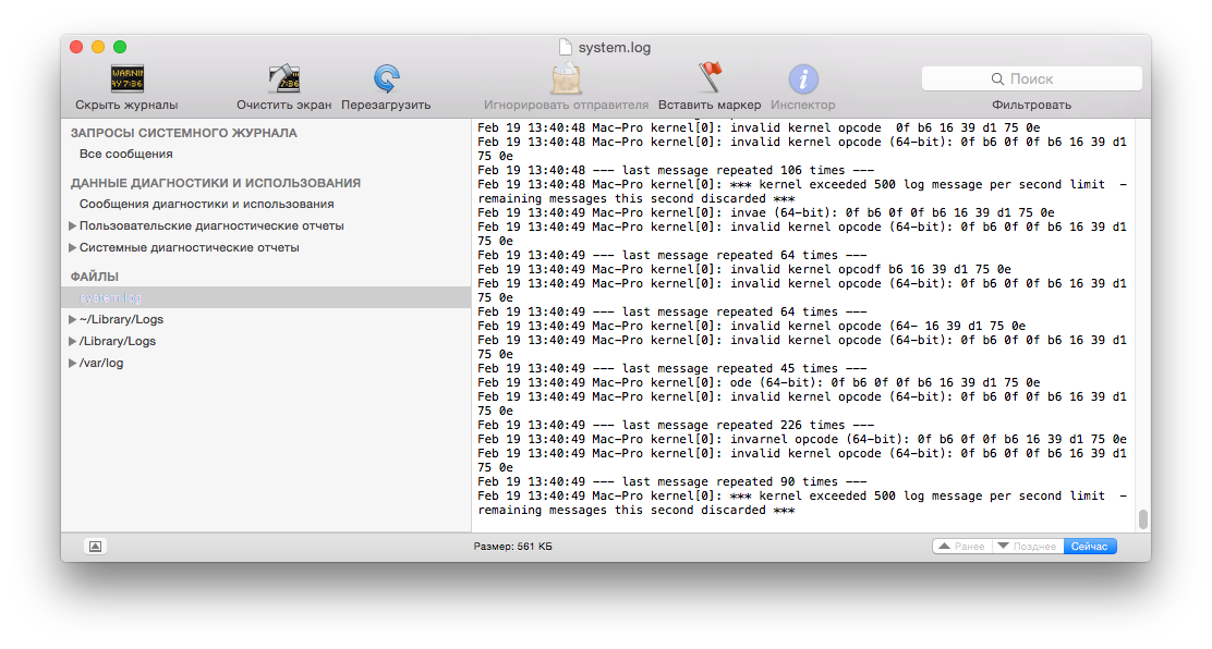

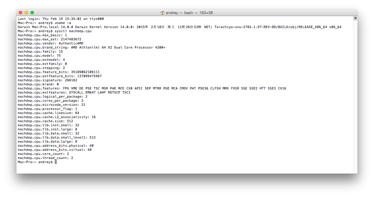

lpukraine Posted February 19, 2015 Share Posted February 19, 2015 Add AMD64 Socket 754 Processor Support but The new version Chameleon Don't seem to support some older motherboards My 754 motherboard Unable to start Chameleon So Unable TEST 754 CPU If AMD Socket 939 or other CPU Can Work TSC FIX Completed kernel works on my config, but huge amount of error in log: Link to comment https://www.insanelymac.com/forum/topic/302075-amd-yosemite-kernel-testing-for-help-use-the-help-topic/page/37/#findComment-2113050 Share on other sites More sharing options...
lpukraine Posted February 19, 2015 Share Posted February 19, 2015 ok I deleted 754 support Anyway currently no bootloadler support 754 motherboard Old ver Darwin Bootloader 5.0.x supported 754 motherboard but work on the Mac OS 10.5 Only. Retest error log Unfortunately the same result: Link to comment https://www.insanelymac.com/forum/topic/302075-amd-yosemite-kernel-testing-for-help-use-the-help-topic/page/37/#findComment-2113071 Share on other sites More sharing options...

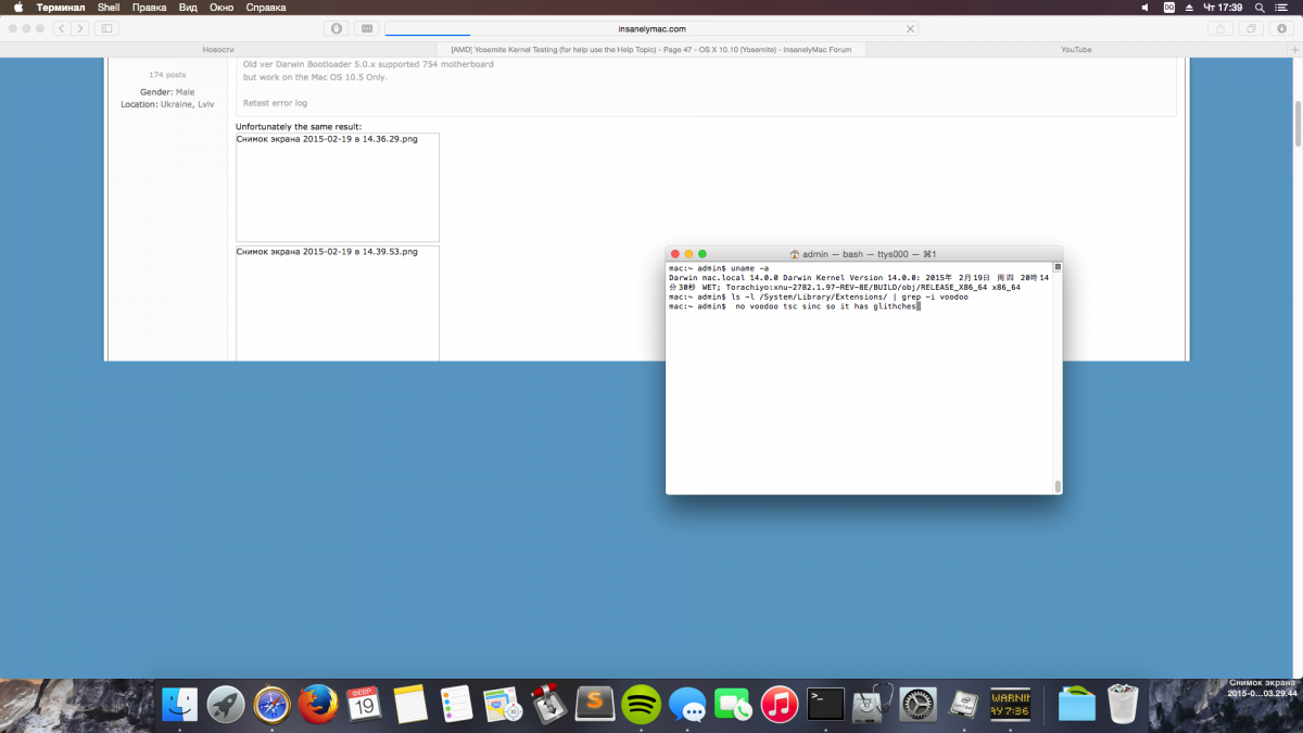

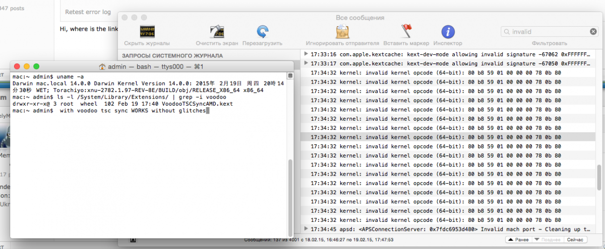

kyh3im Posted February 19, 2015 Share Posted February 19, 2015 This is TSC error. Tora Chi Yo has right. I had these problems with Mountain Lion and Mavericks when I was working on Athlon X2. TSC Fix should resolve the problem Thanx to lpukraine i figured what was the problem i didn't have a voodootscsync.kext. So i installed it. I've been testing 1010-REV-8d.zip for about a day and it works smooth UPDATE: I tested 1010-rev-8E kernel without voodoo tsp sync and i have glithes and with that kext i don't have them. PS. When i boot kernel i see some invalid kernel opcode (64-bit): 80 b8 59 01 00 00 00 78 0b 80 but i don't see a trouble about that 1 Link to comment https://www.insanelymac.com/forum/topic/302075-amd-yosemite-kernel-testing-for-help-use-the-help-topic/page/37/#findComment-2113121 Share on other sites More sharing options...

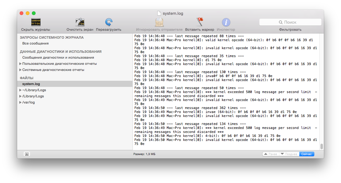

lpukraine Posted February 19, 2015 Share Posted February 19, 2015 ok I recovered TSC code add support AMD 11h processor Only and cupid L3 Cache error fix With last three versions of kernel system works, but a lot of errors in log: Link to comment https://www.insanelymac.com/forum/topic/302075-amd-yosemite-kernel-testing-for-help-use-the-help-topic/page/37/#findComment-2113140 Share on other sites More sharing options...

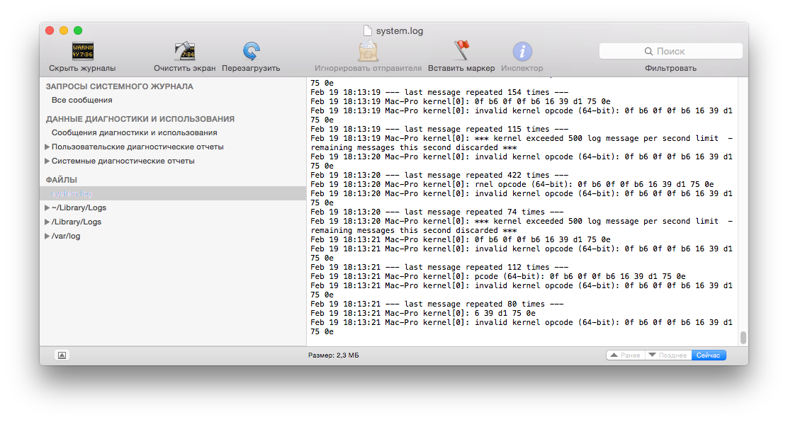

lpukraine Posted February 19, 2015 Share Posted February 19, 2015 The error kernel don’t preserve Sorry Retest I want to know where the problem of K8 Same as with previous versions. System boots and works. But error is still present( Link to comment https://www.insanelymac.com/forum/topic/302075-amd-yosemite-kernel-testing-for-help-use-the-help-topic/page/37/#findComment-2113152 Share on other sites More sharing options...

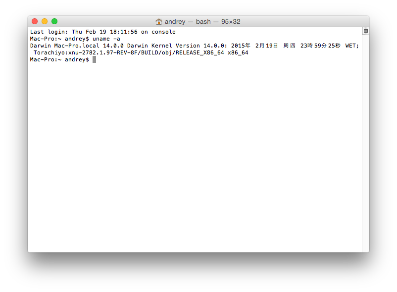

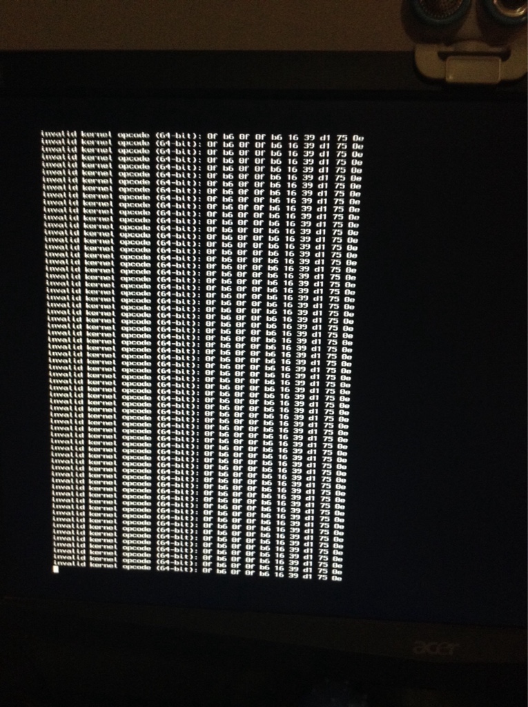

Meowthra Posted February 19, 2015 Share Posted February 19, 2015 ImageUploadedByTapatalk1424366739.267477.jpg Same as with previous versions. System boots and works. But error is still present( I Divided into two code test it 1010-REV-8H.zip 1 Link to comment https://www.insanelymac.com/forum/topic/302075-amd-yosemite-kernel-testing-for-help-use-the-help-topic/page/37/#findComment-2113214 Share on other sites More sharing options...
