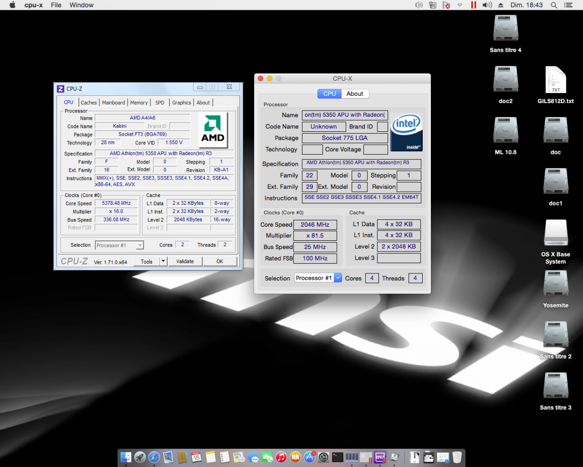

gils83 Posted February 14, 2015 Share Posted February 14, 2015 Intel FSB = AMD HT-Link DMI Processor manufacturer AuthenticAMD model AMD Athlon(tm) 5350 APU with Radeon(tm) R3 clock speed 2100.0 MHz FSB speed 100.0 MHz multiplier 21.0x no HT-Link bus HT-link chipset north/CPU = 2600 Mhz or 5200 MT/S : exemple ATI 790 FX Link to comment https://www.insanelymac.com/forum/topic/302075-amd-yosemite-kernel-testing-for-help-use-the-help-topic/page/36/#findComment-2111531 Share on other sites More sharing options...

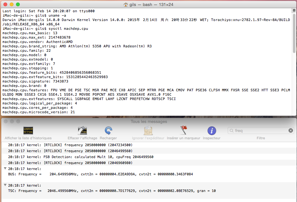

Meowthra Posted February 14, 2015 Share Posted February 14, 2015 OS X 10.10 - 10.10.1 Try to repair cpuid L3 cache for FX & Phenom $ sysctl machdep.cpu 1010-Rev-8A.zip 2 Link to comment https://www.insanelymac.com/forum/topic/302075-amd-yosemite-kernel-testing-for-help-use-the-help-topic/page/36/#findComment-2111615 Share on other sites More sharing options...
lpukraine Posted February 14, 2015 Share Posted February 14, 2015 OS X 10.10 - 10.10.1 Try to repair cpuid L3 cache for FX & Phenom $ sysctl machdep.cpu Last login: Sat Feb 14 14:47:23 on console Mac-Pro:~ andrey$ sysctl machdep.cpu machdep.cpu.max_basic: 1 machdep.cpu.max_ext: 2147483672 machdep.cpu.vendor: AuthenticAMD machdep.cpu.brand_string: AMD Athlon(tm) 64 X2 Dual Core Processor 4200+ machdep.cpu.family: 15 machdep.cpu.model: 75 machdep.cpu.extmodel: 4 machdep.cpu.extfamily: 0 machdep.cpu.stepping: 2 machdep.cpu.feature_bits: 35189062106111 machdep.cpu.extfeature_bits: 137099475967 machdep.cpu.signature: 266162 machdep.cpu.brand: 0 machdep.cpu.features: FPU VME DE PSE TSC MSR PAE MCE CX8 APIC SEP MTRR PGE MCA CMOV PAT PSE36 CLFSH MMX FXSR SSE SSE2 HTT SSE3 CX16 machdep.cpu.extfeatures: SYSCALL EM64T LAHF RDTSCP TSCI machdep.cpu.logical_per_package: 2 machdep.cpu.cores_per_package: 2 machdep.cpu.microcode_version: 21 machdep.cpu.processor_flag: 1 machdep.cpu.cache.linesize: 64 machdep.cpu.cache.L2_associativity: 16 machdep.cpu.cache.size: 524288 machdep.cpu.tlb.inst.small: 32 machdep.cpu.tlb.inst.large: 8 machdep.cpu.tlb.data.small: 32 machdep.cpu.tlb.data.small_level1: 512 machdep.cpu.tlb.data.large: 8 machdep.cpu.address_bits.physical: 40 machdep.cpu.address_bits.virtual: 48 machdep.cpu.core_count: 2 machdep.cpu.thread_count: 2 Link to comment https://www.insanelymac.com/forum/topic/302075-amd-yosemite-kernel-testing-for-help-use-the-help-topic/page/36/#findComment-2111631 Share on other sites More sharing options...

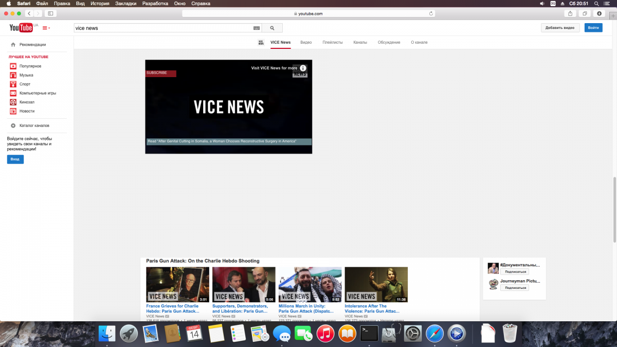

kyh3im Posted February 14, 2015 Share Posted February 14, 2015 OS X 10.10 - 10.10.1 Try to repair cpuid L3 cache for FX & Phenom $ sysctl machdep.cpu I've been getting a glitch since safari can work without webkit from 10.9.5. Not only on this version of kernel. It usually appears after several minutes of using safari. Pages can't redraw themselves when i scroll down a page, slider in safari doesn't move visually. since then some other glitches start to appear all over the system (10.10.1) for example in finder when you create new icon(folder, etc) it doesn't appear but it does in terminal (ls command), quickview (space key) window freezes half way(you still can press buttons on it but quickview window is half oppened(i'm sorry don't have screen shot, after glitch appears it's hard to use OS). Recently i reinstalled my yosemite and did combo update to 10.10.1. I think that the best way to summon that glitch is to use youtube for a while. $ sysctl machdep.cpu machdep.cpu.max_basic: 1 machdep.cpu.max_ext: 2147483672 machdep.cpu.vendor: AuthenticAMD machdep.cpu.brand_string: AMD Athlon 64 X2 Dual Core Processor 5600+ machdep.cpu.family: 15 machdep.cpu.model: 107 machdep.cpu.extmodel: 6 machdep.cpu.extfamily: 0 machdep.cpu.stepping: 2 machdep.cpu.feature_bits: 35189062106111 machdep.cpu.extfeature_bits: 1236611103743 machdep.cpu.signature: 397234 machdep.cpu.brand: 0 machdep.cpu.features: FPU VME DE PSE TSC MSR PAE MCE CX8 APIC SEP MTRR PGE MCA CMOV PAT PSE36 CLFSH MMX FXSR SSE SSE2 HTT SSE3 CX16 machdep.cpu.extfeatures: SYSCALL EM64T LAHF PREFETCHW RDTSCP TSCI machdep.cpu.logical_per_package: 2 machdep.cpu.cores_per_package: 2 machdep.cpu.microcode_version: 21 machdep.cpu.processor_flag: 1 machdep.cpu.cache.linesize: 64 machdep.cpu.cache.L2_associativity: 16 machdep.cpu.cache.size: 524288 machdep.cpu.tlb.inst.small: 32 machdep.cpu.tlb.inst.large: 8 machdep.cpu.tlb.data.small: 32 machdep.cpu.tlb.data.small_level1: 512 machdep.cpu.tlb.data.large: 8 machdep.cpu.address_bits.physical: 40 machdep.cpu.address_bits.virtual: 48 machdep.cpu.core_count: 2 machdep.cpu.thread_count: 2 Link to comment https://www.insanelymac.com/forum/topic/302075-amd-yosemite-kernel-testing-for-help-use-the-help-topic/page/36/#findComment-2111732 Share on other sites More sharing options...

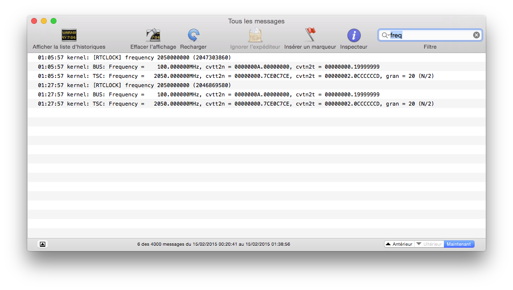

gils83 Posted February 14, 2015 Share Posted February 14, 2015 OS X 10.10 - 10.10.1 Try to repair cpuid L3 cache for FX & Phenom $ sysctl machdep.cpu bad audio , bad fsb but works thanks whoooooo !!!!!! :rolleyes:I finally found the right settings, I have a great audio without cracking and I have no more audio / video desync !! just "fsb=100 Mhz" cool n'Quiet= enable C6 State= enable frequency CPU= auto test_audio.mp4.zip ScreenFlow2.mp4.zip Link to comment https://www.insanelymac.com/forum/topic/302075-amd-yosemite-kernel-testing-for-help-use-the-help-topic/page/36/#findComment-2111736 Share on other sites More sharing options...

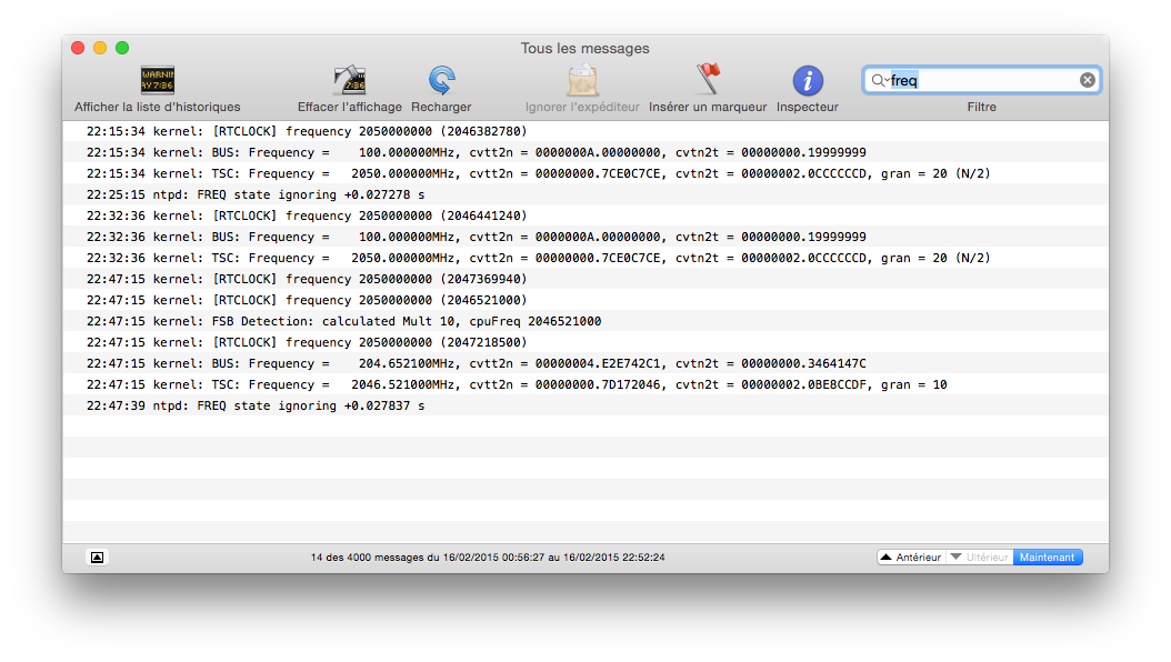

Meowthra Posted February 16, 2015 Share Posted February 16, 2015 CPUID FIX-II TEST Startup & L3 Cache 1010-REV-8B.zip 3 Link to comment https://www.insanelymac.com/forum/topic/302075-amd-yosemite-kernel-testing-for-help-use-the-help-topic/page/36/#findComment-2112126 Share on other sites More sharing options...
