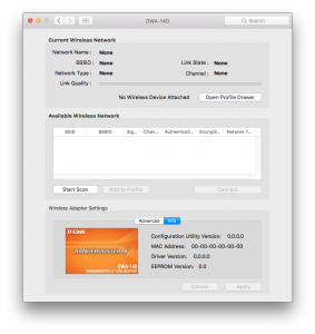

avannoord Posted September 11, 2015 Share Posted September 11, 2015 Anyone experiencing problems with OS X 10.11 (El Capitan)?? When I updated last night to the GM BETA my Mediatek USB Dongle suffered a heart attack. It still shows up I'm my System Profiler, which means it's recognized, but both the Ralink Wireless Utility and the other D-Link DWA 140 Utility no longer "see" the adapter. Just curious if anyone else has had this problem and what solutions have been found. Thanks. Link to comment https://www.insanelymac.com/forum/topic/299948-usb-wifi-updated-ralinkmediatek-rt2870-rt2770-rt3x7x-rt537x-rt5572/page/7/#findComment-2167158 Share on other sites More sharing options...
Irish_Man Posted September 14, 2015 Share Posted September 14, 2015 Anyone experiencing problems with OS X 10.11 (El Capitan)?? When I updated last night to the GM BETA my Mediatek USB Dongle suffered a heart attack. It still shows up I'm my System Profiler, which means it's recognized, but both the Ralink Wireless Utility and the other D-Link DWA 140 Utility no longer "see" the adapter. Just curious if anyone else has had this problem and what solutions have been found. Thanks. No problem here. Just updated to 10.11 Beta (15A278b) via App Store and its working just fine. Link to comment https://www.insanelymac.com/forum/topic/299948-usb-wifi-updated-ralinkmediatek-rt2870-rt2770-rt3x7x-rt537x-rt5572/page/7/#findComment-2167737 Share on other sites More sharing options...
orf3uz Posted October 1, 2015 Share Posted October 1, 2015 Anyone experiencing problems with OS X 10.11 (El Capitan)?? When I updated last night to the GM BETA my Mediatek USB Dongle suffered a heart attack. It still shows up I'm my System Profiler, which means it's recognized, but both the Ralink Wireless Utility and the other D-Link DWA 140 Utility no longer "see" the adapter. Just curious if anyone else has had this problem and what solutions have been found. Thanks. I have your same problem avannoord, anyone knows how to fix it? (My device is a EDUP EP-N8531 NANO ADAPTER - Chipset RALINK 5370) Link to comment https://www.insanelymac.com/forum/topic/299948-usb-wifi-updated-ralinkmediatek-rt2870-rt2770-rt3x7x-rt537x-rt5572/page/7/#findComment-2171682 Share on other sites More sharing options...
orf3uz Posted October 1, 2015 Share Posted October 1, 2015 Fixed! In order to make the driver work again just disable SIP (System integrity protection). Follow these steps in order to disable SIP: 1. restart Mac 2. hold CMD+R until you hear the sound, in this way you are going to boot in Recovery mode 3. From Utilities Menu, select Terminal and write: csrutil disable 4. Terminal will answer System integrity protection is disabled 5. From menu select Restart Done, the driver will work as before the update. ! Link to comment https://www.insanelymac.com/forum/topic/299948-usb-wifi-updated-ralinkmediatek-rt2870-rt2770-rt3x7x-rt537x-rt5572/page/7/#findComment-2171767 Share on other sites More sharing options...

jamez Posted October 15, 2015 Share Posted October 15, 2015 Unfortunately I have not managed to make the driver work with El Capitan (used to work on Yosemite - see my earlier post). I have used SIPUtility to disable sip: Additionally, I noticed that when installing the package, no kext's are put inside /System/Library/Extensions 1 Link to comment https://www.insanelymac.com/forum/topic/299948-usb-wifi-updated-ralinkmediatek-rt2870-rt2770-rt3x7x-rt537x-rt5572/page/7/#findComment-2177980 Share on other sites More sharing options...
jamez Posted October 17, 2015 Share Posted October 17, 2015 I solved the problem my putting the driver manually myself. I documented the whole process here: http://www.jamesattard.com/2015/10/ralink-rt5370-usb-wifi-adapter-on-el.html Link to comment https://www.insanelymac.com/forum/topic/299948-usb-wifi-updated-ralinkmediatek-rt2870-rt2770-rt3x7x-rt537x-rt5572/page/7/#findComment-2178689 Share on other sites More sharing options...
