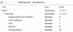

MNSiw Posted June 23, 2016 Share Posted June 23, 2016 Hi :-) TP-Link TL-WN727N v1 (Ralink RT-3070)، Sierra (OS X 10.12), Wi-Fi (kext and preference pane) is working, but after every boot it require opening preference pane and reactivating added SSID from drawer to connect it, any working auto connect solution for Sierra? * Anyone can help with editing MiniTaskUSB-DWA140.app to add default SSID. Link to comment https://www.insanelymac.com/forum/topic/299948-usb-wifi-updated-ralinkmediatek-rt2870-rt2770-rt3x7x-rt537x-rt5572/page/9/#findComment-2245333 Share on other sites More sharing options...

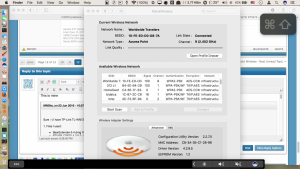

MNSiw Posted June 23, 2016 Share Posted June 23, 2016 YES, if you would be kind and share ALL the details as many of us here can't get it working. Thanks, IAN. Sure :-) I have TP-Link TL-WN727N v1, here are my steps to automate Wi-Fi connectivity 1. Files I used: BearExtender-5.4.dmg from http://store.bearextender.com/pages/regarding-yosemite-compatiblity RTUSB_D2870-4.2.9.2_UI-4.0.9.6_2013_11_29.dmg from http://www.mediatek.com/en/downloads1/downloads/ Exhaust.app from https://www.macupdate.com/app/mac/34949/exhaust RalinkAirport.app from http://aquamac.proboards.com/thread/844/ralinkairport-app-usb-wifi-dongles 2. Installed BearExtender-5.4 3. Installed RT2870USBWirelessDriver.kext (I use Kext Utility to install kexts) extracted from RTUSB_D2870-4.2.9.2_UI-4.0.9.6_2013_11_29.dmg 3. Copied RalinkAirport.app & Exhaust.app to \Applications 4. Rebooted 5. Added my preferred SSID to WirelessUtility.app and activated it 6. Removed WirelessUtility from Settings>Users & Groups>Login Items and added RalinkAirport.app 7. Added WirelessUtility.app to Exhaust and set it to 'Quit after 15 seconds' Thats it! 3 Link to comment https://www.insanelymac.com/forum/topic/299948-usb-wifi-updated-ralinkmediatek-rt2870-rt2770-rt3x7x-rt537x-rt5572/page/9/#findComment-2245411 Share on other sites More sharing options...

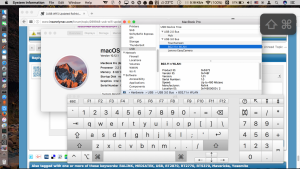

Dmitrii79 Posted July 9, 2016 Share Posted July 9, 2016 Hi guys, I'm a novice here, I've found this forum, looking a solution for starting a WiFi dongle. What I have: - a chinese WiFi dongle from Ebay, its visible in the system as "802.11n WLAN PID=0x5370, VID=0x148f". - OSX 10.11.5 El Capitan. - mac mini (it has a poor WiFi, and I want to use external one) What I did: - first I tried to download drivers from http://www.mediatek.com/en/downloads1/downloads/but it looks like, there are only for old OS. Result: WiFi not working. - tried to install BearExtender-Turbo-b6 and BearExtender-5.4. Result: the same - installed RT2870USBWirelessDriver.kext using kext install utility. Result: the same. I checked this kext, is has proper IDs inside. - I've found that the latest OSX cannot start unsigned kexts, than I've found a SIPUtility 1.0.1 and tried to activate the CSR_ALLOW_UNTRUSTED_KEXT flag. Result: I getting a error, it looks like this operation is not permitted on last OSX. So, the question is, is there a way to start RT5370 dongle on 10.11.5? I know, is was working nice on older OS versions, but it looks like, there are some problems with the latest. Thanks. Link to comment https://www.insanelymac.com/forum/topic/299948-usb-wifi-updated-ralinkmediatek-rt2870-rt2770-rt3x7x-rt537x-rt5572/page/9/#findComment-2249644 Share on other sites More sharing options...
jcc481 Posted July 16, 2016 Share Posted July 16, 2016 I rarely comment on forums, but this one has been so useful that I want to help out anyone else with my external Wifi dongle- the Belkin F6D4050 v2 (product id=0x935b, vendor id=0x050d). I'm using Yosemite 10.10.1. 1. Get your pid and vid from system information, and make sure it is the same 2. Download the modified "RT2870USBWirelessDrivers" from this post and drag the contents of the "Mavericks" folder to desktop (still works with Yosemite) 3. Right click and click "show package contents" 4. Open contents/macos/info.plist 5. Search for "belkin" 6. Where it says "Belkin - F5D 8053", modify the id product and idvendor integers to match those stated above 7. Save and kext wizard it/whatever kext tool you use 8. Download Bearextender from here (don't bother with preference panes, it doesn't work) 9. Plug in your belkin after boot and voila! This post has been most useful; amazingly it still works 7 years later with an updated driver file. Hopefully you can use the cheap dongle bundled with your even cheaper Belkin router with OS X and avoid buying a new wifi card. Link to comment https://www.insanelymac.com/forum/topic/299948-usb-wifi-updated-ralinkmediatek-rt2870-rt2770-rt3x7x-rt537x-rt5572/page/9/#findComment-2253499 Share on other sites More sharing options...

virgosun Posted November 12, 2016 Share Posted November 12, 2016 This is mine Sure :-) I have TP-Link TL-WN727N v1, here are my steps to automate Wi-Fi connectivity 1. Files I used: BearExtender-5.4.dmg from http://store.bearextender.com/pages/regarding-yosemite-compatiblity RTUSB_D2870-4.2.9.2_UI-4.0.9.6_2013_11_29.dmg from http://www.mediatek.com/en/downloads1/downloads/ Exhaust.app from https://www.macupdate.com/app/mac/34949/exhaust RalinkAirport.app from http://aquamac.proboards.com/thread/844/ralinkairport-app-usb-wifi-dongles 2. Installed BearExtender-5.43. Installed RT2870USBWirelessDriver.kext (I use Kext Utility to install kexts) extracted from RTUSB_D2870-4.2.9.2_UI-4.0.9.6_2013_11_29.dmg3. Copied RalinkAirport.app & Exhaust.app to \Applications4. Rebooted5. Added my preferred SSID to WirelessUtility.app and activated it6. Removed WirelessUtility from Settings>Users & Groups>Login Items and added RalinkAirport.app7. Added WirelessUtility.app to Exhaust and set it to 'Quit after 15 seconds' Thats it! Link to comment https://www.insanelymac.com/forum/topic/299948-usb-wifi-updated-ralinkmediatek-rt2870-rt2770-rt3x7x-rt537x-rt5572/page/9/#findComment-2317760 Share on other sites More sharing options...
virgosun Posted November 13, 2016 Share Posted November 13, 2016 Your method of Exhaust and AirPort app stop Wifi working during sleep and not auto start wifi at wake. I found this PrefPane DWA solves all above issue Share with you DWA-140WirelessUtility.prefPane.zip Link to comment https://www.insanelymac.com/forum/topic/299948-usb-wifi-updated-ralinkmediatek-rt2870-rt2770-rt3x7x-rt537x-rt5572/page/9/#findComment-2318214 Share on other sites More sharing options...
