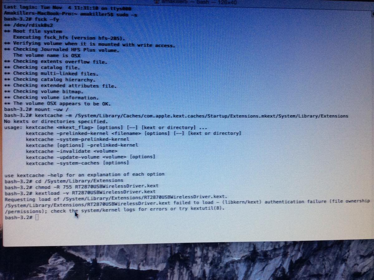

amakiller Posted November 2, 2014 Share Posted November 2, 2014 What going wrong ? Link to comment https://www.insanelymac.com/forum/topic/299948-usb-wifi-updated-ralinkmediatek-rt2870-rt2770-rt3x7x-rt537x-rt5572/page/2/#findComment-2080286 Share on other sites More sharing options...
@ROBASEFR Posted November 2, 2014 Share Posted November 2, 2014 What going wrong ? you didn't do it right !! kextcache -m /System/Library/Caches/com.apple.kext.caches/Startup/Extensions.mkext /System/Library/Extensions in your image i read kextcache -m /System/Library/Caches/com.aooke.kext.caches/Startup/Extensions.mkext /System/Library/Extensions Watch out what you'r doing !! and repair your file permissions Link to comment https://www.insanelymac.com/forum/topic/299948-usb-wifi-updated-ralinkmediatek-rt2870-rt2770-rt3x7x-rt537x-rt5572/page/2/#findComment-2080295 Share on other sites More sharing options...

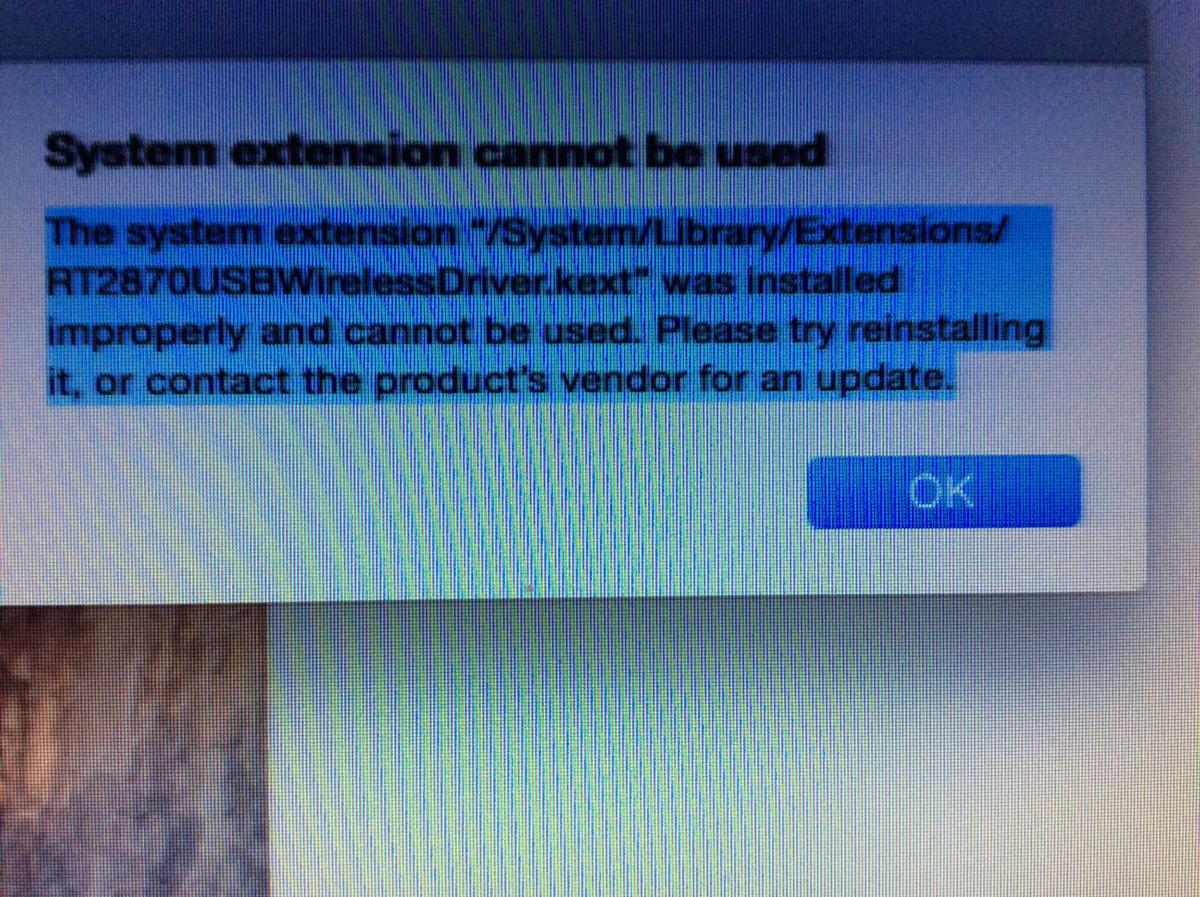

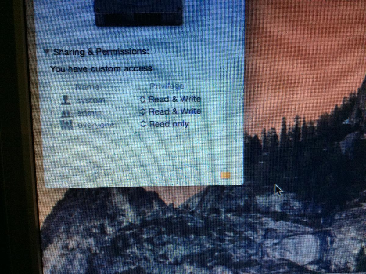

amakiller Posted November 2, 2014 Share Posted November 2, 2014 How do I repair file permission ? I am a noobie , trying to learn things also :$ I got it !!! I get this message also .... When I copy rt2870usbwirelessdriver.kext on s/l/e Link to comment https://www.insanelymac.com/forum/topic/299948-usb-wifi-updated-ralinkmediatek-rt2870-rt2770-rt3x7x-rt537x-rt5572/page/2/#findComment-2080298 Share on other sites More sharing options...
@ROBASEFR Posted November 3, 2014 Share Posted November 3, 2014 Repair file permissions you get with: Utilities /Disk Utility or with Kext Wizard 3.7.11 And use Clover Configurator 4.18.1 Did you enter in Clover/ Boot arguments (config.plist) <key>Boot</key> <dict> <key>Arguments</key> <string>kext-dev-mode=1</string> Very important ! Link to comment https://www.insanelymac.com/forum/topic/299948-usb-wifi-updated-ralinkmediatek-rt2870-rt2770-rt3x7x-rt537x-rt5572/page/2/#findComment-2080582 Share on other sites More sharing options...

amakiller Posted November 4, 2014 Share Posted November 4, 2014 Why I get this message ? Link to comment https://www.insanelymac.com/forum/topic/299948-usb-wifi-updated-ralinkmediatek-rt2870-rt2770-rt3x7x-rt537x-rt5572/page/2/#findComment-2081148 Share on other sites More sharing options...

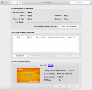

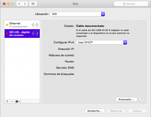

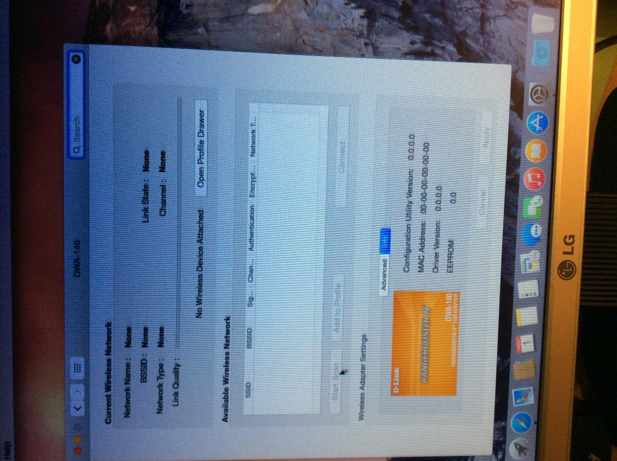

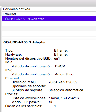

DvdGar Posted November 4, 2014 Share Posted November 4, 2014 I've done it everything posted here but .. no way ... My USB device appears in SysPref-Network My USB devide appears in SYsInfo But i have no connection in Dlink Util pane I've repeat every step several times, rebuilding caches and permissions with Kext Utility and manually in console, rebooting, checking that "kext-dev-mode=1" is in my o.c.B.p, load kext manualy too... but nothing works.. please, i'm getting crazy!! what's wrong!! Thank you Link to comment https://www.insanelymac.com/forum/topic/299948-usb-wifi-updated-ralinkmediatek-rt2870-rt2770-rt3x7x-rt537x-rt5572/page/2/#findComment-2081249 Share on other sites More sharing options...
@ROBASEFR Posted November 5, 2014 Share Posted November 5, 2014 I've done it everything posted here but .. no way ... My USB device appears in SysPref-Network Captura de pantalla 2014-11-04 a las 20.49.02.png My USB devide appears in SYsInfo Captura de pantalla 2014-11-04 a las 20.51.02.png But i have no connection in Dlink Util pane Captura de pantalla 2014-11-04 a las 20.49.22.png I've repeat every step several times, rebuilding caches and permissions with Kext Utility and manually in console, rebooting, checking that "kext-dev-mode=1" is in my o.c.B.p, load kext manualy too... but nothing works.. please, i'm getting crazy!! what's wrong!! Thank you What type of hardware is your dongle A or B ? Under 10.8 you used these original drivers from D LINK ? A: GO-USB-N150_mac_driver_revA_4.2.3_all_en_20120307 B: GO-USB-N150_mac_driver_revB_2.0.1_all_en_20130315 Link to comment https://www.insanelymac.com/forum/topic/299948-usb-wifi-updated-ralinkmediatek-rt2870-rt2770-rt3x7x-rt537x-rt5572/page/2/#findComment-2081476 Share on other sites More sharing options...
