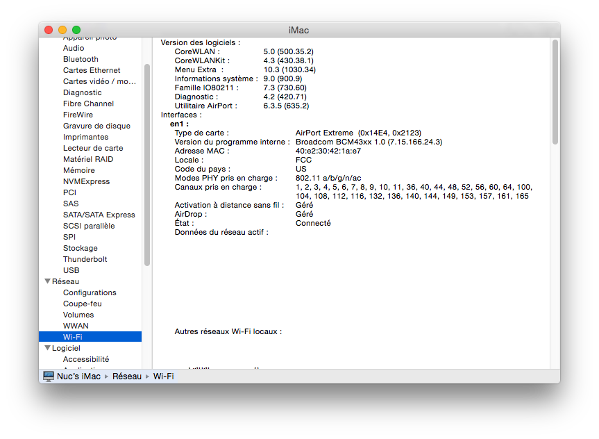

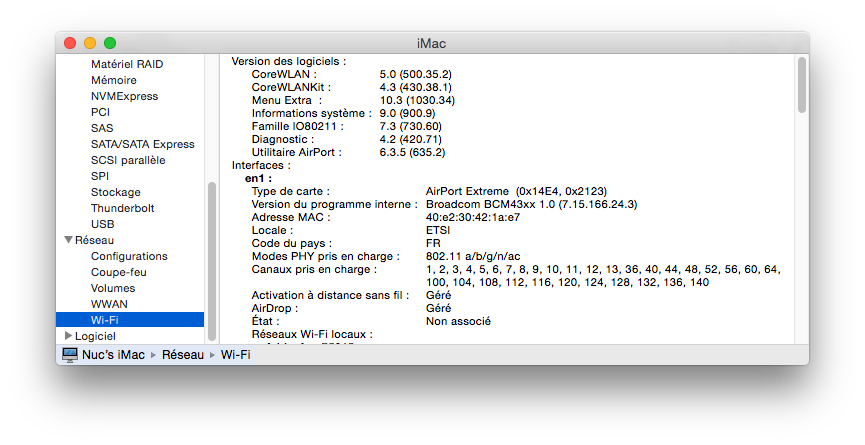

sebinouse Posted April 24, 2015 Share Posted April 24, 2015 I managed to change the Country Code of the Airport Card by modifying the 5GHz US/FCC Clover Patch ! Custom FR BCM94352 5 GHz (>10.10.3) Name AirPortBrcm4360 Find 41 83 FC FF 74 2C 48 Replace 66 C7 06 46 52 EB 2B FR 46 52 You can modify it with your own 2-letters country code : Custom ?? BCM94352 5 GHz (>10.10.3) Name AirPortBrcm4360 Find 41 83 FC FF 74 2C 48 Replace 66 C7 06 ?? ?? EB 2B Codes mentioned in AirPortBrcm4360 ... but not tested yet ! (except FR DE US CA GB) AE AF AR AT AU AZ BD BE BG BN BR BT BY CA CH CL CN CO CR CY CZ DE DK DO EC EE EG ES FI FR GB GR GT GU HK HN HR HU ID IE IL IN IS IT JM JO JP KH KR KZ LA LI LK LT LU LV MA MM MN MO MT MV MX MY NI NL NO NP NZ PA PE PH PK PL PR PT PY RO RS RU SA SE SG SI SK SV TH TR TT TW UA US UY VE VI VN ZA More informations : here 4 Link to comment https://www.insanelymac.com/forum/topic/292542-airport-pcie-half-mini/page/14/#findComment-2130665 Share on other sites More sharing options...

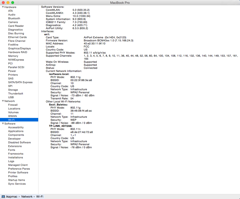

SweNic Posted April 25, 2015 Share Posted April 25, 2015 hello this patch is working in 10.10.3 10.10.2 and newer, 5GHz Binary patch: AirPortBrcm4360 (US: 1 or 2, not both) US/FCC the-darkvoid #981 Find: 41 83 FC FF 74 2C 48 Replace: 66 C7 06 55 53 EB 2B good hack Thank you Working flawless on Asus Z87 Deluxe/Dual on 10.10.3 //SweNic Link to comment https://www.insanelymac.com/forum/topic/292542-airport-pcie-half-mini/page/14/#findComment-2130806 Share on other sites More sharing options...
The Real Deal Posted April 26, 2015 Share Posted April 26, 2015 I managed to change the Country Code of the Airport Card by modifying the 5GHz US/FCC Clover Patch ! Custom FR BCM94352 5 GHz (>10.10.3) Name AirPortBrcm4360 Find 41 83 FC FF 74 2C 48 Replace 66 C7 06 46 52 EB 2B FR 46 52 You can modify it with your own 2-letters country code : Custom ?? BCM94352 5 GHz (>10.10.3) Name AirPortBrcm4360 Find 41 83 FC FF 74 2C 48 Replace 66 C7 06 ?? ?? EB 2B Codes mentioned in AirPortBrcm4360 ... but not tested yet ! (except FR DE US CA GB) AE AF AR AT AU AZ BD BE BG BN BR BT BY CA CH CL CN CO CR CY CZ DE DK DO EC EE EG ES FI FR GB GR GT GU HK HN HR HU ID IE IL IN IS IT JM JO JP KH KR KZ LA LI LK LT LU LV MA MM MN MO MT MV MX MY NI NL NO NP NZ PA PE PH PK PL PR PT PY RO RS RU SA SE SG SI SK SV TH TR TT TW UA US UY VE VI VN ZA More informations : here Good Bien tout ça ! Link to comment https://www.insanelymac.com/forum/topic/292542-airport-pcie-half-mini/page/14/#findComment-2131160 Share on other sites More sharing options...
sebinouse Posted April 29, 2015 Share Posted April 29, 2015 I managed to change the Country Code of the Airport Card by modifying the 5GHz US/FCC Clover Patch ! My bad ... this has been discovered a long time ago ... but I was unaware of that ... Link to comment https://www.insanelymac.com/forum/topic/292542-airport-pcie-half-mini/page/14/#findComment-2131990 Share on other sites More sharing options...

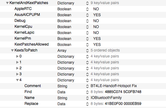

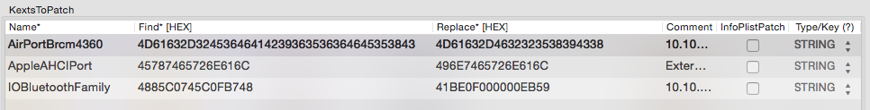

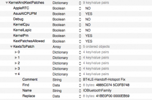

ps004ynos Posted May 6, 2015 Share Posted May 6, 2015 I know this is going to come across as completely hopeless sounding but here goes: I am attempting the BCM94352 5 Ghz/BT Handoff Patch via the Clover/kext patch. I downloaded the 10.10.2 and newer config-bmc94352-102.plist.zip. I opened the config.plist. Here's where I'm confused: which part of the 102.plist text do I copy and where do I paste it in the config.plist? Do I copy the entire 102.plist text, cut out the the parts I don't want, then paste it into the config.plist Or do I copy only one specific section of the 102.plist text then paste it into the config.plist I am confused by the difference of the language in the 102.plist file and the config.plist. I.e. the 102.plist has a number of sections separated by "{" characters which are not present in the config.plist file which has sections separated by </dict> Because of my lack of experience, I did try the Kext/binary patch method but ran into "10.10.3 is not supported as seen in the copy below from my terminal window: Patch Options: 1 - Handoff only 2 - Handoff/BCM94352/US-FCC 3 - Handoff/BCM94352/XT-ROW Select Patch (1, 2 or 3): 2 Password: Copy S/L/E/IOBluetoothFamily.kext to Desktop/IOBluetoothFamily-10.10.3.kext OS X Version: 10.10.3 is not supported No system files were changed To save a Copy to this Terminal session: Terminal/Shell/Export Text As ... logout Link to comment https://www.insanelymac.com/forum/topic/292542-airport-pcie-half-mini/page/14/#findComment-2133477 Share on other sites More sharing options...
artur_pt Posted May 6, 2015 Share Posted May 6, 2015 hello is something like this .. only need the specific part of the kext patch for hand off good hack Link to comment https://www.insanelymac.com/forum/topic/292542-airport-pcie-half-mini/page/14/#findComment-2133481 Share on other sites More sharing options...

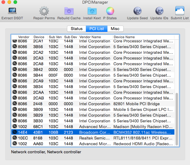

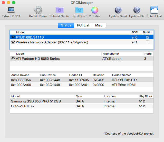

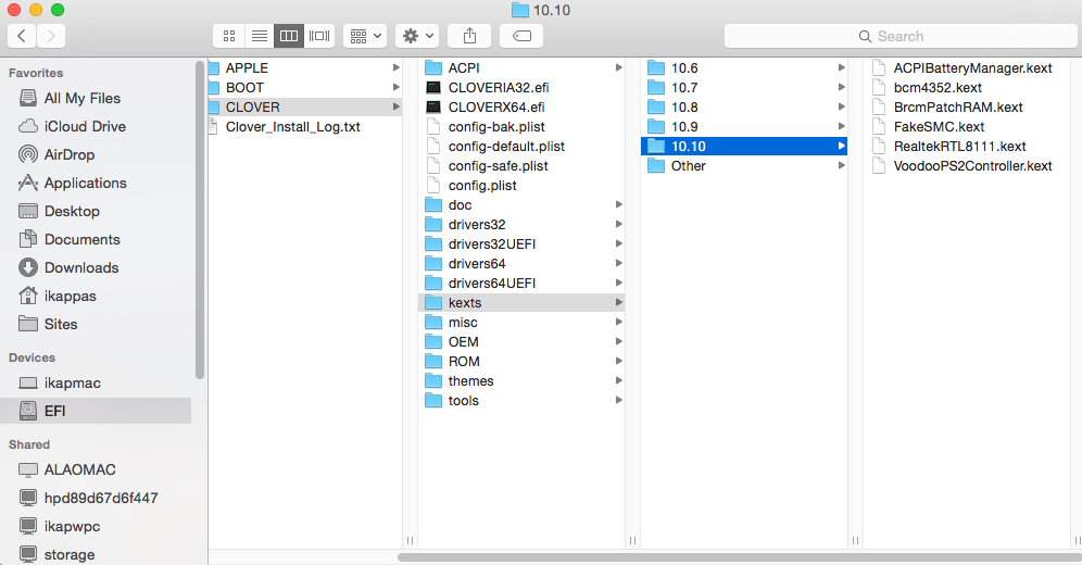

ikapppas Posted May 7, 2015 Share Posted May 7, 2015 Hello everyone! I have recently got Yosemite 10.10.3 on my HP Pavilion dv-3150eu using Clover (3202). Everything worked except the included Ralink/Motorola wifi/bluetooth so I got it replaced with 43b1 - BCM94352 HMB/AzureWave AW-CE123H 2.4/5 GHz, ac+abgn, 2 stream, 867 Mbs + BT4LE using a modded BIOS to bypass the whitelist. Everything works in Windows 8.1 Pro using the latest drivers found at Asus/X88 Deluxe/Wifi + Bluetooth but in Yosemite I cannot get the bluetooth to work/pair. My configuration following your guide in post #1 is as follows: 1. I have installed bcm4352.kext and BrcmPatchRam.kext in Clover/kexts/10.10/* 2. I have the following wifi/bluetooth related settings in Clover config.plist: Clover/ACPI/FixAirport = disabled Clover/Devices/FakeWifi = 0x0000 Clover/KernelAndKextPatches/BCM94352 5GHz US/FCC (AirPortBrcm4360: 4183FCFF742C48 -> 66C7065553EB2B) Clover/KernelAndKextPatches/BCM94352 Airport Extreme (AirPortBrcm4360: 6B100000750D -> 6B1000009090) Clover/KernelAndKextPatches/BT4LE Handoff/Hotspot (IOBluetoothFamily: 4885C0745C0FB748 -> 41BE0F000000EB59) Using this configuration I have the Wifi up and running as AirPort Extreme (0x14E4, 0x2123), FCC/US and both 2.4GHz and 5GHz channels available (see attachment). The bluetooth is also available and the firmware is updated to v14 c5575 but I cannot see any devices and/or pair with them. Your assistance in getting the bluetooth up and running would be greatly appreciated! Thank you in advance Update 1: Repairing disk permissions and rebooting seems to make the bluetooth work!. Now If put the computer to sleep the bluetooth is not available on resume. Also In order to make it work again I need to re-fix disk permissions and reboot. After sleep the driver seems to corrupt some of the files it accesses. Btw I am using Rehabman BrcmPatchRam.kext. Any suggestions for making the bluetooth sleep? Update 2: Unfortunately after shutting down the laptop for an hour and turning it back on the bluetooth is back to not usable and disk permissions doesn'f fix anything. I tried disabling the bluetooth but I get the following in the system.log: 5/8/15 1:08:23.000 AM kernel[0]: **** [IOBluetoothHCIController][CallBluetoothHCIReset] -- ERROR -- BluetoothHCIReset() failed to reset device! Error = 0xFF02 (kBluetoothSyncHCIRequestTimedOutWaitingToBeSent) -- 0xe000 **** 5/8/15 1:08:23.000 AM kernel[0]: REQUIRE_NO_ERR failure: 0xff02 - file: /SourceCache/IOBluetoothFamily_kexts/IOBluetoothFamily-4304.4.4/Core/Family/HCI/Transports/USB/IOBluetoothHostControllerUSBTransport/IOBluetoothHostControllerUSBTransport.cpp:1983 5/8/15 1:08:29.000 AM kernel[0]: REQUIRE_NO_ERR failure: 0xff02 - file: /SourceCache/IOBluetoothFamily_kexts/IOBluetoothFamily-4304.4.4/Core/Family/HCI/IOBluetoothFamily.cpp:28240 5/8/15 1:08:29.000 AM kernel[0]: REQUIRE_NO_ERR failure: 0xff02 - file: /SourceCache/IOBluetoothFamily_kexts/IOBluetoothFamily-4304.4.4/Core/Family/HCI/Transports/USB/BroadcomBluetoothHostControllerUSBTransport/BroadcomBluetoothHostControllerUSBTransport.cpp:1030 5/8/15 1:08:29.000 AM kernel[0]: **** [IOBluetoothHostControllerUSBTransport][setPowerStateWL] -- PerformPowerStateChange() failed: 0xFF02 (kBluetoothSyncHCIRequestTimedOutWaitingToBeSent) -- powerStateOrdinal = OFF, mCurrentInternalPowerState = ON -> mPendingInternalPowerState = OFF -- 0x5800 **** Update 3: This morning I boot up the laptop (after trying to disable it last night - see log above) and the bluetooth was disabled. I enabled it and it works... Perhaps something is inconsistent between reboots with the enabled state of the bluetooth controller that renders it unusable. Update 4: One thing I noticed is that the Bluetooth/Hardware, Features and Settings/Name key is empty when the bluetooth is not working... config.plist.zip IORegistry.zip Link to comment https://www.insanelymac.com/forum/topic/292542-airport-pcie-half-mini/page/14/#findComment-2133848 Share on other sites More sharing options...

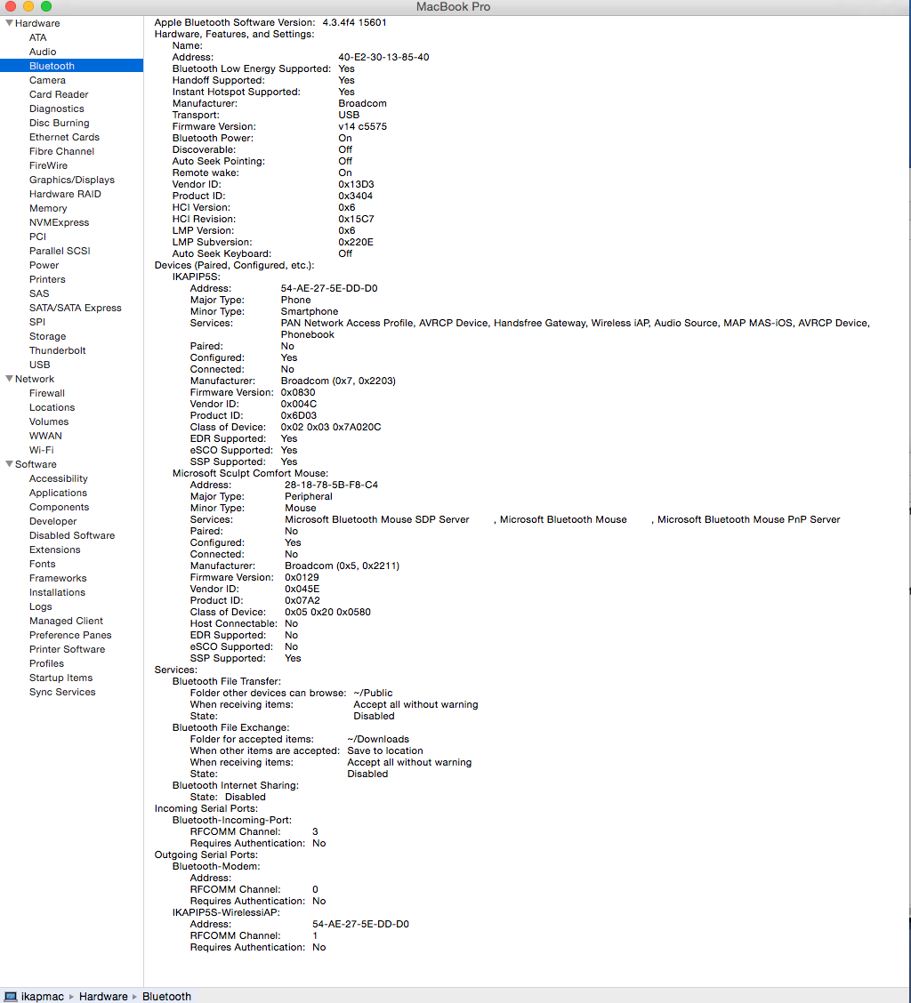

vanquybn Posted May 15, 2015 Share Posted May 15, 2015 Hi all, I patched my kext followed this topic. everything looks good (image attached). Then I config my iPhone 5c: login icloud account, enable Handoff, bluetooth, wifi ... Botth MacOSX and iPhone are connecting to same wifi network. then I use other phone to call to my iPhone => the Handoff does not work on my MacOSX. nothing happen. Please help. Thanks! Link to comment https://www.insanelymac.com/forum/topic/292542-airport-pcie-half-mini/page/14/#findComment-2135605 Share on other sites More sharing options...
toleda Posted May 20, 2015 Author Share Posted May 20, 2015 Update 2.5 - 5/19/2015 - 10.10.3 Added 1. wireless_bcm94352-100-v3.0.command, 2. config-bcm94352-103.plist and 3. Country Code support, credit: Sebinouse. Removed Country Code/XT. Note; wireless_bcm94352-100-v3.0.command, and config-bcm94352-103.plist support all versions of Yosemite (10.10, 10.10.1, etc.) then I use other phone to call to my iPhone => the Handoff does not work on my MacOSX. nothing happen. Is the iPhone ringing? Is the Yosemite Desktop showing an incoming call? Update 4: One thing I noticed is that the Bluetooth/Hardware, Features and Settings/Name key is empty when the bluetooth is not working... Broadcom firmware update is not completing successfully. Any Console messages for BrcmPatchRam.kext? Link to comment https://www.insanelymac.com/forum/topic/292542-airport-pcie-half-mini/page/14/#findComment-2137090 Share on other sites More sharing options...
vanquybn Posted May 20, 2015 Share Posted May 20, 2015 Is the iPhone ringing? Is the Yosemite Desktop showing an incoming call? Yes, my iPhone ringing, but Yosemite Desktop show nothing Hi toleda, I have just try with your new version. it is now working like a charm. Thank you so much! Link to comment https://www.insanelymac.com/forum/topic/292542-airport-pcie-half-mini/page/14/#findComment-2137094 Share on other sites More sharing options...

lisai9093 Posted June 10, 2015 Share Posted June 10, 2015 Ok, I figured out the new handoff binary patch for 10.11 beta1. Thanks for previous work done by Skvo and others. IOBluetoothFamily Find: 4885FF7447488B07 Replace: 41BE0F000000EB44 2 Link to comment https://www.insanelymac.com/forum/topic/292542-airport-pcie-half-mini/page/14/#findComment-2143521 Share on other sites More sharing options...
