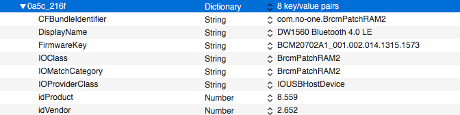

Hey @Rehabman,
maybe you can help me figure things out.
WIFI works perfectly but my Bluetooh won't.
Edith:
totally forgot to mention which card i use... :):
BCM94352Z M.2 NGFF 802.11AC 867Mbps 802.11N BT 4.0 DELL DW1560
what i did:
FakePCIID_Broadcom_WiFi to SLE
-> works OOB after reboot thanks for that!
BT:
Installed
BrcmPatchRAM2.kext+BrcmFirmwareData.kext
-> reboot stuck loading firmware (seems to be)
system.log
Nov 11 13:02:15 localhost kernel[0]: BrcmPatchRAM: Firmware store start
So i patched BRcmFirmwareRepo.kext adding:
BCM20702A1_001.002.014.1315.1573.zhx -> after your instructions specified with the asus windows firmware
In BrcmPatchRAM2.kext i edited the Info.plist reflecting the changes for my card:
DPCIManager -> defaults to -> AirPortBrcm4360
Let me know if you need any further information.

Hey @Rehabman,
Edith:
what i did:
BT:
Installed
system.log
Regards
Jan
