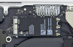

Photo from teardown (сlick to enlarge):
Module: Broadcom BCM943602CS
Wi-Fi chipset: Broadcom BCM43602. Vendor ID 0x14e4, DeviceID: 0x43ba
Broadcom News Release for BCM43602 - http://www.broadcom.com/press/release.php?id=s817141
Bluetooth chipset: Broadcom BCM20703 (chipset support BT 4.1). Vendor ID: 0x05ac (Apple Inc.),  Product ID: 0x8290.

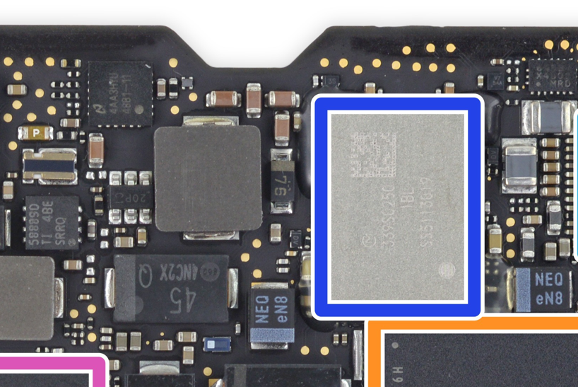

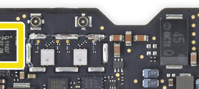

Photo from teardown. Integrated module:
two antenna connectors on the other side of the motherboard:
Module: Murata 339S0250
Based on a single-chip solution: Broadcom BCM4350 (Wi-Fi 802.11ac, up to 866Mbps + Bluetooth 4)
Product Info for BCM4350: https://www.broadcom.com/products/wireless-connectivity/wireless-lan/bcm4350
Wi-Fi used PCIe bus: Vendor ID 0x14e4, DeviceID: 0x43a3
Bluetooth used UART bus (not USB).
