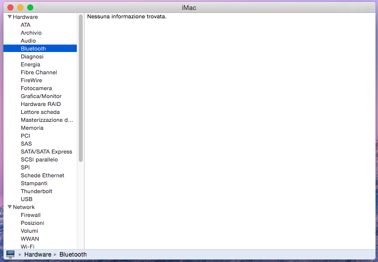

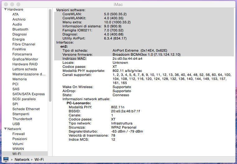

Then a step forward was made, I installed these kext: http://www.hackintoshosx.com/files/file/4352-mini-pci-bcm4352-fully-working-with-handoff/  the result is this:
BT not found and Wi-Fi working
I include photos
