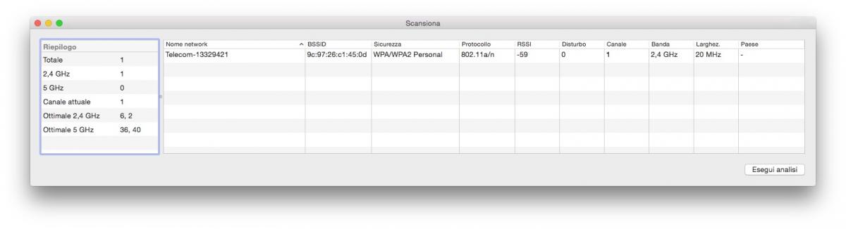

lagoon Posted July 8, 2015 Share Posted July 8, 2015 Using FakePCIID_BCM94352Z_as_BCM94360CS2.kext wifi was recognized. But unknown locale.Now wifi scan work, but only with 2,4 GHz and very low range. I can't connect to the wifi network showed in the picture. For Bluetooth I'm using BrcmPatchRAM.kext and BTFirmwareUploader.kext, but it doesn't scan. I have attached my current configuration. Orange tag for new kext, Green tag for old kext (not touched) and yellow tag for HWMonitor kexts. Archivio.zip Link to comment https://www.insanelymac.com/forum/topic/292542-airport-pcie-half-mini/page/16/#findComment-2151810 Share on other sites More sharing options...
toleda Posted July 9, 2015 Author Share Posted July 9, 2015 Now wifi scan work, but only with 2,4 GHz and very low range. For Bluetooth I'm using BrcmPatchRAM.kext and BTFirmwareUploader.kext, but it doesn't scan. 5 GHz channels available. Unknown, no idea what it should be. Two BT kexts, ensures neither work. Remove BTFirmwareUploader.kext Link to comment https://www.insanelymac.com/forum/topic/292542-airport-pcie-half-mini/page/16/#findComment-2151981 Share on other sites More sharing options...

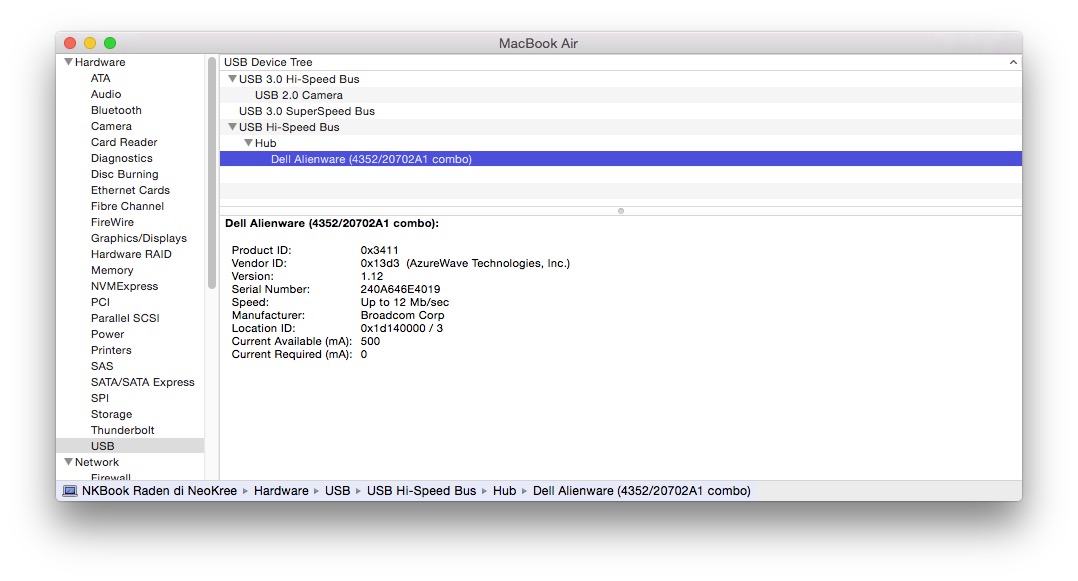

lagoon Posted July 9, 2015 Share Posted July 9, 2015 Wifi not working, I created an hotspot with my smartphone and when I try to connect Diagnostic Tool advise me that It can't.I have attached a full diagnostic for the problem. I don't know if this can be useful. US with FCC locale can't be used instead of my current country locale? For bluetooth: Once removed BTFirmwareUploader.kext nothing changed. System recognize it, but I cannot see any devices.Maybe I need to modify the BrcmPatchRAM.kext, because I have a strange Bluetooth PID: 0x3411 ?? WirelessDiagnostics_XA22253IF5V8_2015-07-09_18.50.59.tar.gz Link to comment https://www.insanelymac.com/forum/topic/292542-airport-pcie-half-mini/page/16/#findComment-2151989 Share on other sites More sharing options...

toleda Posted July 13, 2015 Author Share Posted July 13, 2015 created an hotspot with my smartphone and when I try to connect Diagnostic Tool advise me that It can't. US with FCC locale can't be used instead of my current country locale? because I have a strange Bluetooth PID: 0x3411 ?? Not sure what a smartphone hotspot shows you. CC ensure RF compliance with local regulations, some US/FCC frequencies are not legal in your CC. Suggestion, check Locale on native hardware. Verify your device id is present in BrcmPatchRAM.kext It works under OSX 10.6.8, but not under OSX 10.9.4. Do not know what changed in 10.9.4. Link to comment https://www.insanelymac.com/forum/topic/292542-airport-pcie-half-mini/page/16/#findComment-2153041 Share on other sites More sharing options...

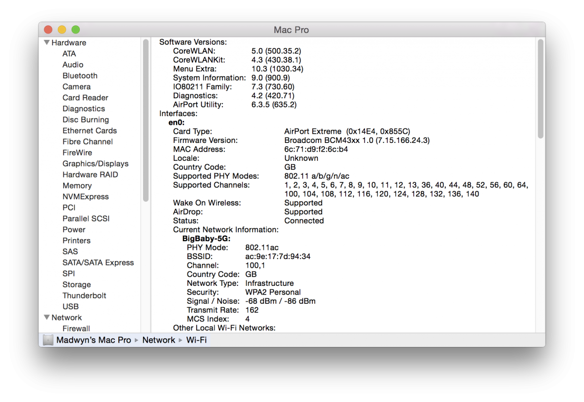

madins Posted August 13, 2015 Share Posted August 13, 2015 I have a question regarding to the 5G ac speed. An AW-CE123H using Clover with FAKEPCIID. Connection to 5G using ac is about 200Mbps and test speed is only 30Mbps. However, in Windows, the connection speed can reach 867Mbps with test speed of 74Mbps(the package speed). I've tested it with two different routers(both 1300Mbps 5G), but no difference. Is that a problem or it's just normal? What can I do to improve it as the desktop and router won't be able to move? Link to comment https://www.insanelymac.com/forum/topic/292542-airport-pcie-half-mini/page/16/#findComment-2159988 Share on other sites More sharing options...
toleda Posted August 13, 2015 Author Share Posted August 13, 2015 Is that a problem or it's just normal? What can I do to improve it as the desktop and router won't be able to move? No. 4352 is 2x, max 867 Mbps. What antennas? What does System Information/Network/Wi-Fi or Menu Bar/Option/WiFi icon show? Link to comment https://www.insanelymac.com/forum/topic/292542-airport-pcie-half-mini/page/16/#findComment-2160022 Share on other sites More sharing options...
madins Posted August 14, 2015 Share Posted August 14, 2015 No. 4352 is 2x, max 867 Mbps. What antennas? What does System Information/Network/Wi-Fi or Menu Bar/Option/WiFi icon show? This is the information shown in System Information. Link to comment https://www.insanelymac.com/forum/topic/292542-airport-pcie-half-mini/page/16/#findComment-2160436 Share on other sites More sharing options...

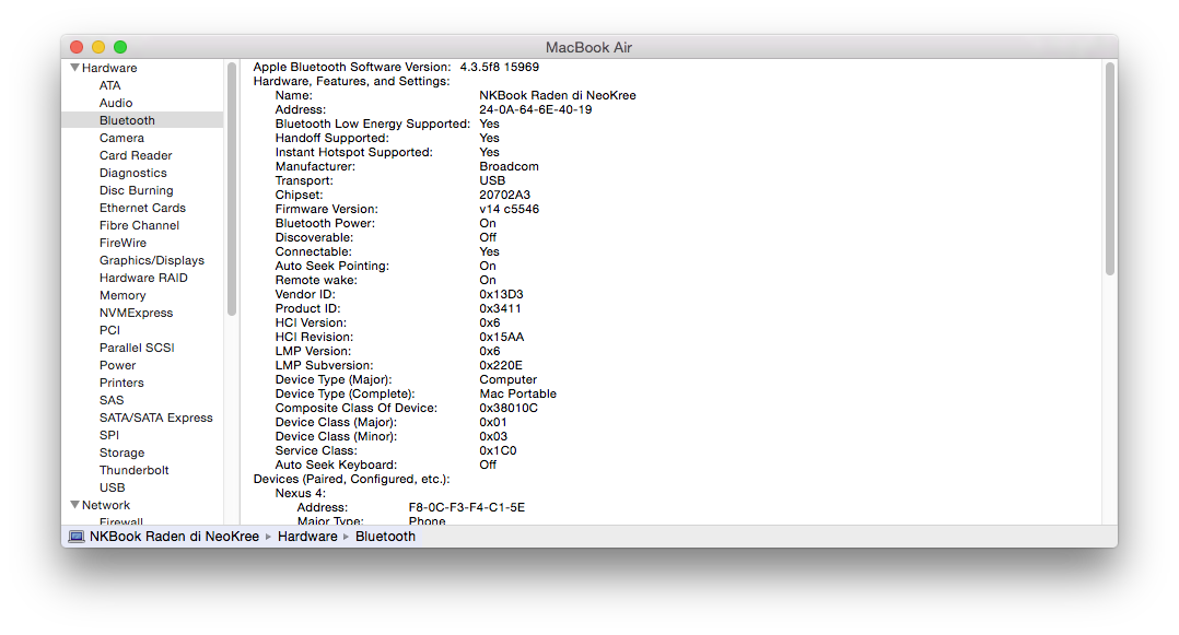

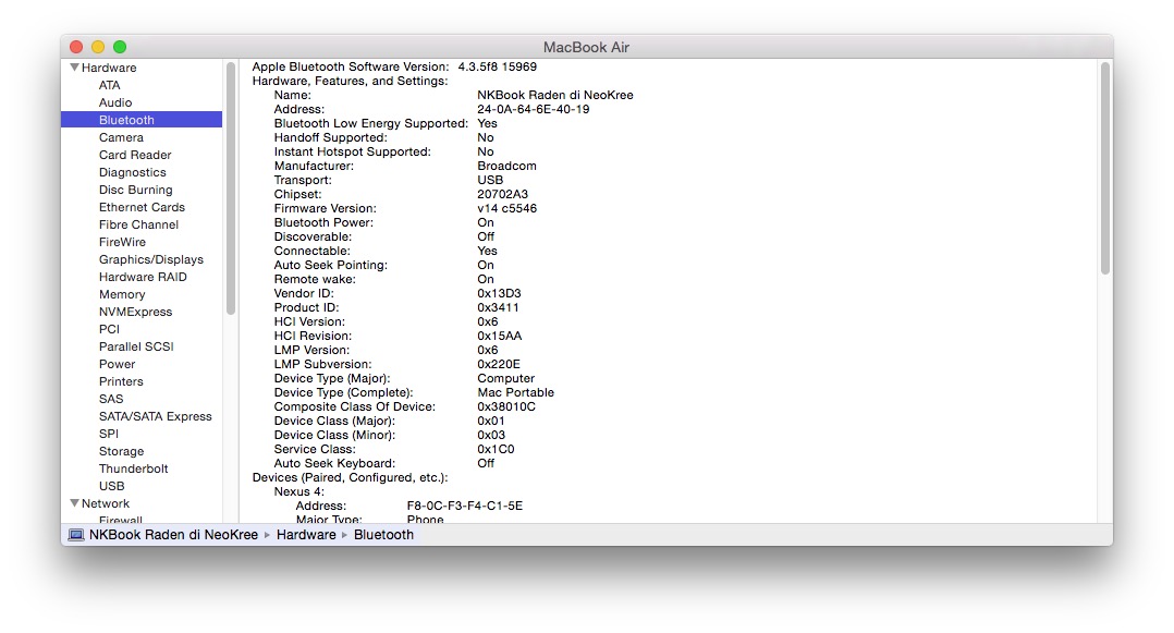

scififan68 Posted August 15, 2015 Share Posted August 15, 2015 The BCM4352 still works great in 10.10.5, but zero bluetooth is seen, I tried the latest kexts and patches and still nothing, in the end I decided to just remove the bluetooth kexts until there is solution found. Link to comment https://www.insanelymac.com/forum/topic/292542-airport-pcie-half-mini/page/16/#findComment-2160717 Share on other sites More sharing options...
toleda Posted August 15, 2015 Author Share Posted August 15, 2015 This is the information shown in System Information. Antenna problem, signal is too low. The BCM4352 still works great in 10.10.5, but zero bluetooth is seen, No known Bluetooth issues in 10.10.5. Link to comment https://www.insanelymac.com/forum/topic/292542-airport-pcie-half-mini/page/16/#findComment-2160720 Share on other sites More sharing options...
madins Posted August 16, 2015 Share Posted August 16, 2015 Antenna problem, signal is too low. Thank you. I am using the original antenna from Asus. Maybe it's better to switch to a pair of high gain antennas. Link to comment https://www.insanelymac.com/forum/topic/292542-airport-pcie-half-mini/page/16/#findComment-2160811 Share on other sites More sharing options...
