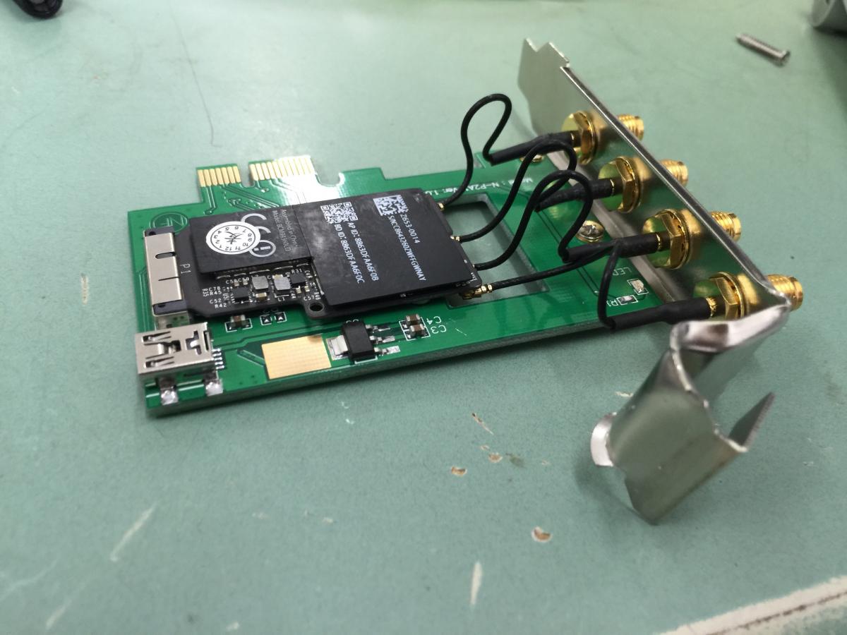

This issue is driving me mad. I've ordered a adapter to the BCM4360CD I had. I thought it would work out of the box, but neither wifi or bluetooth did. Wifi is completely off. Bluetooth shows as on, but it can't pair devices after reboot. To get the bluetooth woking again, I have to remove com.apple.Bluetooth.plist, tune off Bluetooth and then pair the mouse / keyboard again. Clover shows ound Airport BCM at 0x1C0002, 0x0 at boot... Under bluetooth info, it shows the device, under wifi, absolutely nothing. Under DPCI Manager it shows the wireless adapter... I'm on 10.11, with Clover 3280.
Any tip? I don't know what else to do.

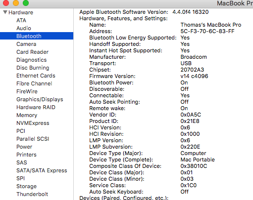

One thing I have noticed that could be a problem, in Yosemite the firmware version showed as v14 c5555 but in El Capitan its now v14 c4096 as you can see above. Could that be causing the Handoff not to work?
Any advice?
