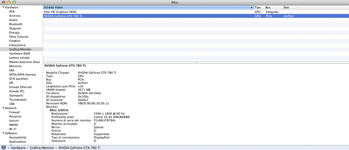

2-isn't strange my screenshot attached? i have a working dsdt with airplay mirroring, powermanagment etc, but why is written airport as slot for the gtx 780ti????

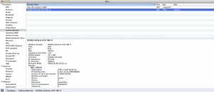

It's just DMI issue, you can mod that with AmiBcp. (Tables 9 up to 12)

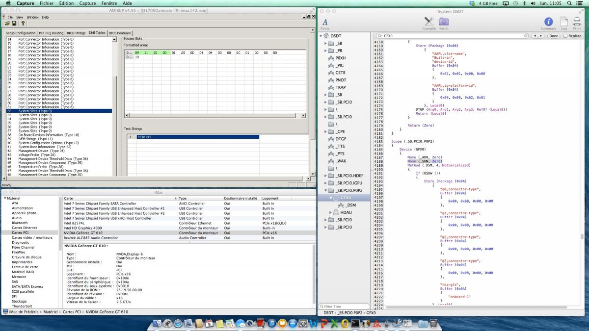

Hi Fred, Thanks for sharing your knoweldge, which data we have to change in DMI table ? and with what?
You can change DMI name for PCI slot and make show in profiler by adding in your DSDT name (_SUN, x)
