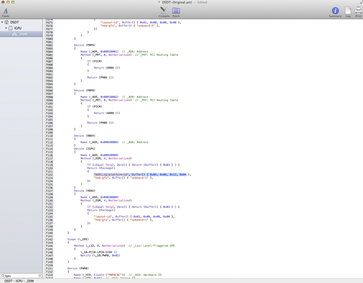

ArcticFox Posted June 25, 2014 Share Posted June 25, 2014 What do I have to edit in DSDT. Link to comment Share on other sites More sharing options...
xpamamadeus Posted June 25, 2014 Author Share Posted June 25, 2014 What do I have to edit in DSDT. check this thread. http://www.insanelymac.com/forum/topic/294315-radeon-r9-270x-framebuffer-issue/ Link to comment Share on other sites More sharing options...
ArcticFox Posted June 25, 2014 Share Posted June 25, 2014 I did do but I can't find any of that in my DSDT. Link to comment Share on other sites More sharing options...

xpamamadeus Posted June 25, 2014 Author Share Posted June 25, 2014 tried to put ozmosistheme on my bios but it doesn't work. should i delete the gigabyte file logo (if it exists?)? dont work how ? U cant enter ozmosis GUI with home button ? I did do but I can't find any of that in my DSDT. U cant find what ? U used maciasl and apply patch from this thread ? Link to comment Share on other sites More sharing options...

xpamamadeus Posted June 25, 2014 Author Share Posted June 25, 2014 I did do but I can't find any of that in my DSDT. apply ozmosis files to this bios and try. i patched dsdt for u and report.test1.rom.zip i don't understand. what i have to do to see the quo logo at the boot screen instead of gigabyte logo? This are boot logo files u want change. And if u want make own logo this its tool to do this from windows. ChangeLogo.zip Link to comment Share on other sites More sharing options...

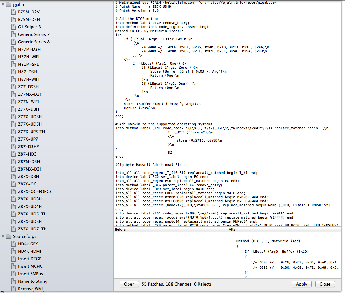

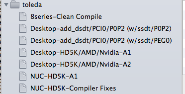

xelanaiznac Posted June 25, 2014 Share Posted June 25, 2014 apply ozmosis files to this bios and try. i patched dsdt for u and report.test1.rom.zip This are boot logo files u want change. And if u want make own logo this its tool to do this from windows. ChangeLogo.zip thank you hi guys. please, is something else i can do to improve my dsdt for the z87x ud4h? these are my steps after extracting the dsdt through uefitool and dsdt2bios utility: 1-patched with pjalm z87x-ud4h 2-patched with toleda 8 series-clean compile 3-patched with toleda desktop-hd5k/AMD/NVIDIA-A1 4-edited the igpu value (this gives me airplay mirroring using gfx as primary display) 5-adding the ssdt for power management at the bottom 6-compile and save attached the original dsdt and the dsdt edited as i wrote before (without putting the ssdt for power management at the bottom). thank you DSDT-Original.aml.zip DSDTpatched.aml.zip Link to comment Share on other sites More sharing options...

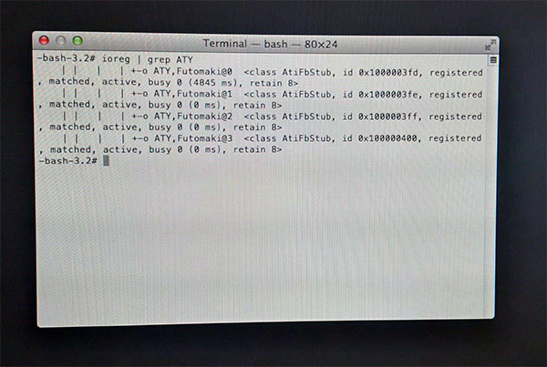

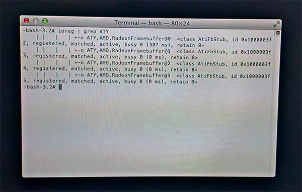

ArcticFox Posted June 26, 2014 Share Posted June 26, 2014 xpam, I tried that rom and I still don't get a second screen on my 280X, how do I change the framebuffer. Using Ozmosis it says the framebuffer is Futomaki and I don't get second screen: Using Clover it says the framebuffer is RadeonFramebuffer and I do get second screen: Link to comment Share on other sites More sharing options...
THe KiNG Posted June 26, 2014 Share Posted June 26, 2014 ... I tried that rom and I still don't get a second screen on my 280X, how do I change the framebuffer. ... It was said before, I will say it again, you cannot change the framebuffer! Link to comment Share on other sites More sharing options...

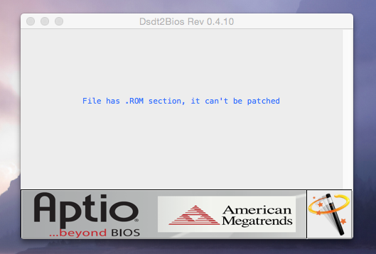

StoneTemplePilots Posted June 27, 2014 Share Posted June 27, 2014 Check first post for DSDT2bios. Hi xpamamamdeus, I followed your guide exactly, but as you can see dsdt2bios fails with "File has .ROM section. It can't be patched." However I can tell you additionally, that loading DSDT.aml from EFI partition is not working as it should. There are some parts of the existing DSDT merged with the patched DSDT, and that's why my audio still doesn't work. I remember we discussed DSDT patching at MDL so next step is to try it manually. Link to comment Share on other sites More sharing options...
