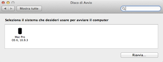

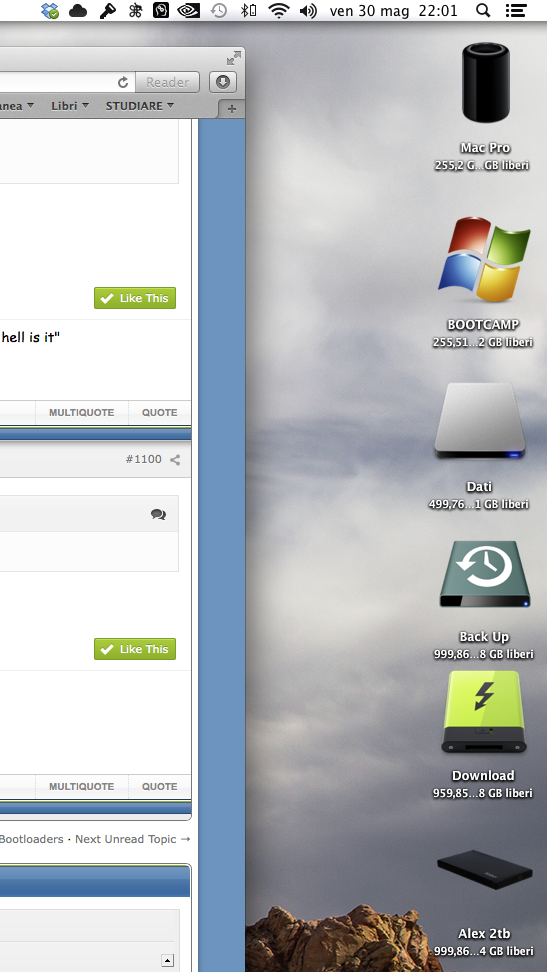

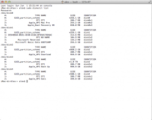

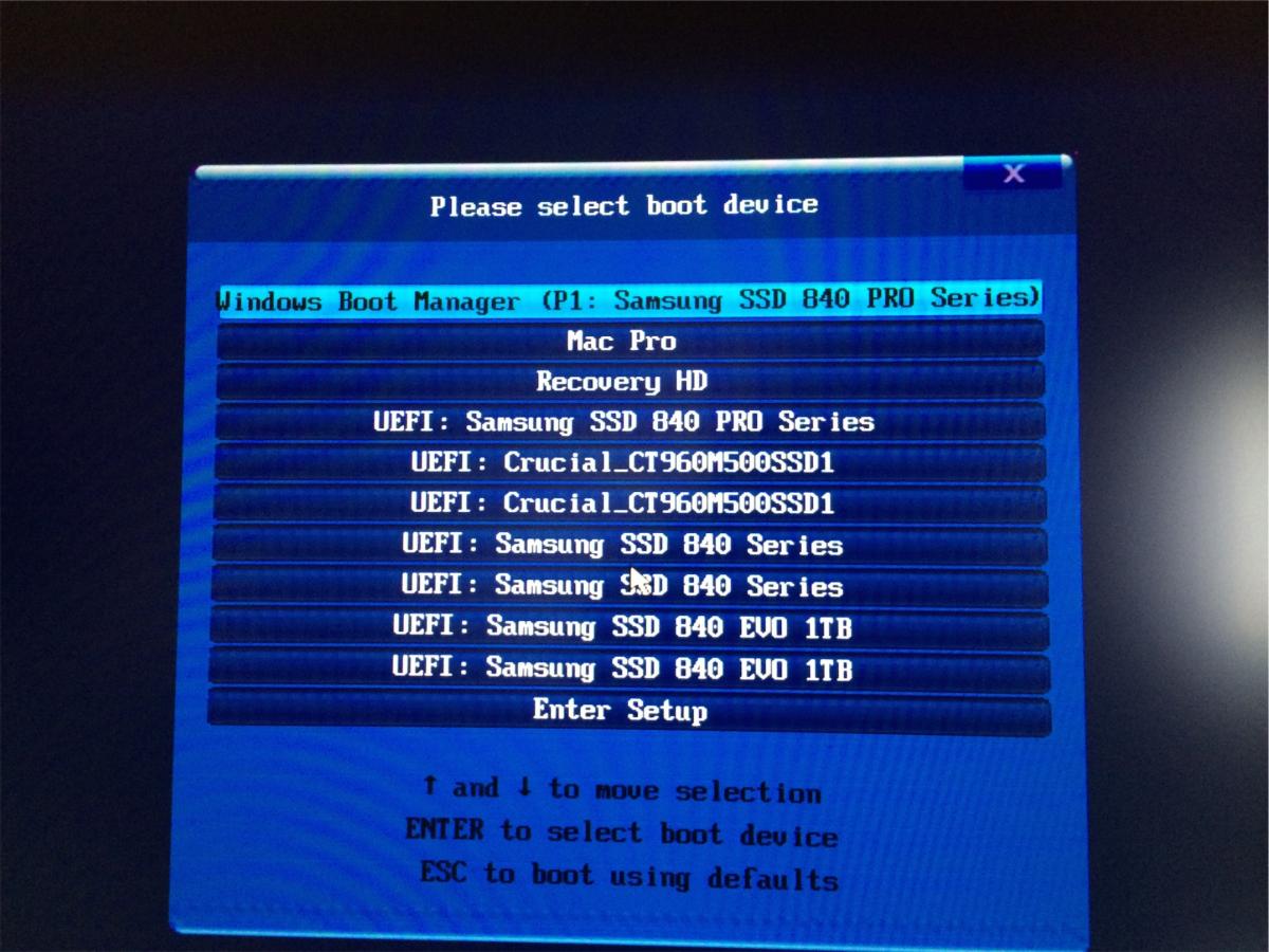

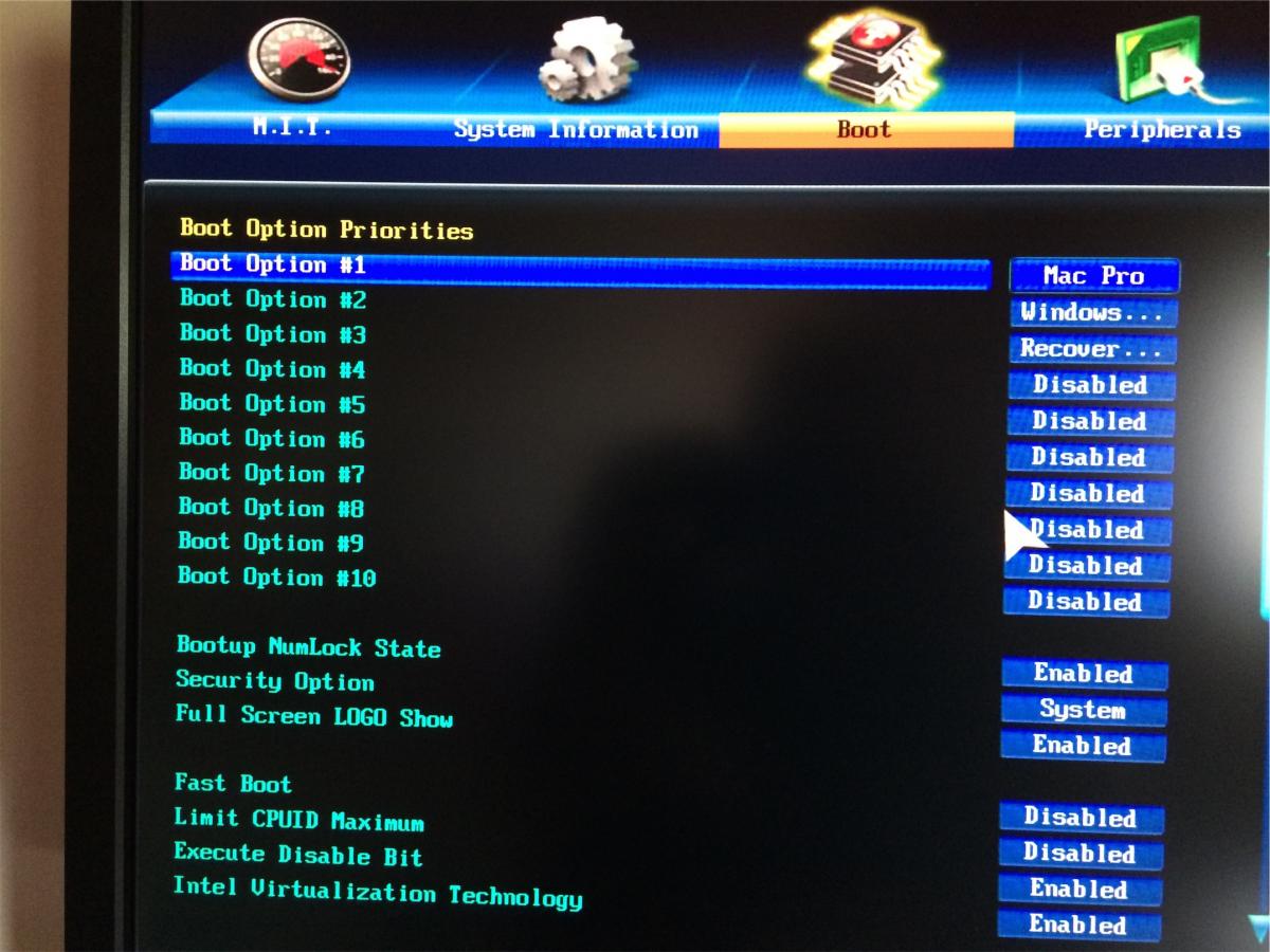

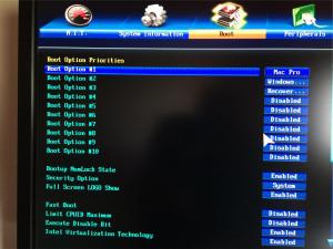

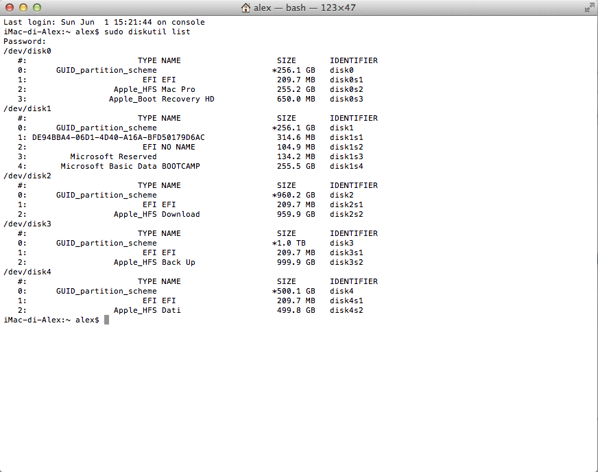

hi truesoldier. as you can see i have both windows 8.1 and mavericks 10.9.3 working on different ssd.
i have to use f12 boot menu selection to switch from one to another. from mac system preferences i don't see my windows disk (startup volume).
i had to install windows by disconnecting all the other ssd otherwise i couldn't start with the installation (error 0x80004005). this using both dvd or usb installation disk of windows 8.1 update1 msdn edition.
ps if i use the refind cd rom boot loader i can switch normally from mac to windows.

But i can't boot into Windows with select Startvolume. My install of Windows 8 (non UEFI) doesn't show up under select Startvolume.
When i try to install via Bootcamp, it restart then starts OSX and show Log of Kernel Panic

hi guys. could someone please show me how to add this argument on my osmosisdefault.plist?
argument: sudo nvram boot-args="nvda_drv=1"
crazy :huh:
can you make a screenshot from f12 boot menu and enter this in the terminal
sudo diskutil list
Use the F12 boot menu.
Blame Microsoft for this oversight, Windows 7, Windows 8 and Windows 8.1 all suffer from this issue when more than 1 GPT disk is present on system.
It cannot handle multiple ESP partitions, although part of the specifications.
ok, so this is the key. no solution for now. it depends on microsoft  :wallbash:
crazy :huh:
sudo diskutil list
here you are.
from windows bootcamp control panel (startup volume) i can see both mac osx disk and windows disk.
from mac osx control panel (startup volume) i can see only mac osx disk.
i think that the problem is related to microsoft, as someone posted here.
there is no way to install windows 8.1 if there is another gpt disk connected. this is the reason why i can install windows (in uefi gpt mode) only if the other gpt disks are disconnected.
i tried putting the windows disk on sata0 or on sata1, nothing changed. i tired using dvd install disk, usb install disk, nothing to do.
maybe should i first format all the disks, then install windows (with all disks connected) and then install mac osx 10.9.3?
here you are.
try to delete all the EFI partitions that you do not need maybe that help.
use this for example http://www.mede8erforum.com/index.php/topic,14019.0.html
good luck
