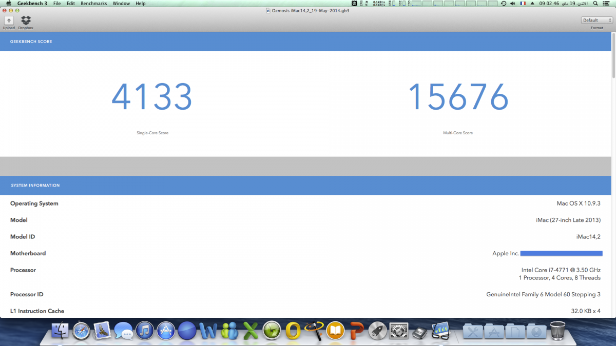

Here's the result of Geekbench with the latest DSDT mod  :yes: :     post-334538-0-31605200-1400487188_thumb.png
But i have one problem, CMOS reset on every boot, even if i have Patched AppleRTC.kext :wacko:  :huh:  :whistle: .
