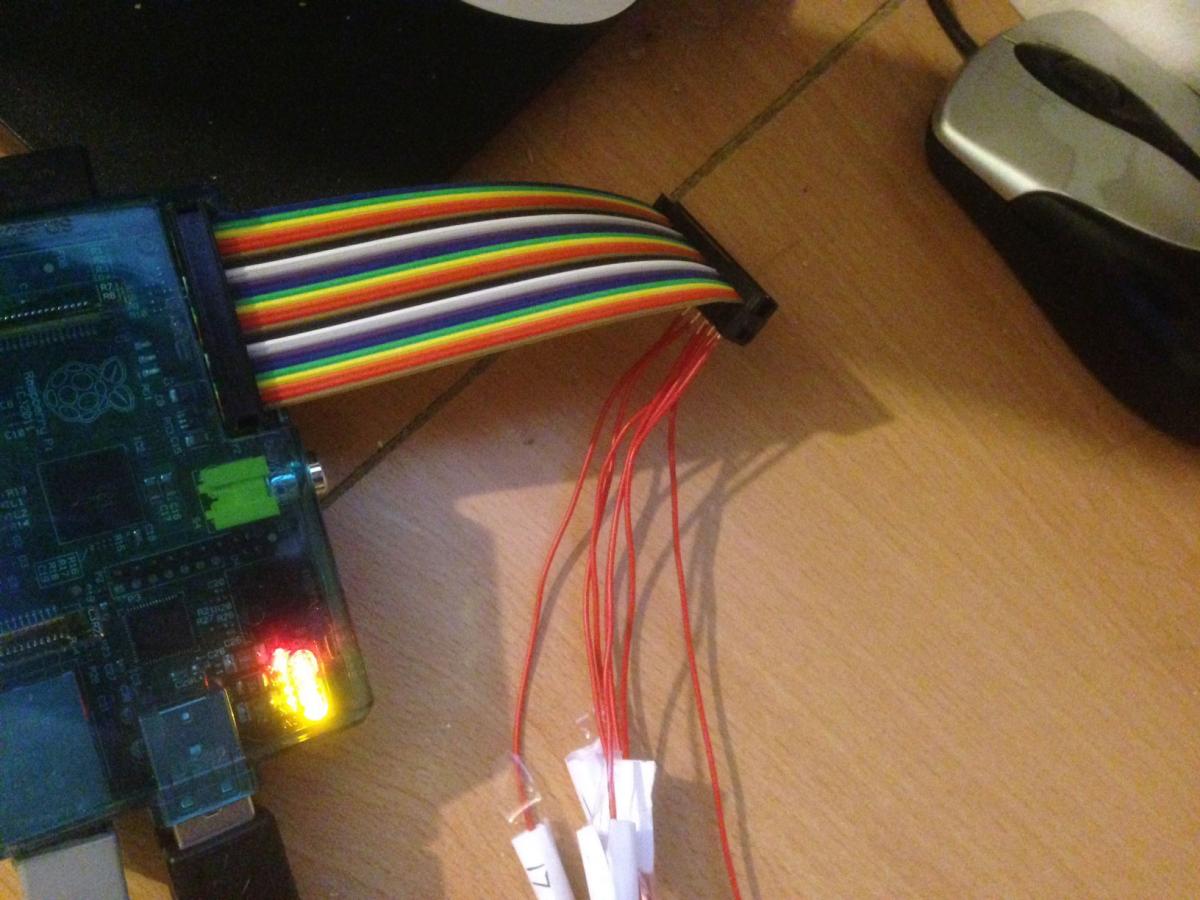

I set up the raspberry pi with pciutils and flashrom, then went about setting up the wiring to allow me to re-write my chip. It took two attempts.

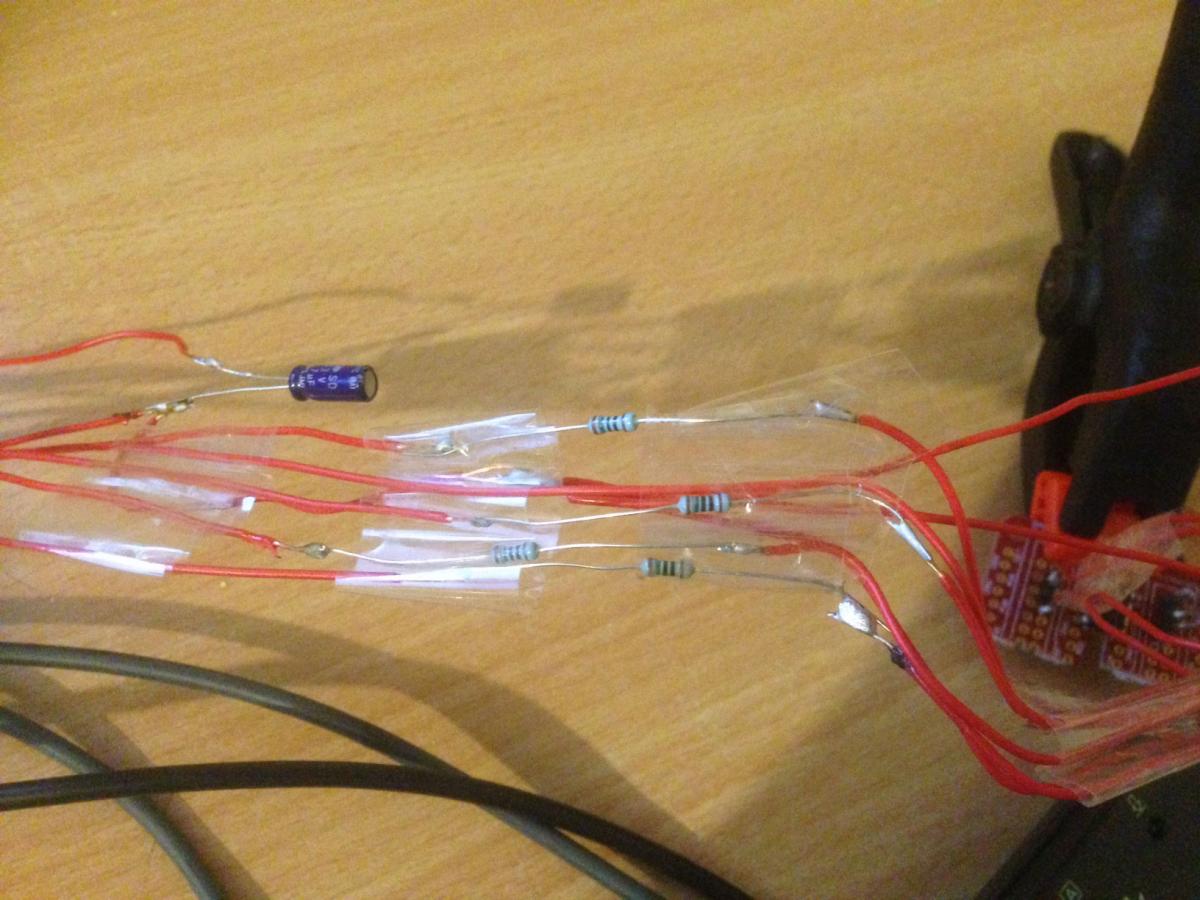

First, last night I soldered some wires, resistors and a capacitor and set up my raspberry pi with bios chip.
post-331032-0-76994500-1396218727_thumb.jpgpost-331032-0-76657200-1396218735_thumb.jpgpost-331032-0-48423300-1396218745_thumb.jpg

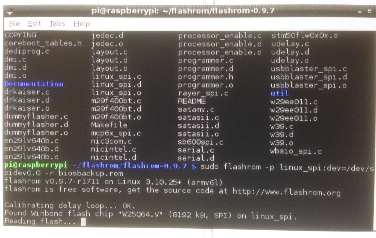

But my work was wrong somehow as flashrom failed.
sudo flashrom -p linux_spi:dev=/dev/spidev0.0 -r biosbackup.rom
flashrom v0.9.7-r1711 on Linux 3.10.25+ (armv6l)
flashrom is free software, get the source code at http://www.flashrom.org
Calibrating delay loop... OK.
Found Generic flash chip "unknown SPI chip (RDID)" (0 kB, SPI) on linux_spi.
This flash part has status NOT WORKING for operations: PROBE READ ERASE WRITE
The test status of this chip may have been updated in the latest development
version of flashrom. If you are running the latest development version,
please email a report to flashrom@flashrom.org if any of the above operations
work correctly for you with this flash part. Please include the flashrom
output with the additional -V option for all operations you tested (-V, -Vr,
-VE, -Vw), and mention which mainboard or programmer you tested.
Please mention your board in the subject line. Thanks for your help!
Read is not working on this chip. Aborting.

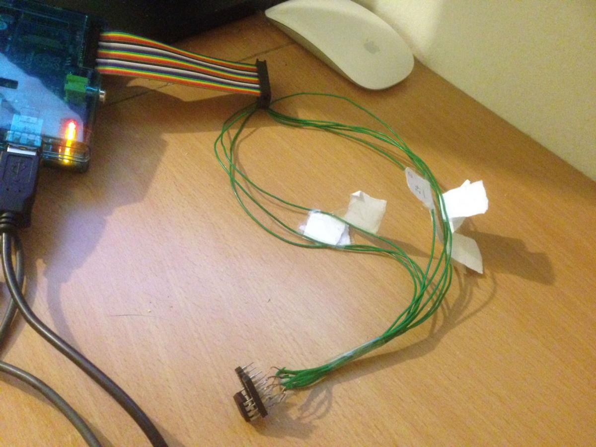

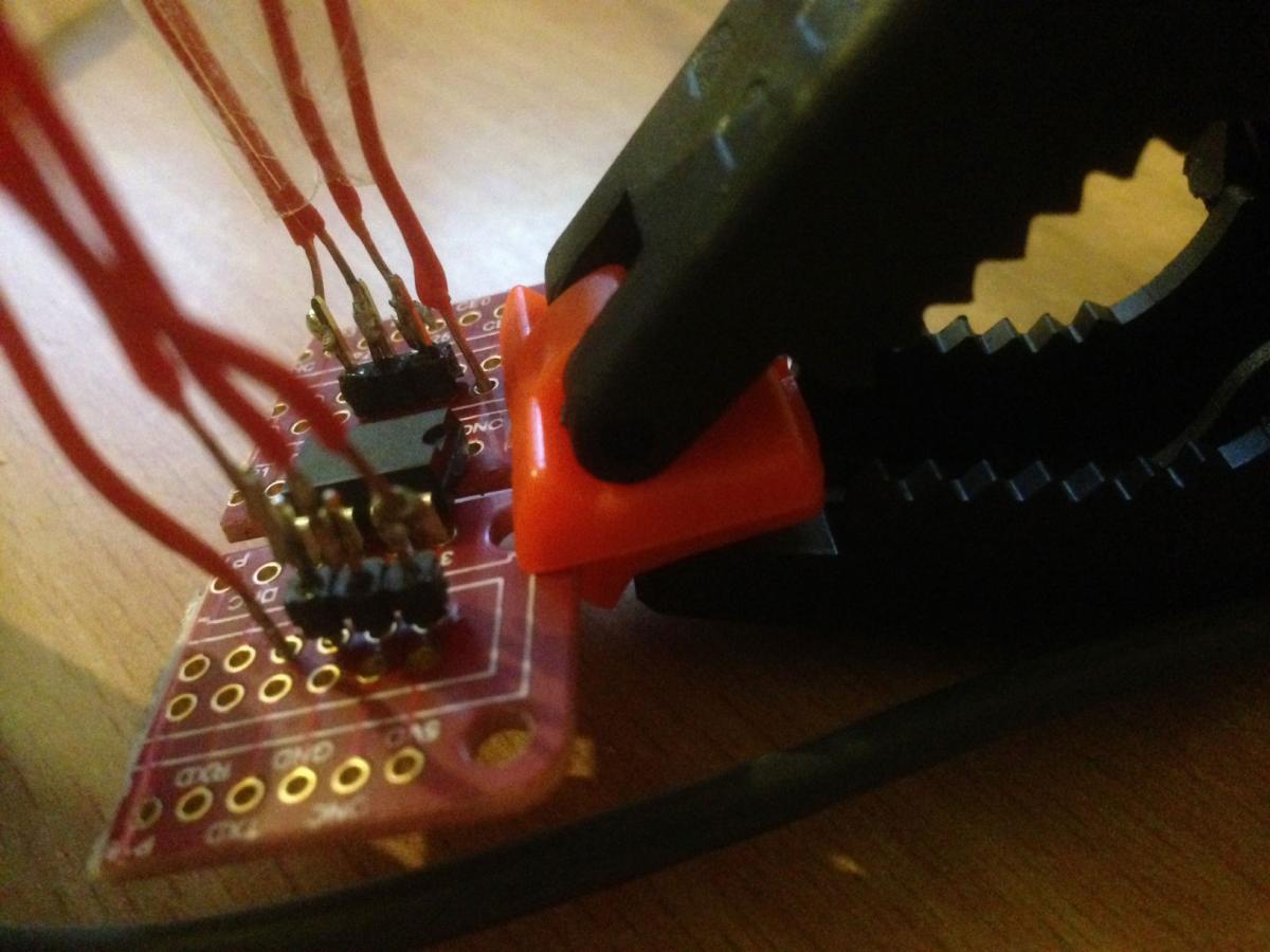

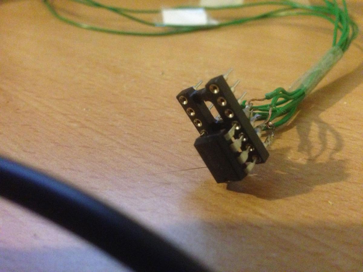

Take 2 - I woke this morning thinking I must have done something wrong and knew I should try again. So..
This time I did it without the resistors and capacitor as mentioned by coderush here
post-331032-0-27709000-1396218754_thumb.jpgpost-331032-0-10256000-1396218763_thumb.jpg
And bingo!
sudo flashrom -p linux_spi:dev=/dev/spidev0.0 -w ../../MaximusIV-GENE-Z-ASUS-3402-Patched.ROM -V
