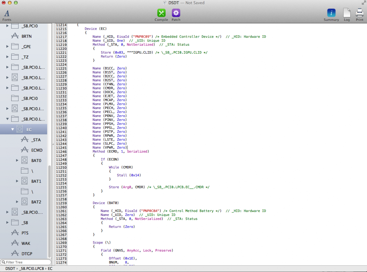

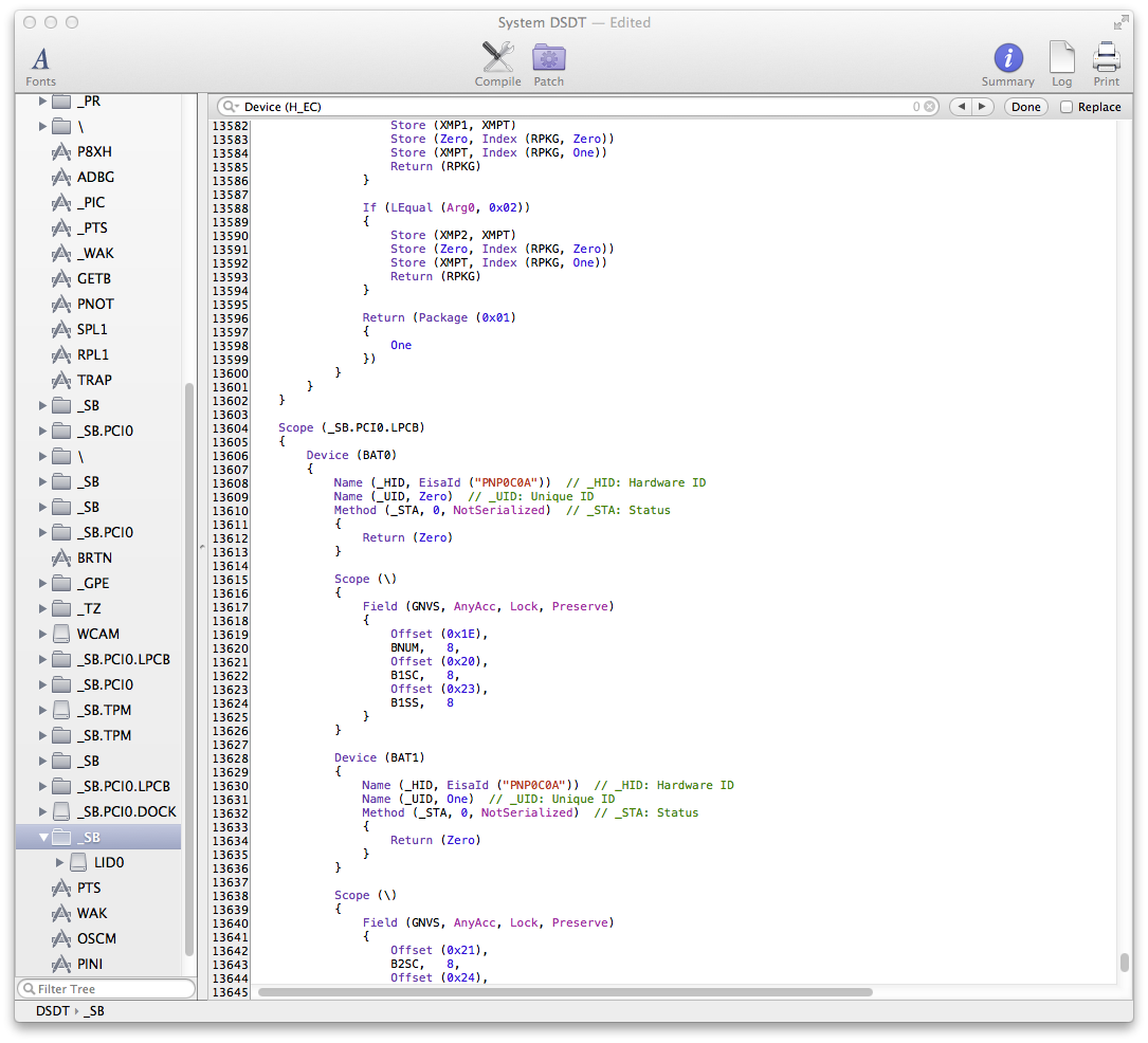

I don't know witch one of them to delete, but that i will need to use, is only the front panel USB Port's. And i don't use the TPM, so i don't know if i can delete it also, and i think the PCI-Express port 1 and 2 witch are in DSDT ( P0PA and P0PB) can be deleted also if i don't use the SLI "2 Graphics Cards":unsure:
delete EC device :yes:

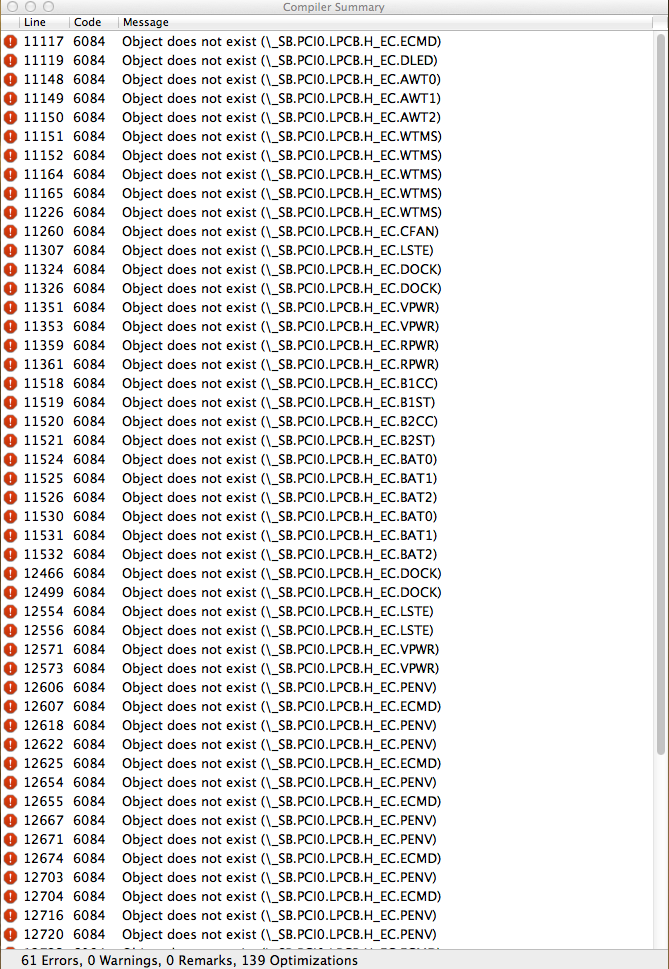

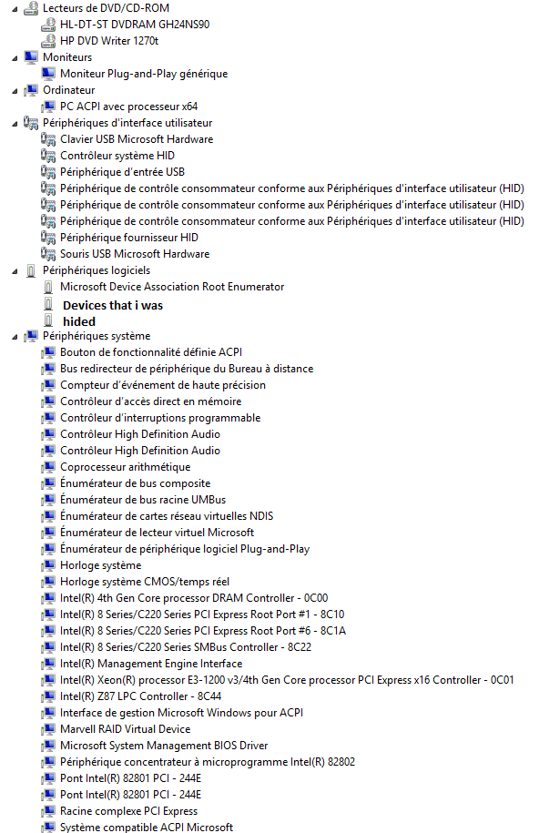

Ok! I see, in my board he's named Device (H_EC), but when i delete it, it generate more errors like that:
post-334538-0-24345000-1396375576_thumb.png     post-334538-0-22986200-1396375601_thumb.png
Thanks truesoldier for a fast reply!

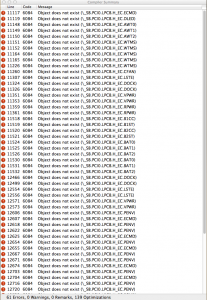

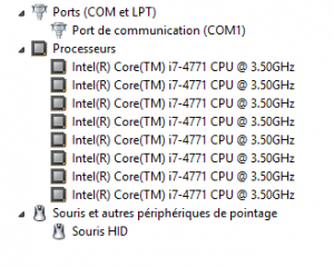

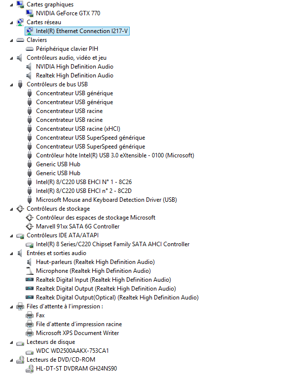

and all work great in windows and OSX.
U can play with other patches for this board but i have experienced some problems on windows side when using patches like " # 2. Rename GFX0 devices to IGPU
# 3. Rename device P0P2 to device PEGP"
all was working but wass having some red icon on "Microsoft ACPI-Compliant System"

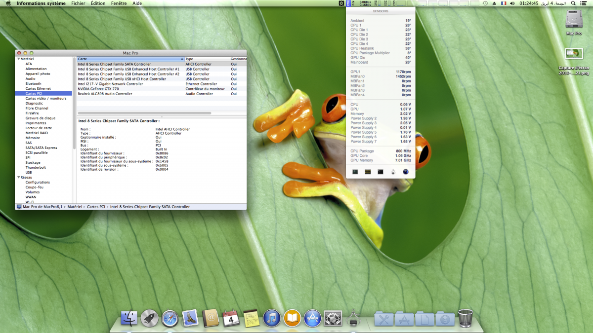

Hi friends! Here is my two systems all running without any issue!!! Gift from truesoldier  :yes:  :yes:  :yes:
After a full format of the two systems, my pc takes his breath to run both without any problems. So I'll play games on mavericks to know if its really works.
