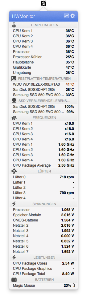

Although there are some Issues left your Patch does the job. My first attempt wasn't very successful so I decided to start all over again and build an all new ROM for my board. I replaced the the elder SMC related stuff with a recent version of FakeSMC and it´s plugins which I converted with kext2ffs and placed them into my Rom alongside to your patched version von OZ and apfs.ffs. Guess what I flashed that ROM, added an boot entry for high sierra via EFI shell (OZ still does not see APFS Volumes by it´s own) and it´s up and running :D

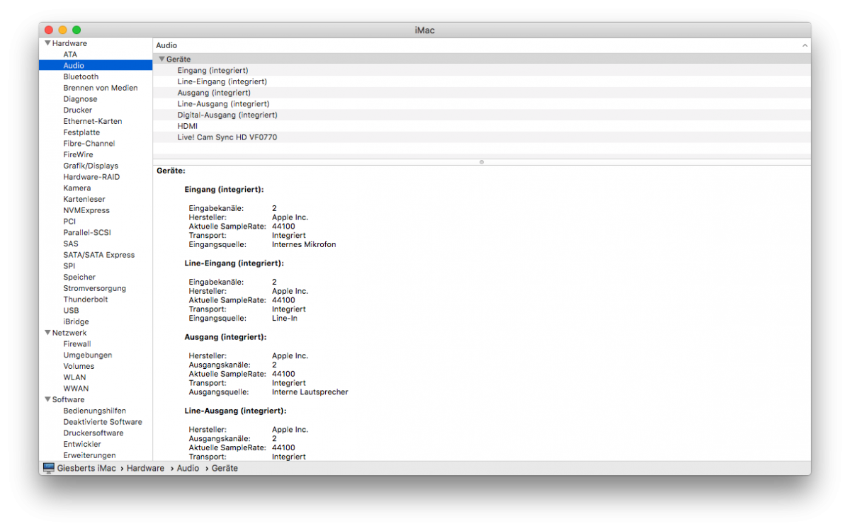

Loading Extensions from EFI also works as expected I load Lilu and AppleALC (OZ Flavored) from EFI...
And here is HWMonitor using the Sensors...

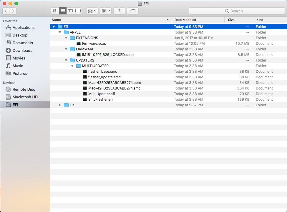

I'll just refresh as you said, after installing HS, now on the Apple folder in Efi, it has new folders added by the installer itself, and here's the result
My question is, before HS installation, we have to put it in both Efi partition: USB and HD install destination?

ammoune78 Wich sensors did you used to be able to finish installation with Oz?
Actually I use modified RehabMan HWSensors and I use them all! But will switch to an uploaded one from a friend, I just had no time before yesterday and yesterday and today, but know I will reflash this lovely board, because it accepted for my all Ozmosis stuffs and AppleALC, Lillu, my Updated Injector version after taken permission, and RTL8111 "GA-Z97M-DS3H  :wub:  "    :hysterical:

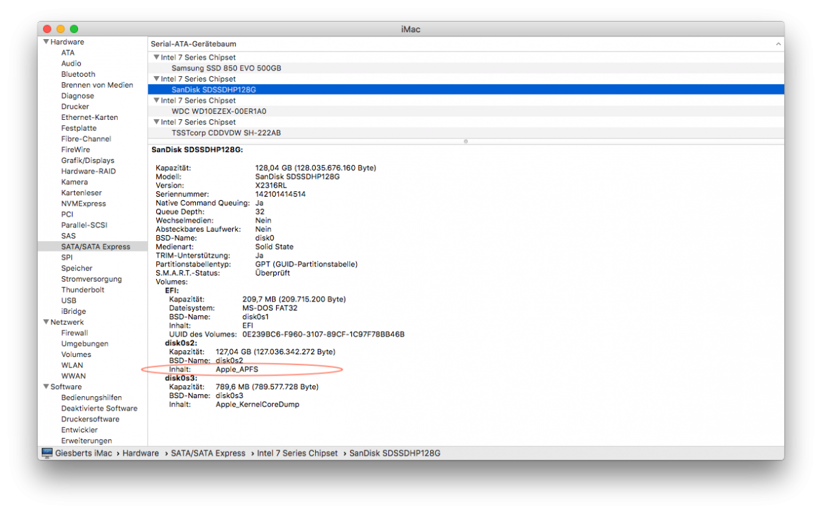

Didn't work, using the apfs2.ffs from cecekpawon did the trick.
If you think it's worth a try, I replace current pe32 image with apfs.efi
@craike ...
Thanks cecekpawon, with this one apfs2.ffs oz detect the APFS drives. You are the best!!!. :yes:
