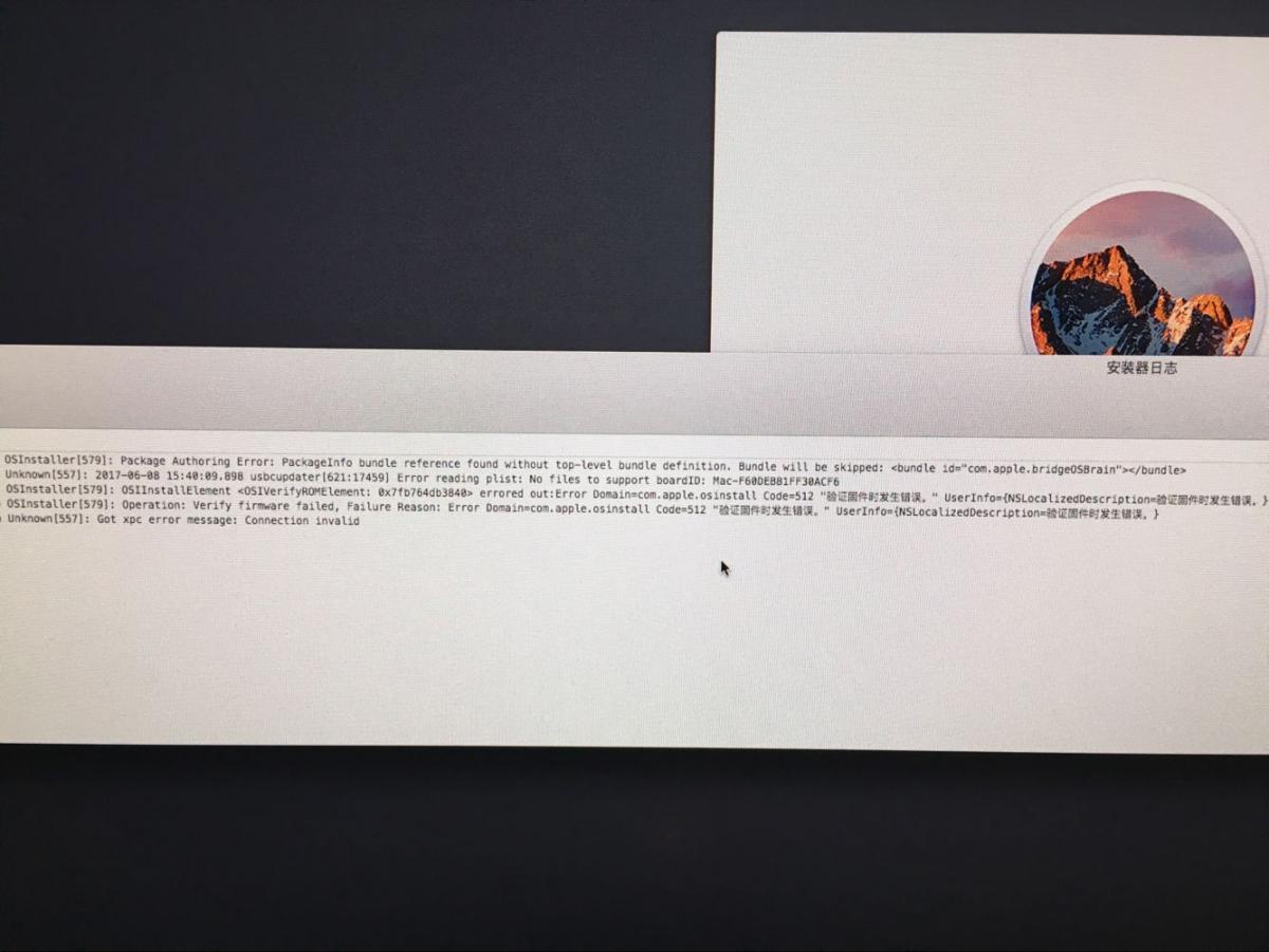

this is right,i'm fix it,but new error come here:
Error reading plist: No files to support boardID: Mac-F60DEB81FF30ACF6
Mac-F60DEB81FF30ACF6 is macpro 6,1

Im trying to install and getting this.

From your log:
Jun  8 15:11:39 Mac-Pro OSInstaller[579]: ROM Features failed to open IORegistryEntry!
Jun  8 15:11:39 Mac-Pro OSInstaller[579]: ROM does not support APFS
Jun  8 15:11:39 Mac-Pro storagekitd[580]: Bless of /System/Library/CoreServices failed with status 2
You have exact problem with this guy, please follow that thread / play more with FirmwareFeatures(Mask) values.
