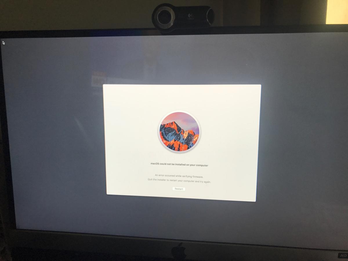

Im trying to patch type0->BiosSegment as suggested by bs0d to prevent firmware check error during installation.
Would that eliminate the need for FF & FFM in Defaults.plist ?
I built the rom image will test it after I am done with the russian method which failed with Apple Installer but might still work with Pacifist (under test atm)
@cecekpawon you´re the man :D
It works I write this from a freshly installed HighSierra Copy just using OZ :D
Well I think "Ooops you did it again" with a little help from @bsod pointing you in the right direction. OZ does now boot and install HighSierra like a breeze thank you for that :D

could someone point me to how I can update my smbios to date 05/01/2017 has the install as it showing verify ferm wear eeror
You're welcome my friend, you need also to change bios date, for example: iMac14,4 IM144.88Z.0179.B30.>170501<1718  red numbers are Bios Date and it will be: 05/01/2017, this is why in OzmosisDefaults we will set it like that:
Bios Date
05/01/2017
Bios Version
iMac14,4 IM144.88Z.0179.B30.1705011718

Hi, my hackintosh is ready for macOS 10.13 now and this is all I have done:
1. Update Ozmosis to cecekpawon's oz2a
2. Edit OzmosisDefaults
<key>BiosDate</key>
<string>05/01/2017</string>
<key>BiosVersion</key>
<string>IM141.88Z.0118.B46.1705011412</string>
<key>FirmwareFeatures</key>
<integer>0xE907F537</integer>
<key>FirmwareFeaturesMask</key>
<integer>0xFFFFFFFF</integer>
All done, no FakeSmc update necessary!
(I'm using SmcEmulatorKext with SMC-Version: 1.30f3)
Thanks very much  :thumbsup_anim:
