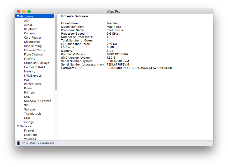

You dont need to increase your font except update your smc revision.
Jun  9 09:06:05 iMac Unknown[532]: 2017-06-09 09:06:05.725 smcupdater[595:19864] SMC RVUF Current version: 1.30f3
Jun  9 09:06:05 iMac Unknown[532]: 2017-06-09 09:06:05.725 smcupdater[595:19864] SMC RVUF New     version: 2.15f7
If you saw something like above, I think yes, its necessary to update your SMC rev

Do we need to modify smc version manually according to the smbios chosen for HS to install/boot?
What should be appropriate values for iMac14,2 and iMac15,1?
From FakeSMC Info.plist, delete Clover section, go to smc-compatible and change its value to smc-huronriver, now got to keys/REV change it's value with 02220F00 0016 repeat the same process for the RVBF and RVUF, put it on your BIOS or in Common folder of Oz. Now go to your OzmosisDefaults and SMBios section and change IM151.0207.xxx with IM151.0207.B26, update the iMac serials to the last one!
