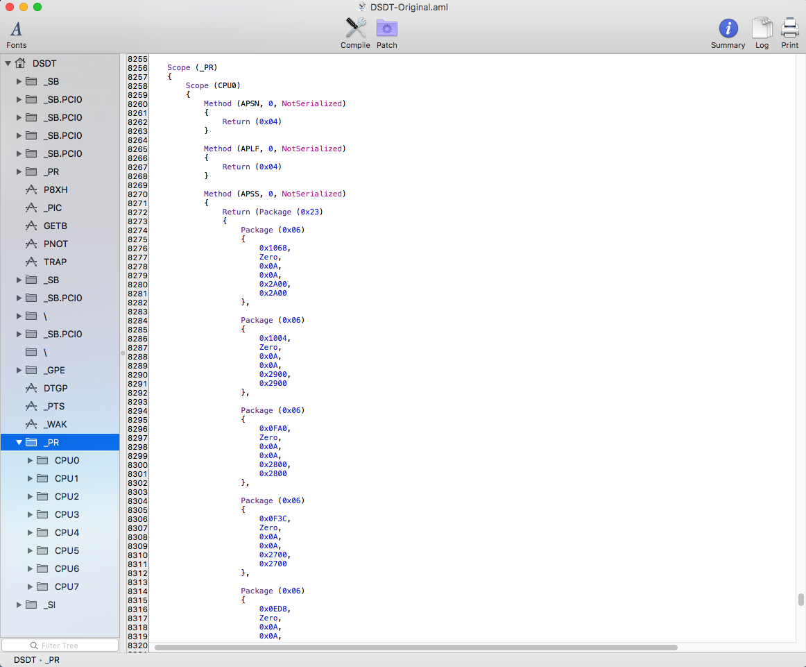

I have edited DSDT and SSDT with ssDtPrgen

Hi, followed your instructions (as well as this http://www.insanelymac.com/forum/topic/306744-ozmosis-uefi-bios-modding-guide/).Had to physically unplug my Windows drive as it automatically wanted to boot there. Now it automatically boots to Clover on my main RAID0 drive. When I boot from boot menu (F12) my main drive flashed with Apple logo and restarts. When I boot to my backup drive with Yosemite 10.10.5 it hangs on Apple logo and eventually after some time the screen turns black, but keyboard stays active (able to switch caps lock etc).
boot args in defaults.plist npci=0x2000 rootless=0 nvda_drv=1 -xcpm dart=0
DSDT.aml, SSDT.aml, SSDT-1.aml, SSDT-2.aml from RampageDev's latest X79.dmg (Also helped me to upgrade to MacOS Sierra using Clover) in Acpi/Load/
Bios Rom file has disabler.ffs, InjectorKext.ffs, CPUCensorsKext.ffs, GPUSensorsKext.ffs from your packaged also included + I used kext2ffs script to generate AppleInterE1000e.ffs for LAN port (and the bios rom file has still more free space available)
crash dump from last attempt

attached the new rom file and defaults.plist just in case.
Autocorrect was one of the first things I disabled on my iPhone  :D
x79up4oz-full.rom.zip
Defaults.plist.zip
1- If you plan to use it for Yosemite kext-dev-mode must be added in Defaults.plist.
2- If you plan to use NWebDriver nvda_drv=1 ok
3- You forgot to replace your MacPro 5,1 S/V:MP51.88Z.007F.B03.1010071432 with MP61.88Z.0116.B04.1312061508 for example and the productID also, BoardVersion and HardwareAdress with other BaseBoardSerial from another Generated Serial..
4- Need to delete Firmware Features as they cover only MP3,1 and Stock QUO Rom.
5- AAPL,ig-platform-id, DisableAtiInjection.
The ROM Attached is an Backup from running system generated from Bios or @Bios!
I've made an fresh new bios for your board from 1.0 Rev, try it with this just modified Defaults plist:
It's better for you to check the version number of your ITE Super I/O Chip in your Mobo and it's near the Rev:1.0 under Designed in Taipei, then extract from LpcSensors the raw image in raw or plist and open it with PlistEditor Pro or other one, check again if the chip is listed from the list.
Also the AmiBoardInfo.bin is not ROM protected so you can easily patch it and add it with Dsdt2Bios from FredWest app.

Do I need to copy SSDT-s to DSDT if I want to patch with dsdt2bios or should I keep them in load directory?
btw I have ITE, IT8728F which is present in LPCcensorsKext :-)
How many SSDTs you have, you just have to see in DSDT of QUO board you will see PR section on the bottom of Devices and Scopes, do it for your board as is in QUO DSDT, otherwise you will have KP. But prefer to keep it in Load!
Here's example from QUO DSDT screenshot: post-334538-0-34081700-1482255527_thumb.png, i prefer you to boot with only CPU SSDT and DSDT first from Load, if boot fine you can easily add the other SSDTs one by one until all worked without error or KP, then add DSDT in Bios.
It's good to try first from Efi\Oz, to don't take to much time flashing and reflashing.
Here's example from QUO DSDT screenshot: attachicon.gifQUO SSDTinDSDT.png, i prefer you to boot with only CPU SSDT and DSDT first from Load, if boot fine you can easily add the other SSDTs one by one until all worked without error or KP, then add DSDT in Bios.
I'm quite a noob when it comes to patching DSDT-s and SSDT-s. I looked at my DSDT and the PR section was not present, almost like it is written in another specification. Attached my files, maybe you can give it a look  ^_^
X79-up4-i7-3820-nvidia-dsdt_ssdts-rampagedev.zip
I forgot to download the File from OS X, this is why you will see: 2 Downloads one from Windows one the second from OS X, and I forgot to don't download it!
Sorry so I can't touch it without an LSPCI -nn from linux for Device ID's and iORegistryExplorer dump for where the Devices are placed. Then I can go to the devices and put the patch, remember that putting DSDT inside bios have to support both OS X and Windows to avoid BlueScreens.
i only use the IORegistryExplorer from AppleDevelopper, download it, open it and simply save file as then upload it, for lspci -nn just from Ubuntu live DVD, and once on the desktop open up terminal and write lspci -nn then copy the result to txt file and your done!
Anyway:
Try this Patched DSDT with SSDT, HDEF, GFX0, HDAU, SMB, SBRG, SATA, GBE, DTGP, OSDW and Darwin added to it: Patched GA-X79UP4-F7 Rev1.0 DSDT_SSDT.aml.zip, so if you want to use it don't add something in Load just this one, I prefer you to boot with only one drive in SATAs port and save a Profile in bios with only the drives that you plan to use with OS X to avoid KickingA*s of EFI partition of Windows drive.
