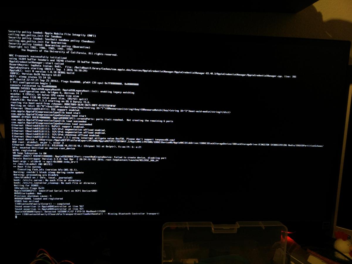

And I just want to see the verbose, because your configuration should be working! Otherwise I will suspect some Bios setting should be changed!
The essentials one are: VT-d disabled, SATA to AHCI, XHCi as Auto Eeproms as UEFI only, I disable CSM, I enable LPCB ITE8620E options.
Intel GFX0 as first
AMD as Second
But I still need Verbose screenshot!
vt-d disabled? it was enabled all the time on my mobo. so i will check the bios and take picture of verbose
So here it is
Edited by Morc
So here it is

I see in boot-args nvda_drv=1 use it only for Installed NvidiaWebDriver, otherwise it will not let you reach Desktop!

I edited he's OzmosisDefaults with csr-active-config 127, but the Verbose picture isn't clear enough, so I see maybe npci -0x3000 instead of npci=0x3000, and the one I did doesn't have npci -0x3000! can you confirm it please?
Edited by ammoune78
It is ncpi=0x3000 but i will try new dsdt tommorow
Instead of installing El Capitan, Sierra is better I think, but it's your choice, because you boot Without changing EHC1 and 2 to EH01 and 2! You can ether try the npci=0x2000!

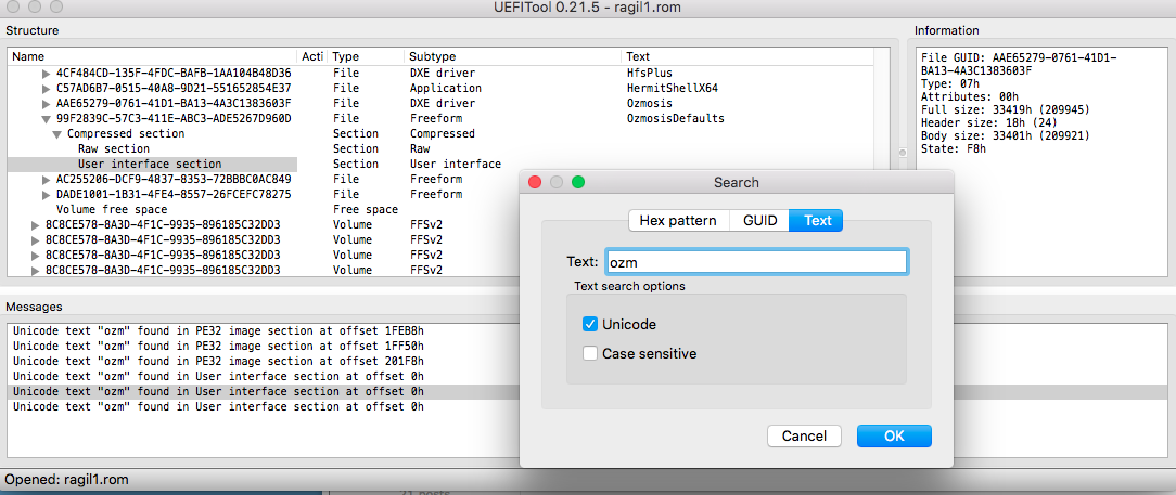

First one on the bios:
1 - Download UEFITool from the first post
2 - Open your bios file with UEFITool
3 - Click the triangle in the left side until you see 3 modules
4 - Click by the same way on the Second module
5 - Continue clicking until you see Too much modules
6 - Go down until you see OzmosisDefaults
7 - Now click two times on its triangle and you will see Raw
8 - Right click on this raw choose from the menu Replace as is
9 - Choose your OzmosisDefaults.raw and Save your BiosImage. reset nvram and flash your Mobo
Second one easiest way but don't format your Efi partition to have it work continuously
You only have to rename the OzmosisDefaults....raw to Defaults.plist and that's all
Best thing is to try the defaults.plist on efi partition with different setting until done, if all appear to be ok, then rename it as OzmosisDefaults.raw, put it in bios and go flash it!
Edited by ammoune78
