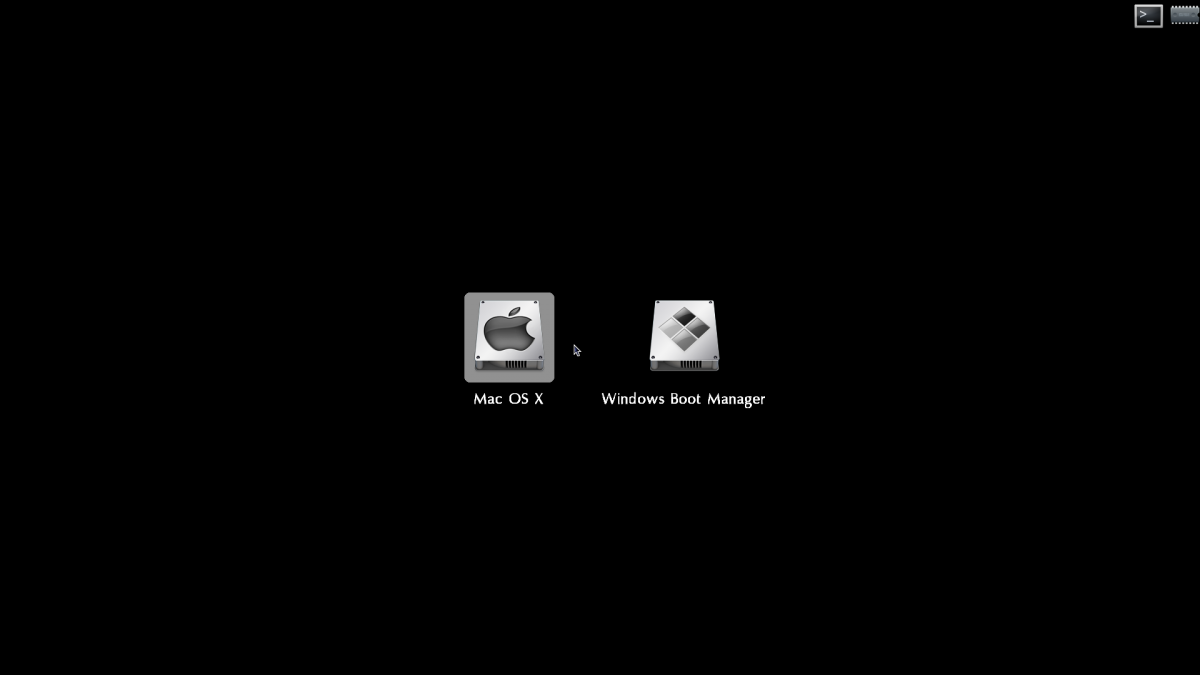

Anyone know if Refind is compatible with Oz? I was up all night trying to boot other Os's without luck. Seems like only Capitan and OS X will load up. Ubuntu, shell, Memtest all give me black screen. Maybe it's not compatible. Thanks.

why would you use Refind ? pointless excercise imho.
Because I could never get the Hermit Shell icon on the boot menu working, and that refind has icons preset for memtest, windows and apple recovery, restart and shutdown icons, recognizes my ubuntu installs, has an icon for efi shell, and i find it a little more customizable. I mean dont get me wrong the Oz xmas boot menu is nice and have no complaints with using it. Thanks.
Because I could never get the Hermit Shell icon on the boot menu working...
Use motherboard built-in boot manager for shell then...
I doubt someone will care enough to make refind work, especial b/c is not necessary.
I remember I told you that icon form Oz theme is for built-in firmware EDK1 shell and that is HermitShell you can find in AOS X-MASS release, if you try to use it for something else it will not work...
I guess I'll use bcfg to create a direct link to hermit shell because despite including that module in my bios and getting a boot menu item created for hermit shell by oz I can't get it to run. Not a biggy. Thanks.

 I mean if I click the EDK2  Shell icon nothing happens.
But if you start HermitShell(Built-In EDK Shell) from F12 menu works?
No HermitShell does not load even from F12. It use to work on the last release of OZ but stopped working on xmas release. I used Ozmtool to transfer the new modules over. I suspect maybe either the acpi configuration, dsdt, or defaults file is to blame.

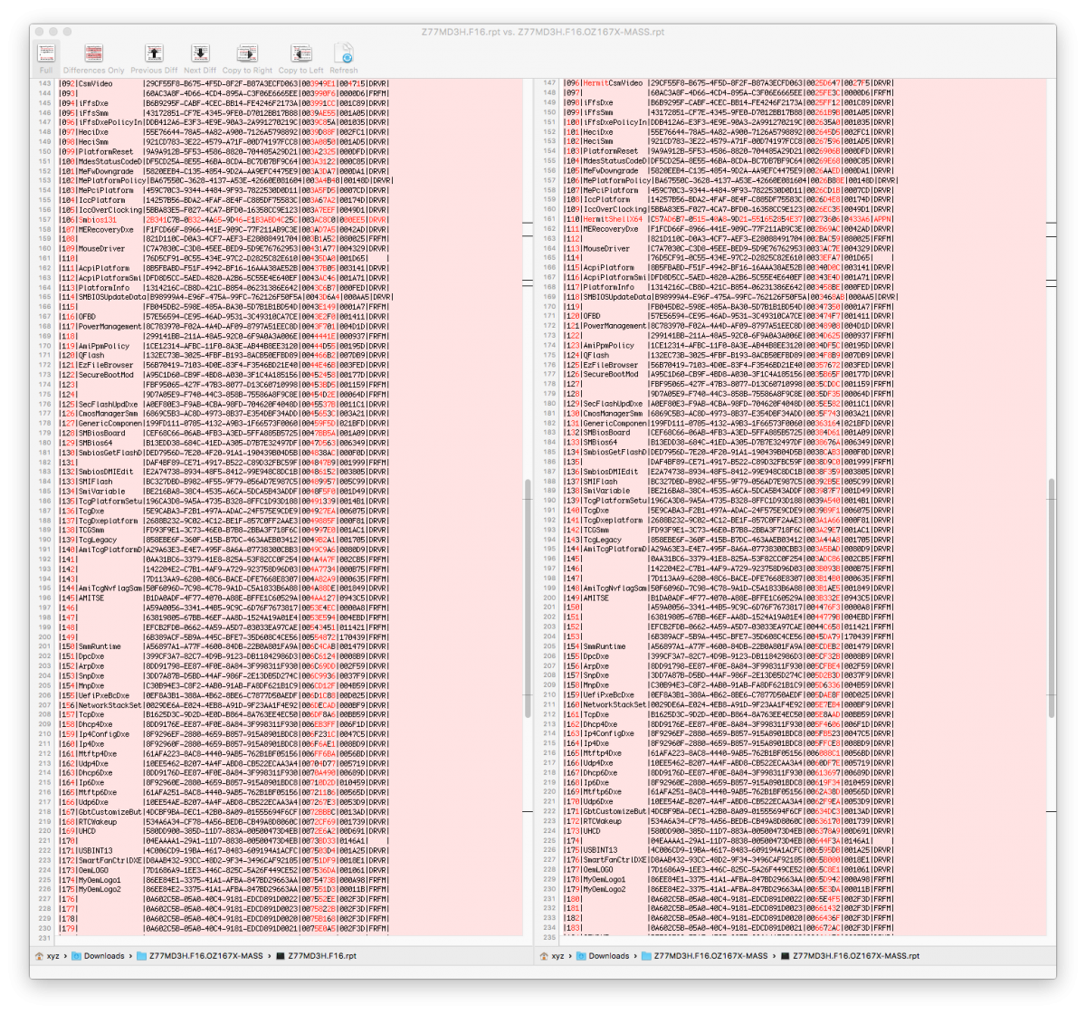

what modules should i delete to obtain extra space in the MB's rom?
if i removed some legacy ones is my BIos going to beep?(i mean something like Csr ones)
If you bother to read what I said/look on example I uploaded, you will find the answer, all you need is to spend few minutes and compare files like I did:
There is no "Csr" in your BIOS, if you look on released AOS BIOS you will find more that you can delete compared with stock Gigabyte BIOS...
How do i compare Z87 BIOS to Z77 one? they will definitely have conflicts.
Where do I said to compare with Z87?
I said to compare original AOS(Gigabyte) BIOS with Hermit released one, that way you can easy see what was removed/replaced.
And anyway there isn't much diff b/w Z77/Z87 firmware, only on APTIO V there are, but again you need to look/seek for answers to know that...
