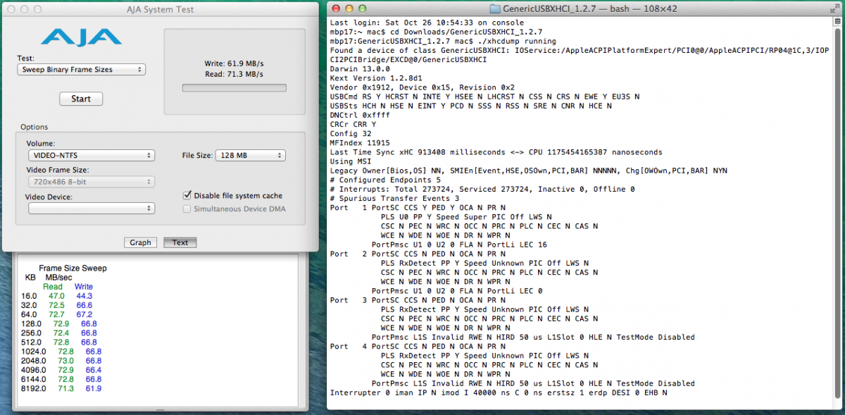

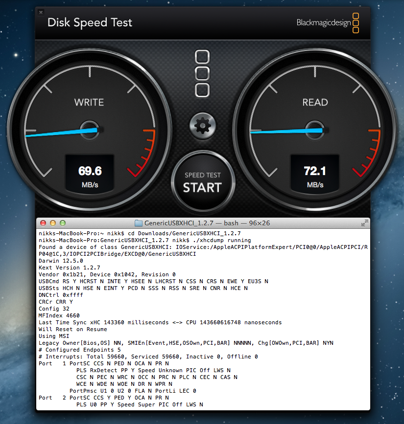

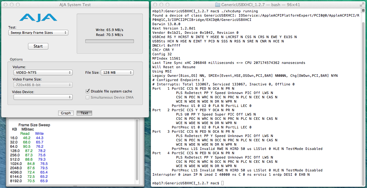

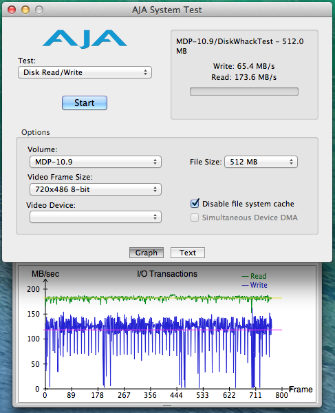

nikk Posted October 26, 2013 Share Posted October 26, 2013 It's the counter as described in #420. Try this workaround. Just WOW! Now it finally works on 10.9. It even outperform my NEC in BOT mode (same disk and AJA settings). p.s. I experimented with CalDigit USB 3.0 driver on 10.9. There is interesting message about maximum block size and transformations yn syslog on disk / driver load: 26.10.13 10:38:39,000 kernel[0]: USBMSC Identifier (non-unique): AA010812120130293276 0x781 0x5580 0x10, 2 26.10.13 10:38:39,000 kernel[0]: USBF: 710. 94 Endpoint 0x81 of the USB device "Extreme" at location 0xfe100000: converting Bulk MPS from 1024 to 512 (USB 2.0 Spec section 5.8.3) 26.10.13 10:38:39,000 kernel[0]: USBF: 710. 94 Endpoint 0x2 of the USB device "Extreme" at location 0xfe100000: converting Bulk MPS from 1024 to 512 (USB 2.0 Spec section 5.8.3) so, they somehow change that values from driver itself without USBFamily modification. Link to comment https://www.insanelymac.com/forum/topic/286860-genericusbxhci-usb-30-driver-for-os-x-with-source/page/18/#findComment-1958614 Share on other sites More sharing options...
Zenith432 Posted October 26, 2013 Author Share Posted October 26, 2013 Can you please test it on a UAS drive so we can see if ASM1042 still needs "broken streams" errata before I check this in? Thanks. (Note: UAS is not disabled on ASM1042 in this build) Just WOW! Now it finally works on 10.9. It even outperform my NEC in BOT mode (same disk and AJA settings). Link to comment https://www.insanelymac.com/forum/topic/286860-genericusbxhci-usb-30-driver-for-os-x-with-source/page/18/#findComment-1958617 Share on other sites More sharing options...
nikk Posted October 26, 2013 Share Posted October 26, 2013 Can you please test it on a UAS drive so we can see if ASM1042 still needs "broken streams" errata before I check this in? Thanks. (Note: UAS is not disabled on ASM1042 in this build) Already done. I set <key>DisableUAS</key> <false/> And card not detected on boot. If I plug drive on live system with detected ASM1042 it silently disappears from system without any errors (PCI bus reconnect). But, with disabled streams <key>DisableUAS</key> <true/> it works fine with UAS enclosure. Even faster than NEC with 5 endpoints on small transfers. Maybe with SSD we'll se the streams win on NEC ;-) I think it's better to leave it disabled for ASM1042 but with ability to turn it on with Info.plist key <key>DisableUAS</key> <false/> (for tests). Maybe, if we'll find a way to enable it on 10.9, it will work without transfer errors. I see spurious transfer events with UAS on NEC but it doesn't affect usage. Do you need performance tests about max linear transfers on this cards (I can try it with UAS + SSD later)? p.s. Can't test it on 10.8.5: 26.10.13 12:00:47,474 com.apple.kextd[12]: Failed to load /System/Library/Extensions/GenericUSBXHCI.kext - (libkern/kext) link error. 26.10.13 12:00:47,000 kernel[0]: kxld[net.osx86.kexts.GenericUSBXHCI]: The super class vtable '__ZTV17IOUSBControllerV3' for vtable '__ZTV14GenericUSBXHCI' is out of date. Make sure your kext has been built against the correct headers. 26.10.13 12:00:47,000 kernel[0]: kxld[net.osx86.kexts.GenericUSBXHCI]: The super class vtable '__ZTV12IOUserClient' for vtable '__ZTV24GenericUSBXHCIUserClient' is out of date. Make sure your kext has been built against the correct headers. 26.10.13 12:00:47,000 kernel[0]: kxld[net.osx86.kexts.GenericUSBXHCI]: The super class vtable '__ZTV17IOUSBControllerV3' for vtable '__ZTV14GenericUSBXHCI' is out of date. Make sure your kext has been built against the correct headers. 26.10.13 12:00:47,000 kernel[0]: kxld[net.osx86.kexts.GenericUSBXHCI]: The super class vtable '__ZTV12IOUserClient' for vtable '__ZTV24GenericUSBXHCIUserClient' is out of date. Make sure your kext has been built against the correct headers. 26.10.13 12:00:47,000 kernel[0]: Can't load kext net.osx86.kexts.GenericUSBXHCI - link failed. 26.10.13 12:00:47,000 kernel[0]: Failed to load executable for kext net.osx86.kexts.GenericUSBXHCI. 26.10.13 12:00:47,000 kernel[0]: Kext net.osx86.kexts.GenericUSBXHCI failed to load (0xdc008016). 26.10.13 12:00:47,000 kernel[0]: Failed to load kext net.osx86.kexts.GenericUSBXHCI (error 0xdc008016). Link to comment https://www.insanelymac.com/forum/topic/286860-genericusbxhci-usb-30-driver-for-os-x-with-source/page/18/#findComment-1958620 Share on other sites More sharing options...

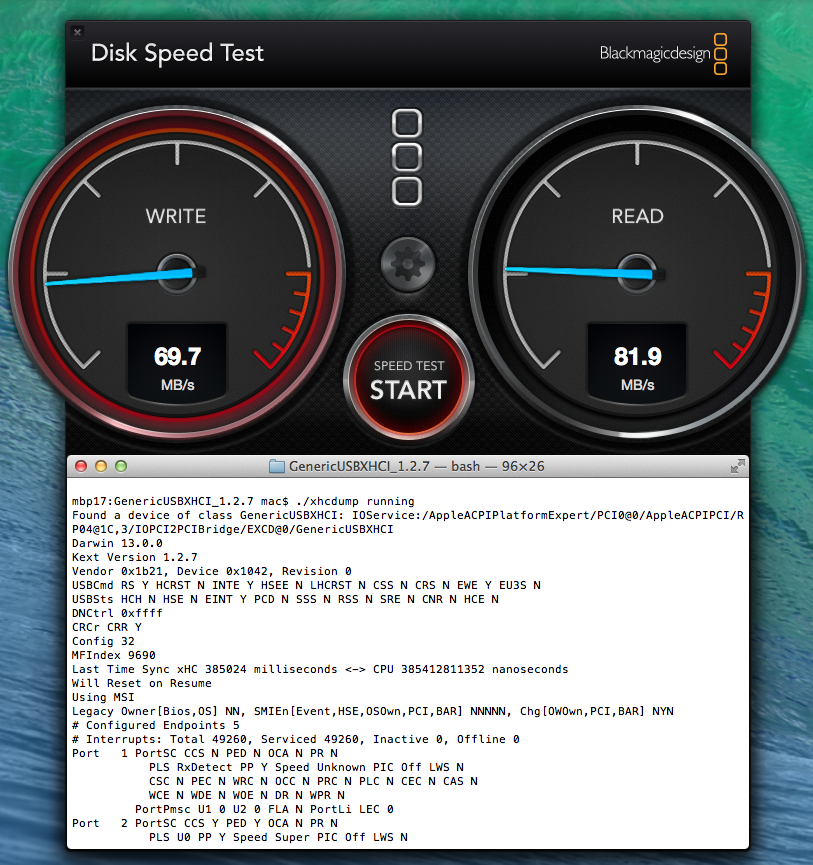

b0rnav Posted October 27, 2013 Share Posted October 27, 2013 I can also confirm that my previous (file read/write error issue) which actually turned out to be sourcing form the ASM controller is now resolved. Thanks Zenith432 for the hard work! Also surprising that the ASM controller is actually faster than the Intel... Link to comment https://www.insanelymac.com/forum/topic/286860-genericusbxhci-usb-30-driver-for-os-x-with-source/page/18/#findComment-1959174 Share on other sites More sharing options...
