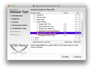

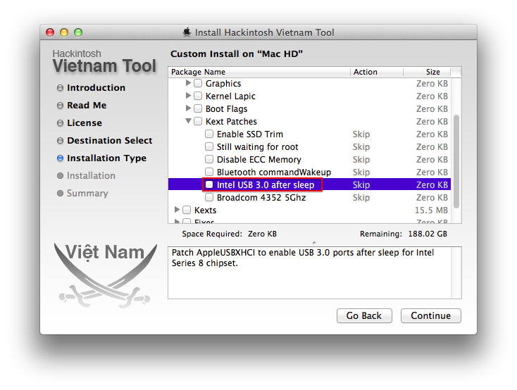

eivinds Posted March 10, 2014 Share Posted March 10, 2014 "Note 3: Some Intel Series 7 motherboards have a hardware issue that causes instant-wakeup when put to sleep. Use '-gux_defer_usb2' to resolve this." This sounds like my problem, but did not solve it on my 8-series z87x. It would be cool with any tips further on. In my syslog, I have Wake reason: XHC And references to a USB2.0 Root hub Simulation being disconnected, causing the wake up. This problem persists even with no devices attached to the computer. Link to comment https://www.insanelymac.com/forum/topic/286860-genericusbxhci-usb-30-driver-for-os-x-with-source/page/21/#findComment-2002782 Share on other sites More sharing options...
Allan Posted March 10, 2014 Share Posted March 10, 2014 try this: Download the app Hackintosh Vietnam Tool 1.5.4 Link to comment https://www.insanelymac.com/forum/topic/286860-genericusbxhci-usb-30-driver-for-os-x-with-source/page/21/#findComment-2002816 Share on other sites More sharing options...
pokenguyen Posted March 10, 2014 Share Posted March 10, 2014 "Note 3: Some Intel Series 7 motherboards have a hardware issue that causes instant-wakeup when put to sleep. Use '-gux_defer_usb2' to resolve this." This sounds like my problem, but did not solve it on my 8-series z87x. It would be cool with any tips further on. In my syslog, I have Wake reason: XHC And references to a USB2.0 Root hub Simulation being disconnected, causing the wake up. This problem persists even with no devices attached to the computer. Patch your dsdt to add clock-id for USB and XHCI to prevent waking up by USB. If you use Clover, set Devices > USB Inject + Add ClockID. Link to comment https://www.insanelymac.com/forum/topic/286860-genericusbxhci-usb-30-driver-for-os-x-with-source/page/21/#findComment-2002849 Share on other sites More sharing options...
Allan Posted March 10, 2014 Share Posted March 10, 2014 after you follow these tips, add this arguments in Clover: -gux_defer_usb2 -gux_no_idle Link to comment https://www.insanelymac.com/forum/topic/286860-genericusbxhci-usb-30-driver-for-os-x-with-source/page/21/#findComment-2002853 Share on other sites More sharing options...
