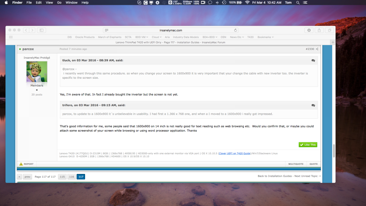

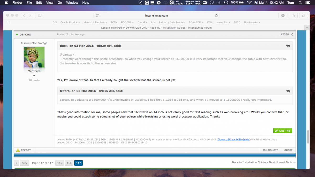

parcox Posted March 4, 2016 Share Posted March 4, 2016 @parcox - i recently went through this same procedure. so when you change your screen to 1600x900 it is very important that your change the cable with new inverter too. the inverter is specific to the screen size. Yes, I'm aware of that. In fact I already bought the inverter but the screen is not yet. parcox, to update to a 1600x900 it´s unbelievable in usability. I had first a 1.366 x 768 one, and when a I moved to a 1600x900 i really got impressed. That's good information for me, some people said that 1600x900 on 14 inch is not really good for text reading such as web browsing etc. Would you confirm that, or maybe you could attach some screenshot of your screen while browsing or using word processor application. Thanks Link to comment https://www.insanelymac.com/forum/topic/285678-lenovo-thinkpad-t420-with-uefi-only/page/94/#findComment-2220547 Share on other sites More sharing options...
tluck Posted March 4, 2016 Share Posted March 4, 2016 @parcox - glad you knew about that. thats a detail that could get overlooked! good news is you can always use a lower res 1368x768 1600x900 @nhoc_maruko9x - its my understanding that the USB3 on the T420s is not Intel or Fresno Logic based chipset - so i don't know of a good solution on El Capitan. @scoobaspeaz - using a real mac or hack to download and create the USB is the easiest way for sure. do you know anyone with a mac? Otherwise, the virtual machine route may be the best way. About 4 years ago i created a snow leopard VM from a $29 DVD i bought from the apple store! now the OS is free but harder to get. 1 Link to comment https://www.insanelymac.com/forum/topic/285678-lenovo-thinkpad-t420-with-uefi-only/page/94/#findComment-2220558 Share on other sites More sharing options...

Somez Posted March 4, 2016 Share Posted March 4, 2016 I'm running El Capitan, my T420s recognizes USB 3.0 port only if I plug the usb before the laptop booted up. Also if the usb is still plugged in, laptop can't be shutdown. Any idea how to fix that? I remember there's no problem with Yosemite. 1600x900 on 14" is pretty good actually. But it all depends on your vision. Like my company provided 14" Dell is FullHD and I'm not comfortable with that resolution. Link to comment https://www.insanelymac.com/forum/topic/285678-lenovo-thinkpad-t420-with-uefi-only/page/94/#findComment-2220577 Share on other sites More sharing options...
trifero Posted March 4, 2016 Share Posted March 4, 2016 1600x900 on 14" is pretty good actually. But it all depends on your vision. Like my company provided 14" Dell is FullHD and I'm not comfortable with that resolution. If it´s not native resolution, it´s {censored}. At least, that´s my experience trough the years…. Link to comment https://www.insanelymac.com/forum/topic/285678-lenovo-thinkpad-t420-with-uefi-only/page/94/#findComment-2220585 Share on other sites More sharing options...

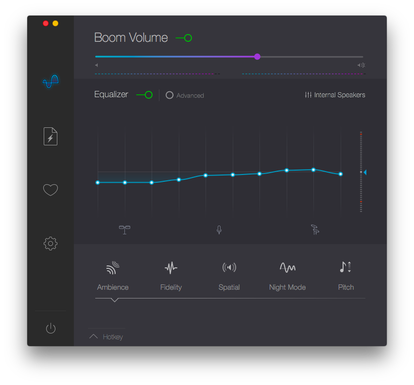

Zeridialous Posted March 6, 2016 Share Posted March 6, 2016 For those of you who find the T420's speakers to be quiet and muddy sounding I wanted to share this -- there's an app called Boom 2 that lets you boost the volume and apply a system wide equalizer, Ive been messing around with the settings and with the settings in the below screenshot it seems to have definitely helped. EDIT: Helps if I attach the screenshot... *facepalm* Link to comment https://www.insanelymac.com/forum/topic/285678-lenovo-thinkpad-t420-with-uefi-only/page/94/#findComment-2221111 Share on other sites More sharing options...

trifero Posted March 7, 2016 Share Posted March 7, 2016 For those of you who find the T420's speakers to be quiet and muddy sounding I wanted to share this -- there's an app called Boom 2 that lets you boost the volume and apply a system wide equalizer, Ive been messing around with the settings and with the settings in the below screenshot it seems to have definitely helped. EDIT: Helps if I attach the screenshot... *facepalm* Take care with this app. I got to damage both speakers of a Apple Led Display some years ago. I encourage not to install it, as it push the speakers beyond what they are supposed to do. http://www.macobserver.com/tmo/review/boom_lets_you_turn_your_macs_volume_up_to_eleven Link to comment https://www.insanelymac.com/forum/topic/285678-lenovo-thinkpad-t420-with-uefi-only/page/94/#findComment-2221291 Share on other sites More sharing options...
Zeridialous Posted March 7, 2016 Share Posted March 7, 2016 Take care with this app. I got to damage both speakers of a Apple Led Display some years ago. I encourage not to install it, as it push the speakers beyond what they are supposed to do. http://www.macobserver.com/tmo/review/boom_lets_you_turn_your_macs_volume_up_to_eleven Thanks for the heads up. I was careful in boosting the audio and lowered the bass with the equalizer to minimize any amount of distortion, so far so good. Link to comment https://www.insanelymac.com/forum/topic/285678-lenovo-thinkpad-t420-with-uefi-only/page/94/#findComment-2221506 Share on other sites More sharing options...
