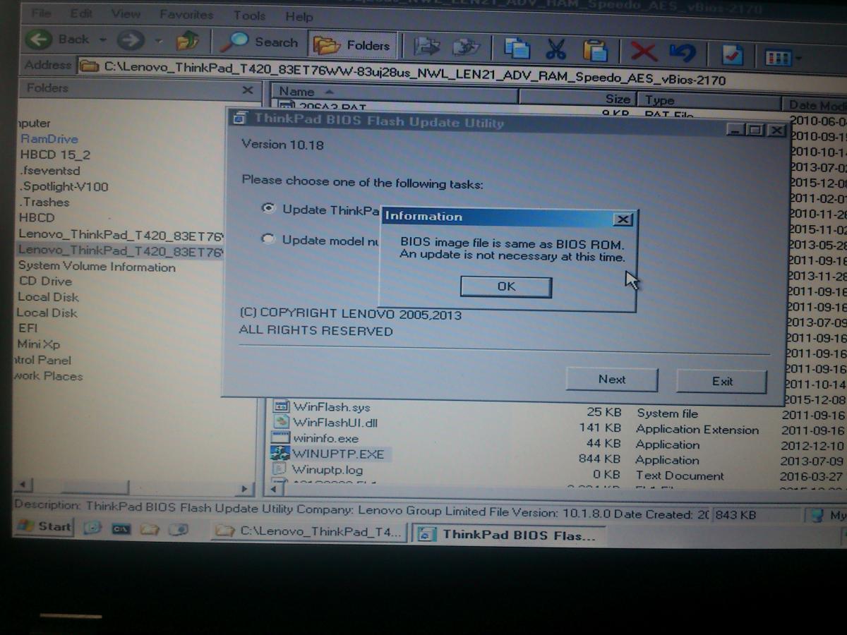

XSmile2008 Posted March 27, 2016 Share Posted March 27, 2016 Can I flash BIOS without installing Windows? I don't want lost my system and data. UPDATE: I tried use Hiren's Boot CD to update BIOS, but got this message. I have 1.46 BIOS version. Link to comment https://www.insanelymac.com/forum/topic/285678-lenovo-thinkpad-t420-with-uefi-only/page/98/#findComment-2227693 Share on other sites More sharing options...
pax1234 Posted March 27, 2016 Share Posted March 27, 2016 I have 1.46 Bios too. I used hiren's Boot CD mini windows 7 to update without any problem. I ran "flash.bat" in admin mode. Bios flashed after first reboot. No video glitches after bios flashed. Link to comment https://www.insanelymac.com/forum/topic/285678-lenovo-thinkpad-t420-with-uefi-only/page/98/#findComment-2227785 Share on other sites More sharing options...

XSmile2008 Posted March 27, 2016 Share Posted March 27, 2016 Same story if i load from Hiren's boot DVD with Windows 7. If i execute WINUPTP.EXE, i got message that BIOS not need to upgrade. If i load flash.bat, console was opened, after some time it just closing. After reboot I still have same BIOS. Link to comment https://www.insanelymac.com/forum/topic/285678-lenovo-thinkpad-t420-with-uefi-only/page/98/#findComment-2227861 Share on other sites More sharing options...

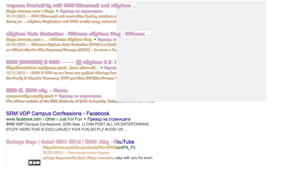

Zeridialous Posted March 30, 2016 Share Posted March 30, 2016 I have been experiencing glitches and total hard lock ups of the system to the point that I've almost given up on this entirely... very frustrating 1 Link to comment https://www.insanelymac.com/forum/topic/285678-lenovo-thinkpad-t420-with-uefi-only/page/98/#findComment-2228779 Share on other sites More sharing options...

tluck Posted March 31, 2016 Share Posted March 31, 2016 (edited) @adaml75 - there is a newer AppleHDA_20672.kext that works with 10.11.4 if you are interested. i didn't have any glitches until 10.11.4 either. 10.11.3 seems ok. for sure Yosemite was rock solid the whole time. i am living with the glitches for now. a few lines or black splotches every now and then. so i got sick of these blotches and took anther attempt at fixing. Using a brute force method installed 10.11.3 and then I copied/reverted a bunch of kexts: *HD3000* *SNB* AppleGraphics* and IOGraphics* kexts and so far - no glitches. i will update you after i see if it really works and what really made the difference. -- recommendation - remove/disable /S/L/E/AppleGraphicsPowerManagement.kext Edited April 6, 2016 by tluck 1 Link to comment https://www.insanelymac.com/forum/topic/285678-lenovo-thinkpad-t420-with-uefi-only/page/98/#findComment-2229095 Share on other sites More sharing options...

tluck Posted April 1, 2016 Share Posted April 1, 2016 @Zeridialous - i dunno? must be a driver thing? with my atheros on dual band wifi i only get tx=130 on 2.4 Ghz, but tx=300 on 5 Ghz update on 10.11.4 glitches: 1) if i rollback the just the AppleGraphicsPowerManagement.kext to 10.11.3 - get pretty decent results - just a odd black line every now and then. 2) if i rollback more kexts: AppleIntelHD3000* and AppleIntelSNB* and AGPM - seems to do even better - just started testing this though. - glitches again. 2 Link to comment https://www.insanelymac.com/forum/topic/285678-lenovo-thinkpad-t420-with-uefi-only/page/98/#findComment-2229395 Share on other sites More sharing options...
