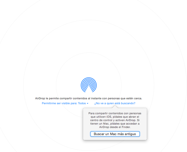

Somez Posted February 3, 2016 Share Posted February 3, 2016 Hi All, I've just received my DW1510 wifi card and it's working well, identified as 3rd party card and while the system information app sys AirDrop is supported, it does not find my iPhone 6. Somebody has mentioned earlier that this card has to be rebranded for AirDrop to be working. Where can I find a guide for that? Thanks. Link to comment https://www.insanelymac.com/forum/topic/285678-lenovo-thinkpad-t420-with-uefi-only/page/90/#findComment-2213035 Share on other sites More sharing options...
Somez Posted February 3, 2016 Share Posted February 3, 2016 Ok, I managed to rebrand using this guide despite I got an error after executing the last step. My card is now recognized as Airport Extreme in OS X. However AirDrop still cannot find my devices so I went ahead and used grep to filter the AirDrop lines in system.log (cat /var/log/system.log | grep AirDrop) and here is what I've found. Feb 3 18:30:28 Tamass-MacBook-Pro sharingd[333]: 18:30:28.187 : Device Capabilities (Handoff:NO, Instant Hotspot:NO, AirDrop:NO, Legacy AirDrop:YES, Remote Disc:NO) Feb 3 18:33:32 Tamass-MacBook-Pro sharingd[255]: 18:33:32.221 : Device Capabilities (Handoff:NO, Instant Hotspot:NO, AirDrop:NO, Legacy AirDrop:YES, Remote Disc:NO) Feb 3 18:41:11 Tamass-MacBook-Pro sharingd[255]: 18:41:11.801 : Finder entered AirDrop Feb 3 18:41:11 Tamass-MacBook-Pro sharingd[255]: 18:41:11.858 : Release AirDrop P2P link Feb 3 18:41:12 Tamass-MacBook-Pro sharingd[255]: 18:41:12.296 : AirDrop server enabled on port 8770 Feb 3 18:41:15 Tamass-MacBook-Pro sharingd[255]: 18:41:15.830 : AirDrop server disabled Feb 3 18:41:15 Tamass-MacBook-Pro sharingd[255]: 18:41:15.832 : AirDrop server terminated Feb 3 18:41:15 Tamass-MacBook-Pro sharingd[255]: 18:41:15.833 : Release AirDrop P2P link Feb 3 18:41:15 Tamass-MacBook-Pro sharingd[255]: 18:41:15.844 : AirDrop server enabled on port 8770 Feb 3 18:42:14 Tamass-MacBook-Pro pkd[257]: client 507 plug-in com.apple.share.AirDrop.send election := (null) Feb 3 18:48:38 Tamass-MacBook-Pro sharingd[255]: 18:48:38.785 : AirDrop server disabled Feb 3 18:48:38 Tamass-MacBook-Pro sharingd[255]: 18:48:38.785 : Finder exited AirDrop Feb 3 18:48:38 Tamass-MacBook-Pro sharingd[255]: 18:48:38.786 : AirDrop server terminated Feb 3 19:42:19 Tamass-MacBook-Pro sharingd[258]: 19:42:19.303 : Device Capabilities (Handoff:NO, Instant Hotspot:NO, AirDrop:NO, Legacy AirDrop:YES, Remote Disc:NO) Feb 3 19:43:17 Tamass-MacBook-Pro sharingd[258]: 19:43:17.824 : Finder entered AirDrop Feb 3 19:43:17 Tamass-MacBook-Pro sharingd[258]: 19:43:17.890 : Release AirDrop P2P link Feb 3 19:43:17 Tamass-MacBook-Pro sharingd[258]: 19:43:17.911 : AirDrop server enabled on port 8770 Feb 3 19:46:31 Tamass-MacBook-Pro sharingd[258]: 19:46:31.048 : AirDrop server disabled Feb 3 19:46:31 Tamass-MacBook-Pro sharingd[258]: 19:46:31.048 : Finder exited AirDrop Feb 3 19:46:31 Tamass-MacBook-Pro sharingd[258]: 19:46:31.048 : AirDrop server terminated Feb 3 21:12:24 Tamass-MacBook-Pro sharingd[258]: 21:12:24.198 : Starting AirDrop server for user 501 on wake Feb 3 21:20:45 Tamass-MacBook-Pro sharingd[258]: 21:20:45.817 : Finder entered AirDrop Feb 3 21:20:45 Tamass-MacBook-Pro sharingd[258]: 21:20:45.818 : Release AirDrop P2P link Feb 3 21:20:45 Tamass-MacBook-Pro sharingd[258]: 21:20:45.826 : AirDrop server enabled on port 8770 Feb 3 21:21:42 Tamass-MacBook-Pro sharingd[258]: 21:21:42.949 : AirDrop server disabled Feb 3 21:21:42 Tamass-MacBook-Pro sharingd[258]: 21:21:42.950 : AirDrop server terminated Feb 3 21:21:45 Tamass-MacBook-Pro sharingd[258]: 21:21:45.724 : Release AirDrop P2P link Feb 3 21:21:45 Tamass-MacBook-Pro sharingd[258]: 21:21:45.736 : AirDrop server enabled on port 8770 Feb 3 21:22:05 Tamass-MacBook-Pro pkd[262]: enabling pid=244 for plug-in com.apple.share.AirDrop.send(1.0) C4DBB355-9DA6-4C86-8361-17A810F785C9 /System/Library/PrivateFrameworks/FinderKit.framework/Versions/A/PlugIns/AirDrop.appex Feb 3 21:22:26 Tamass-MacBook-Pro AirDrop[629]: Error in CoreDragRemoveTrackingHandler: -1856 Feb 3 21:22:26 Tamass-MacBook-Pro AirDrop[629]: Error in CoreDragRemoveReceiveHandler: -1856 Feb 3 21:22:31 Tamass-MacBook-Pro Finder[244]: plugin com.apple.share.AirDrop.send invalidated Feb 3 21:22:31 Tamass-MacBook-Pro AirDrop[629]: host connection <NSXPCConnection: 0x7f8009707750> connection from pid 244 invalidated It's clear that I've got a problem here, but I have no idea how to proceed. What is legacy AirDrop after all? Link to comment https://www.insanelymac.com/forum/topic/285678-lenovo-thinkpad-t420-with-uefi-only/page/90/#findComment-2213070 Share on other sites More sharing options...
tluck Posted February 3, 2016 Share Posted February 3, 2016 well. my system works on airdrop with my wife's new macbook air - which supports the 2 modes of AirDrop - the new AirDrop mode by default. but to see my T420 there is a Legacy mode (bonjour based Airdrop) that allows it to see older systems. Link to comment https://www.insanelymac.com/forum/topic/285678-lenovo-thinkpad-t420-with-uefi-only/page/90/#findComment-2213097 Share on other sites More sharing options...
Somez Posted February 4, 2016 Share Posted February 4, 2016 well. my system works on airdrop with my wife's new macbook air - which supports the 2 modes of AirDrop - the new AirDrop mode by default. but to see my T420 there is a Legacy mode (bonjour based Airdrop) that allows it to see older systems. Hi tluck, I'm afraid I don't understand what you mean Do you have the same WLAN card - BCM4322 (DW1510) - as I have? What are the features that are enabled for you? Do you see not only the legacy Airdrop supported but the normal one as well? Thanks. Link to comment https://www.insanelymac.com/forum/topic/285678-lenovo-thinkpad-t420-with-uefi-only/page/90/#findComment-2213158 Share on other sites More sharing options...
trifero Posted February 4, 2016 Share Posted February 4, 2016 Somez, only works from Os X to Os X with that card. And by enabling compatibility mode. Link to comment https://www.insanelymac.com/forum/topic/285678-lenovo-thinkpad-t420-with-uefi-only/page/90/#findComment-2213209 Share on other sites More sharing options...
Somez Posted February 4, 2016 Share Posted February 4, 2016 Somez, only works from Os X to Os X with that card. And by enabling compatibility mode. Thanks trifero, I guess I should've ordered a different card then Any suggestions which card to buy for full AirDrop support? Thanks. Link to comment https://www.insanelymac.com/forum/topic/285678-lenovo-thinkpad-t420-with-uefi-only/page/90/#findComment-2213222 Share on other sites More sharing options...
tluck Posted February 4, 2016 Share Posted February 4, 2016 this is my understanding. there are 2 modes of AirDrop - the older/original Legacy Airdrop - based on Bonjour and PAN. new mode AirDrop (same name but different protocols) is based on BT/LE and p2p WiFi - so new macs and now iPhones (iOS7+) can participate. Since the standard T420 BT does not support LE, it reverts to Legacy Airdrop only mode which excludes iPhones. AirDrop in this mode connects to old macs (or new macs if toggle into legacy) - trifero posted the picture of how to enable that mode on a new mac iPhones don't support this Legacy mode. my 2010 MacBook Pro works just like my T420 (connects via Legacy AirDrop). my wife's 2015 macbookAir supports Handoff and thus new mode AirDrop to answer your question: i think you would just a newer BT to get LE for Handoff support etc. Link to comment https://www.insanelymac.com/forum/topic/285678-lenovo-thinkpad-t420-with-uefi-only/page/90/#findComment-2213231 Share on other sites More sharing options...
trifero Posted February 4, 2016 Share Posted February 4, 2016 this is my understanding. there are 2 modes of AirDrop - the older/original Legacy Airdrop - based on Bonjour and PAN. new mode AirDrop (same name but different protocols) is based on BT/LE and p2p WiFi - so new macs and now iPhones (iOS7+) can participate. Since the standard T420 BT does not support LE, it reverts to Legacy Airdrop only mode which excludes iPhones. AirDrop in this mode connects to old macs (or new macs if toggle into legacy) - trifero posted the picture of how to enable that mode on a new mac iPhones don't support this Legacy mode. my 2010 MacBook Pro works just like my T420 (connects via Legacy AirDrop). my wife's 2015 macbookAir supports Handoff and thus new mode AirDrop to answer your question: i think you would just a newer BT to get LE for Handoff support etc. The {censored} boss... Link to comment https://www.insanelymac.com/forum/topic/285678-lenovo-thinkpad-t420-with-uefi-only/page/90/#findComment-2213254 Share on other sites More sharing options...
Somez Posted February 4, 2016 Share Posted February 4, 2016 this is my understanding. there are 2 modes of AirDrop - the older/original Legacy Airdrop - based on Bonjour and PAN. new mode AirDrop (same name but different protocols) is based on BT/LE and p2p WiFi - so new macs and now iPhones (iOS7+) can participate. Since the standard T420 BT does not support LE, it reverts to Legacy Airdrop only mode which excludes iPhones. AirDrop in this mode connects to old macs (or new macs if toggle into legacy) - trifero posted the picture of how to enable that mode on a new mac iPhones don't support this Legacy mode. my 2010 MacBook Pro works just like my T420 (connects via Legacy AirDrop). my wife's 2015 macbookAir supports Handoff and thus new mode AirDrop to answer your question: i think you would just a newer BT to get LE for Handoff support etc. Is it possible to replace the BT module or that one is integrated into the motherboard? Or should I aim for a combined WLAN+BT card? I have an empty slot under the memory cover but that one seems to be a WWAN slot for 3G modems. Thanks. Link to comment https://www.insanelymac.com/forum/topic/285678-lenovo-thinkpad-t420-with-uefi-only/page/90/#findComment-2213272 Share on other sites More sharing options...
