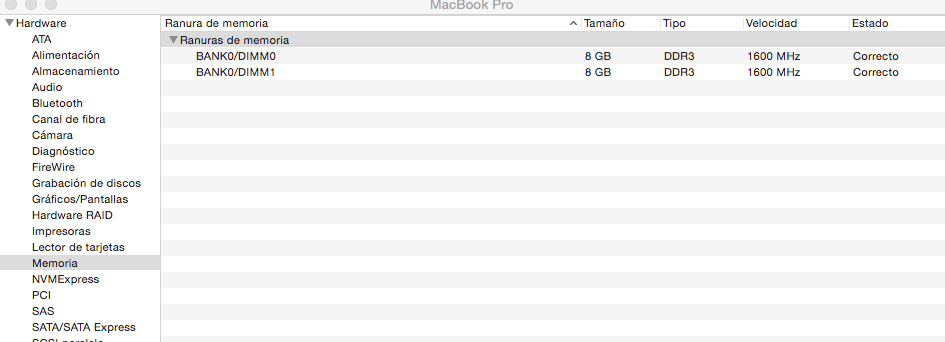

trifero Posted March 23, 2016 Share Posted March 23, 2016 I was using 1600 MHz ram in my T420 weeks ago... Link to comment https://www.insanelymac.com/forum/topic/285678-lenovo-thinkpad-t420-with-uefi-only/page/97/#findComment-2226096 Share on other sites More sharing options...

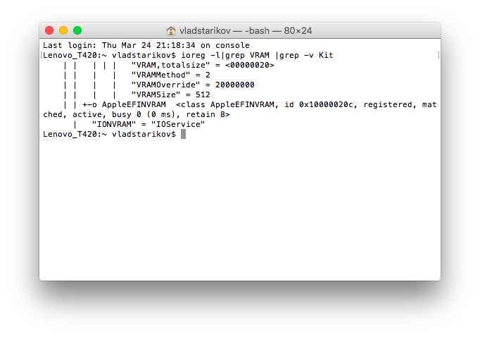

tluck Posted March 24, 2016 Share Posted March 24, 2016 @jus12 well that information and approach is half right. the custom kext is similar but i got it from a different post referencing some very old work by revogirl. $ strings AppleIntelHD3000Graphics |grep -i vramVRAMAllocationMethodVRAMSegmentMethodVRAMMethodinvalid vram method %dNot enabling dynamic vramUsing Dynamic VRAM method %dinit_VRAM_segmentsVRAMSizevramFreeBytesvramUsedBytes so the kext seems to read/use some VRAM vars - so perhaps VRAMOverride is totally useless. but VRAMMethod and VRAMSize seem to have a positive effect. in the custom HD3000Graphics i set VRAMMethod 2 and VRAMSize 512 i updated my BIOS with this more recent modded bios. i went into to Adv menu settings and memory speed to 1333, mode to 2N and changed to TOLUD to dynamic and upped the gfx memory items to their respective max. so anyway i don't know which one had the right effect but I have not seen a glitch since. Link to comment https://www.insanelymac.com/forum/topic/285678-lenovo-thinkpad-t420-with-uefi-only/page/97/#findComment-2226417 Share on other sites More sharing options...

tluck Posted March 24, 2016 Share Posted March 24, 2016 I reposted the workaround/fix kext above with install instructions - still working through this. for some reason that i don't understand, the Info.plist values from the /S/L/E AppleIntelHD3000Graphics.kext are getting loaded even though to it seems to be loading the kext in /Library/Extensions. so to make sure the /L/E kext is loaded, I remove the one in /S/L/E by renaming it. you should see some thing like this when you run this: $ ioreg -l|grep VRAM |grep -v Kit | | | | | "VRAM,totalsize" = <00000020> | | | | "VRAMMethod" = 2 | | | | "VRAMOverride" = 20000000 | | | | "VRAMSize" = 512 1 Link to comment https://www.insanelymac.com/forum/topic/285678-lenovo-thinkpad-t420-with-uefi-only/page/97/#findComment-2226715 Share on other sites More sharing options...
XSmile2008 Posted March 24, 2016 Share Posted March 24, 2016 Same problem. After updating to 10.11.4 got graphics glitches on screen. Installing kext from 2402 post doesn't solve the problem. Sometimes screen is freezing totally, only mouse moved, only reboot solve this. Link to comment https://www.insanelymac.com/forum/topic/285678-lenovo-thinkpad-t420-with-uefi-only/page/97/#findComment-2226735 Share on other sites More sharing options...
tluck Posted March 24, 2016 Share Posted March 24, 2016 XSmile2008 - did you get the newest kext and install with the procedure to make sure it is using the VRAM variables changes? because for me without these VRAM settings i get glitches almost immediately. and i have not had a freeze since using them. 1 Link to comment https://www.insanelymac.com/forum/topic/285678-lenovo-thinkpad-t420-with-uefi-only/page/97/#findComment-2226738 Share on other sites More sharing options...

jus12 Posted March 25, 2016 Share Posted March 25, 2016 @tluck I didn't do the Vmethod as of yet. Yesterday system frozen, so after that I have updated the bios to 2170 you have posted, and made same bios changes. I don't see glitches, or I didn't notice them. Will see how that works, but vmethod will be next correction, if I realise system is not performing well. If that will also not work, I will go back to 10.11.3, as that version was really stable. Downgrade Question: if I install MacOS Install (with 10.11.3) over current 10.11.4, would that work? Or clean install is recommended? Link to comment https://www.insanelymac.com/forum/topic/285678-lenovo-thinkpad-t420-with-uefi-only/page/97/#findComment-2226991 Share on other sites More sharing options...
tluck Posted March 25, 2016 Share Posted March 25, 2016 thanks for dialog on this topic. what bios changes did you make? i was thinking that memory speed could be a factor - so i set some of those ... and then i increased anything that looked like a gfx buffer to highest values. this VRAMMethod variable was discovered and discussed a long time along in various threads when HD 3000 was just being supported in OS X. and for me has had the best effect (still get some glitches). BUT the hard freeze is the worst situation. i have to force power off. and with VRAMMethod set, no freezes. i don't think VRAMOverride is even used but i changed just for the heck of it. and I am not sure VRAMSize is the right value (512?). yes - you can just install 10.11.3 on top on 10.11.4 i cloned my 10.11.4 disk onto a test disk and did just that. Link to comment https://www.insanelymac.com/forum/topic/285678-lenovo-thinkpad-t420-with-uefi-only/page/97/#findComment-2227045 Share on other sites More sharing options...
