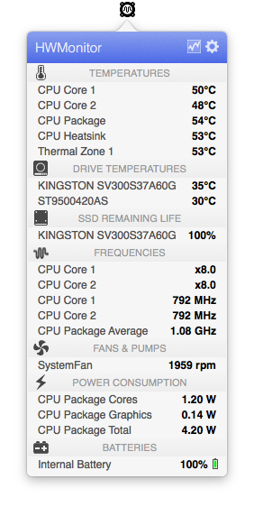

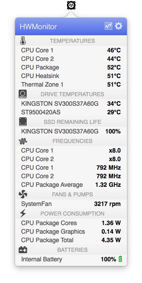

Somez Posted February 11, 2016 Share Posted February 11, 2016 I haven't found an easy way to control the fan through the DSDT, but found a way to change the behavior of the Blue ThinkVantage button. You can change the speed at which it sets. Scope (PCI0.LPC.EC) { Method (_Q19, 0, NotSerialized) { Name (FANS, One) Store (HFSP, FANS) XOr (FANS, 0x80, Local0) If (Local0) { Store (0x80, HFSP) } Else { Store (0x02, HFSP) } } } The last Store(0x02, HFSP) was changed from 0x07 (I remember this from TPFanControl - 7 is the "max speed". 2 is a constant speed of 3500 rpm, which is reasonable. I'm going to set it to 1 and see what the speed goes down to, if it's normally stable, etc. Speed 0x01 takes it down to a really really pleasant 2000 rpm. Hitting the blue button will take it to the 0x80 mode, which is auto. You could have the first item 0x01 or 0x02, and the 2nd be 0x80, and I presume that would make the default quiet, and blue be auto. probably better the other way around though. I'm running around 69-70 degC at the moment. Hey Guys! I would like to recap on this topic because I want to test how my machine works when I can enforce 2000 RPM with the ThinkVantage button and a 2nd press would toggle auto mode driven by BIOS. This is not how it works now in my case. Can someone tell me what file should I change and how to apply these changes for this concept to work? Also can it be that my power management is not fully set up? How can I check that? Thanks a lot. Link to comment https://www.insanelymac.com/forum/topic/285678-lenovo-thinkpad-t420-with-uefi-only/page/91/#findComment-2214906 Share on other sites More sharing options...
tluck Posted February 11, 2016 Share Posted February 11, 2016 @somez - mount your ESP edit /Volumes/ESP/EFI/CLOVER/ACPI/patched/dsdt.dsl look for _Q19 change 0x07 to 0x01 in this function. - which means force fan to lowest speed instead of highest 0x07 recompile the dsdt.dsl with the "iasl" tool do you have the HWMonitor.app (that is a companion item to FakeSMC etc.) if so when you run geek bench or something to generate load you can watch the fan speed as well as processor speed step levels. Link to comment https://www.insanelymac.com/forum/topic/285678-lenovo-thinkpad-t420-with-uefi-only/page/91/#findComment-2214912 Share on other sites More sharing options...
trifero Posted February 11, 2016 Share Posted February 11, 2016 Really, guys… Theres nothing wrong with the default fan speed control. Link to comment https://www.insanelymac.com/forum/topic/285678-lenovo-thinkpad-t420-with-uefi-only/page/91/#findComment-2214914 Share on other sites More sharing options...
Somez Posted February 11, 2016 Share Posted February 11, 2016 @somez - mount your ESP edit /Volumes/ESP/EFI/CLOVER/ACPI/patched/dsdt.dsl look for _Q19 change 0x07 to 0x01 in this function. - which means force fan to lowest speed instead of highest 0x07 recompile the dsdt.dsl with the "iasl" tool do you have the HWMonitor.app (that is a companion item to FakeSMC etc.) if so when you run geek bench or something to generate load you can watch the fan speed as well as processor speed step levels. Thanks tluck. ESP mounted File updated How do I compile the file with the iasl tool and where do I find this tool? Thanks. Link to comment https://www.insanelymac.com/forum/topic/285678-lenovo-thinkpad-t420-with-uefi-only/page/91/#findComment-2214921 Share on other sites More sharing options...
tluck Posted February 11, 2016 Share Posted February 11, 2016 @Somez - iasl command tool is included in the zip (utility folder) - compile on terminal command line: iasl dsdt.dsl if successful, you get a new dsdt.aml file. Link to comment https://www.insanelymac.com/forum/topic/285678-lenovo-thinkpad-t420-with-uefi-only/page/91/#findComment-2214929 Share on other sites More sharing options...
Somez Posted February 11, 2016 Share Posted February 11, 2016 @Somez - iasl command tool is included in the zip (utility folder) - compile on terminal command line: iasl dsdt.dsl if successful, you get a new dsdt.aml file. This is awkward. I got a lot of syntax errors which doesn't make any sense as i have only modified 1 line. Here's just a few of them: Maximum error count (200) exceeded /Volumes/ESP/EFI/CLOVER/ACPI/patched/dsdt.dsl 8890: ToPLD ( Error 4124 - syntax error, unexpected PARSEOP_NAMESEG, expecting ',' or '}' ^ /Volumes/ESP/EFI/CLOVER/ACPI/patched/dsdt.dsl 8891: PLD_Revision = 0x1, Error 4124 - Invalid character (0x3D), expecting ASL keyword or name ^ /Volumes/ESP/EFI/CLOVER/ACPI/patched/dsdt.dsl 8892: PLD_IgnoreColor = 0x1, Error 4124 - Invalid character (0x3D), expecting ASL keyword or name ^ /Volumes/ESP/EFI/CLOVER/ACPI/patched/dsdt.dsl 8893: PLD_Red = 0x0, Error 4124 - Invalid character (0x3D), expecting ASL keyword or name ^ /Volumes/ESP/EFI/CLOVER/ACPI/patched/dsdt.dsl 8894: PLD_Green = 0x0, Error 4124 - Invalid character (0x3D), expecting ASL keyword or name ^ /Volumes/ESP/EFI/CLOVER/ACPI/patched/dsdt.dsl 8895: PLD_Blue = 0x0, Error 4124 - Invalid character (0x3D), expecting ASL keyword or name ^ Link to comment https://www.insanelymac.com/forum/topic/285678-lenovo-thinkpad-t420-with-uefi-only/page/91/#findComment-2214931 Share on other sites More sharing options...
tluck Posted February 11, 2016 Share Posted February 11, 2016 (edited) ah right.... i forget that i switched to a newer version iasl and didn't update the zip with this rev! new zip posted now. Edited February 11, 2016 by tluck Link to comment https://www.insanelymac.com/forum/topic/285678-lenovo-thinkpad-t420-with-uefi-only/page/91/#findComment-2214934 Share on other sites More sharing options...
Somez Posted February 11, 2016 Share Posted February 11, 2016 ah right.... i forget that i switched to a newer version iasl and didn't update the zip with this rev! np Link to comment https://www.insanelymac.com/forum/topic/285678-lenovo-thinkpad-t420-with-uefi-only/page/91/#findComment-2214938 Share on other sites More sharing options...
Somez Posted February 11, 2016 Share Posted February 11, 2016 ah right.... i forget that i switched to a newer version iasl and didn't update the zip with this rev! new zip posted now. Are you sure it's ok now? I've downloaded the new zip and ran the ssdtPRGen-clover.command as root to install the latest iasl. I'm still seeing the same errors when trying to compile. This is the version I have installed. Intel ACPI Component Architecture ASL Optimizing Compiler version 20130117-64 [Jan 19 2013] Copyright © 2000 - 2013 Intel Corporation EDIT: Nevermind, I copied manually to /usr/local/bin and I managed to compile it with no errors. Link to comment https://www.insanelymac.com/forum/topic/285678-lenovo-thinkpad-t420-with-uefi-only/page/91/#findComment-2214960 Share on other sites More sharing options...
tluck Posted February 11, 2016 Share Posted February 11, 2016 what does the ssdtPRgen have to do with the iasl command? - that script is an optional way to create an SSDT? the (new) iasl .dsl compiler file is in that same folder tho. $ ./iasl Intel ACPI Component ArchitectureASL+ Optimizing Compiler version 20150515-64Copyright © 2000 - 2015 Intel Corporation Supports ACPI Specification Revision 6.0 Link to comment https://www.insanelymac.com/forum/topic/285678-lenovo-thinkpad-t420-with-uefi-only/page/91/#findComment-2214962 Share on other sites More sharing options...
Somez Posted February 11, 2016 Share Posted February 11, 2016 what does the ssdtPRgen have to do with the iasl command? - that script is an optional way to create an SSDT? the (new) iasl .dsl compiler file is in that same folder tho. $ ./iasl Intel ACPI Component Architecture ASL+ Optimizing Compiler version 20150515-64 Copyright © 2000 - 2015 Intel Corporation Supports ACPI Specification Revision 6.0 The guide says that script will copy iasl to usr/bin: "Note: it will copy iasl from the Utility folder to /usr/local/bin/iasl" Anyway I just did a reboot and it finally works. I can switch between 2000 RPM and BIOS driven fan speed. Here are the before/after stats on idle: Well, I'm quite satisfied with this setting. I can use the machine at 2000 RPM most of the time except when there is something CPU intensive. I don't really understand why the BIOS's auto mode is not going down to 2000 RPM on it's own. I guess we cannot change auto mode to use 2000 RPM, right? That would be going into BIOS hacking I assume. By the way, I have a HDD in an optibay caddy. Can I somehow set the time needed to go to sleep? It needs a lot of time and it's much louder than the fan at 3200 RPM. Thanks a lot tluck for all your help so far. Link to comment https://www.insanelymac.com/forum/topic/285678-lenovo-thinkpad-t420-with-uefi-only/page/91/#findComment-2214963 Share on other sites More sharing options...
tluck Posted February 11, 2016 Share Posted February 11, 2016 NP. i hope your system doesn't over heat... in System Preference/Energy Saver - see power option to allow it to put disks to sleep when it can for battery and/or plugged in. unmounting any filesystems on the HDD in the caddy should help it to as when to put that drive to sleep! Link to comment https://www.insanelymac.com/forum/topic/285678-lenovo-thinkpad-t420-with-uefi-only/page/91/#findComment-2214968 Share on other sites More sharing options...
Somez Posted February 11, 2016 Share Posted February 11, 2016 NP. in System Preference/Energy Saver - see power option to allow it to put disks to sleep when it can for battery and/or plugged in. That option is set already. I just think it is waiting too much to engage and put it to sleep so I was thinking there should be an OS X switch that drives this. Link to comment https://www.insanelymac.com/forum/topic/285678-lenovo-thinkpad-t420-with-uefi-only/page/91/#findComment-2214969 Share on other sites More sharing options...
