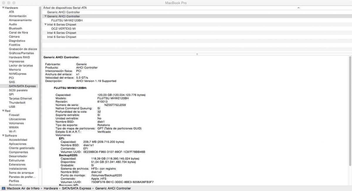

trifero Posted April 5, 2016 Share Posted April 5, 2016 Just in a case anyone is interested... One thing i missed in my X220, referenced to the T420, is the ESATA port that I use for the backups. I got the "Sonnet Tempo Sata Iii Expresscard 34 Esata" from eBay, just for 20$. Native supported, no further installation is needed. Great speed. No boot support, though. Only in certain MacBooks. http://www.sonnettech.com/product/temposataiii6gbec34.html Link to comment https://www.insanelymac.com/forum/topic/285678-lenovo-thinkpad-t420-with-uefi-only/page/99/#findComment-2230434 Share on other sites More sharing options...
