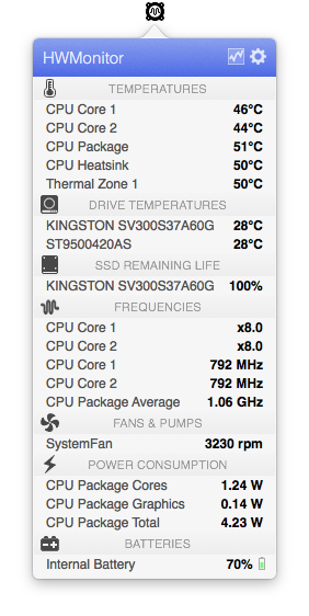

Hmmm... it seems I have to re-think this whole "high fan RPM" situation. Yesterday I was trying to find out what is triggering the higher RPM zones (~3200 RPM). I was under the impression that the cloudd process that is syncing to iCloud is causing it, but my fan still keeps running now even when there is no ethernet cable connected. The CPU idle is around 98% still the fan does not want to go below 3200 RPM. My CPU temp is around 50 C in these cases. Neither Activity Monitor nor TOP command from Terminal shows anything that could consume my CPU.

@somez - 50C seems high for idle?  well my box seems to idle with CPU temps 40-44 C and then above (not sure the point), the fan moves from 1980 RPM seem  3250 RPM. and then it will jumps to 3575 RPM all day - my cores are 47-49 C -- cpu watts are 9 - with LCD + ext mon.

Thanks for the tip tluck. I'll check how worn the thermal paste is on the CPU. Truth to be told I bought this machine from a second hand shop, they give me 6 months of warranty and the machine looked clean inside so I'm assuming new thermal paste has been applied. But it's definitely worth a quick check.
I've also found settings in the BIOS to adjust the amount of throttling on battery and also on AC power. There aren't too many options as I can recall (I'm at work now, can't check my T420 which is at home): maximum performance, balanced performance.
Anyway, I'll report back my findings so hopefully others will benefit from it too.
ps. Do you think the "create custom SSDT" option of the installing guide could have any impact on this? I mean if i do something wrong then could it cause higher CPU frequency hence higher fan RPM?
Thanks.
i would check the paste!!! blowing out the dust is easy to make it look good.

Damn, I managed to disassemble my machine and remove the heatsink. Everything looked good on it so I wanted to clean the sink and apply new thermal paste when I realised I don't know where have I left it. So at the end I had to skip this part and assemble everything. Will buy new paste next week.
Here are my values, do you think these justify my 3200 RPM?
