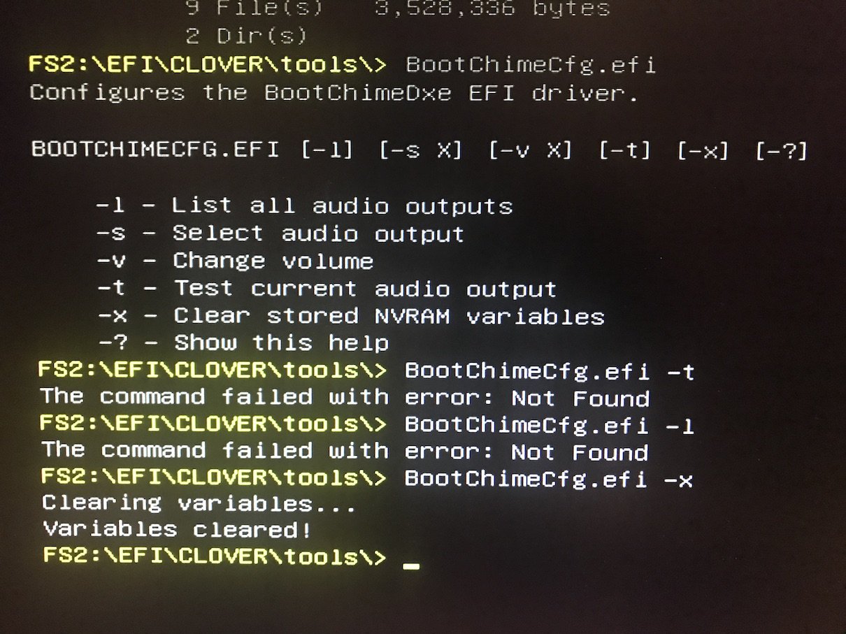

arsradu Posted January 18, 2019 Share Posted January 18, 2019 (edited) On 1/8/2019 at 9:06 PM, al6042 said: Just tried the last official clover release 4842 and got the following errors while trying to check and configure BootChimeCfg.efi on my H170N-Wifi and Prime Z390-A: Did I miss something? I think BootChimeCfg.efi needs to be executable. Which, depending on where did you get it from, it might not be. Personally I couldn't get my system to play the sound.wav file I placed in the theme folder. Not sure why. Still checking a few things. Edited January 18, 2019 by arsradu Link to comment https://www.insanelymac.com/forum/topic/284656-clover-general-discussion/page/736/#findComment-2659790 Share on other sites More sharing options...
al6042 Posted January 18, 2019 Share Posted January 18, 2019 Nope, BootChimeCfg.efi was working fine, that's why the last command in the screenshot worked. The errors with the other options were gone, as soon as an AudioDxe.efi-file was placed in /EFI/CLOVER/driver64UEFI... Either as manual copy or with clover 4844... Link to comment https://www.insanelymac.com/forum/topic/284656-clover-general-discussion/page/736/#findComment-2659807 Share on other sites More sharing options...
arsradu Posted January 18, 2019 Share Posted January 18, 2019 (edited) 1 hour ago, al6042 said: Nope, BootChimeCfg.efi was working fine, that's why the last command in the screenshot worked. The errors with the other options were gone, as soon as an AudioDxe.efi-file was placed in /EFI/CLOVER/driver64UEFI... Either as manual copy or with clover 4844... You're correct. After further investigation, it looks like I managed to reproduce the errors you were having. So yeah, it wasn't related to being executable or not. Actually, I think they're made executable anyway, when you drop them in the tools folder. Could be wrong thought. In my case, it was the "sound.wav" file missing from the theme's folder. Still trying to get it to work... So far I managed to set it up... But still no sound on startup. I'm sure there's probably a mistake on my side somewhere. EDIT: if you have more than one SSD/HDD with Clover on it, make sure you set the chime on the correct one. EDIT 2: ok, so now I'm exactly where you are. Managed to set it up for boot (it was a total pain in the rear to find the correct boot EFI partition to load from Shell - for some reason, in my case it was FS11...) and tested it, working fine in Shell, but no sound on boot. My guess is that maybe the sound output device is not selected correctly....? I don't know. What I do know, is that, Clover 4851 has an interface for testing and configuring the boot sound, but it always selects Device Output #1 for some reason...even after I selected Device #8, aaaand...pressing F7 to test that device will freeze the entire UI. In my case, I set in the Shell the output device to be the one selected below (nr 8 in the list) but every time I enter here, it shows the first option. My guess is that the output device might haven't been saved. That's why it doesn't make any sound on boot. Also, as I said, pressing F7 here will freeze the interface without making any sound. Interestingly enough, it seems to have remembered the correct volume setting (60%). But not the output device. Edited January 18, 2019 by arsradu Link to comment https://www.insanelymac.com/forum/topic/284656-clover-general-discussion/page/736/#findComment-2659810 Share on other sites More sharing options...

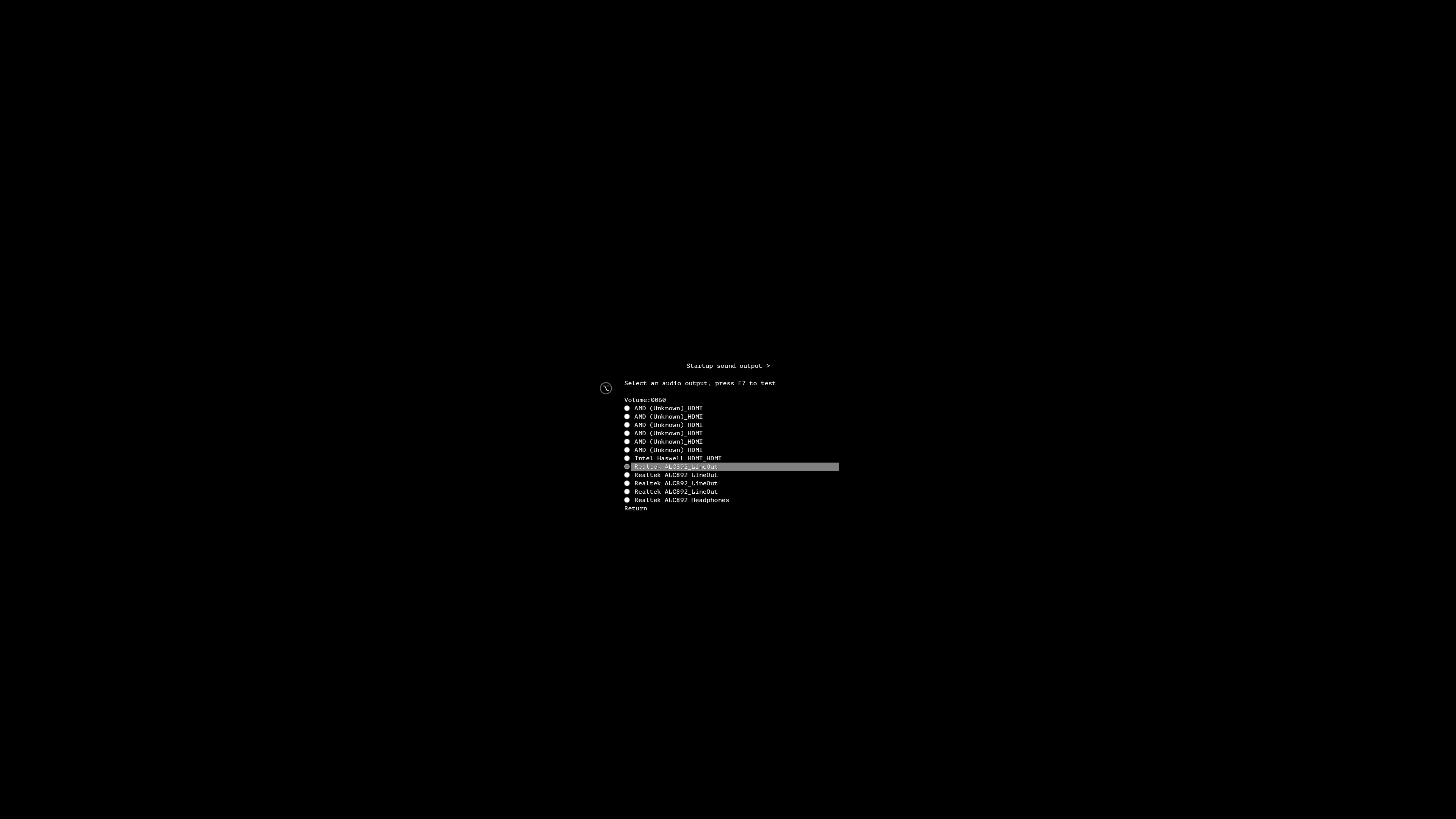

cecekpawon Posted January 19, 2019 Share Posted January 19, 2019 @al6042 From the last commit, BootChimeCfg are now in interactive mode. With extra warn if no AudioDxe was loaded. Give it a try. BootChimeCfg.efi.zip 1 1 Link to comment https://www.insanelymac.com/forum/topic/284656-clover-general-discussion/page/736/#findComment-2659870 Share on other sites More sharing options...
arsradu Posted January 19, 2019 Share Posted January 19, 2019 (edited) @cecekpawon I tried that, too. On startup, it says: "No device outputs were found. Ensure AudioDxe is loaded." Well...boot log says AudioDxe is loaded... 0:152 0:000 Loading AudioDxe-64.efi status=Success 0:153 0:001 - driver needs connecting Any idea? Edited January 19, 2019 by arsradu Link to comment https://www.insanelymac.com/forum/topic/284656-clover-general-discussion/page/736/#findComment-2659874 Share on other sites More sharing options...
MakAsrock Posted January 19, 2019 Share Posted January 19, 2019 1 hour ago, cecekpawon said: @al6042 From the last commit, BootChimeCfg are now in interactive mode. With extra warn if no AudioDxe was loaded. Give it a try. BootChimeCfg.efi.zip Thanks It works! Link to comment https://www.insanelymac.com/forum/topic/284656-clover-general-discussion/page/736/#findComment-2659875 Share on other sites More sharing options...
MakAsrock Posted January 19, 2019 Share Posted January 19, 2019 15 minutes ago, arsradu said: @cecekpawon I tried that, too. On startup, it says: "No device outputs were found. Ensure AudioDxe is loaded." Well...it is present in drivers64UEFI...not sure if it's loaded though. Any idea? Try to clear the previous settings. To do this, choose option x, then s and v it also makes sense to check if the latest AudioDxe-64.efi or AudioDxe.efi is present in the drivers64UEFI folder. Link to comment https://www.insanelymac.com/forum/topic/284656-clover-general-discussion/page/736/#findComment-2659877 Share on other sites More sharing options...

cecekpawon Posted January 19, 2019 Share Posted January 19, 2019 @arsradu from your log it sure enough that driver were successfully loaded. If you are already start BootChimeCfg from GUI, I have nothing to says more. Not sure AudioDxe (Clover vs Official) version is really matter here _/|\_ 1 Link to comment https://www.insanelymac.com/forum/topic/284656-clover-general-discussion/page/736/#findComment-2659911 Share on other sites More sharing options...
arsradu Posted January 19, 2019 Share Posted January 19, 2019 (edited) 1 hour ago, cecekpawon said: @arsradu from your log it sure enough that driver were successfully loaded. If you are already start BootChimeCfg from GUI, I have nothing to says more. Not sure AudioDxe (Clover vs Official) version is really matter here _/|\_ Yeah, I am able to configure, test and set the wav sound I put in my selected theme (Minimalism). It respects the file name (sound.wav), the sample rate (44.1KHz) and the bits per sample (16bps). So... I would say the file is ok, the locations are ok (otherwise I think I wouldn't have been able to test and configure boot sound in the first place), still, upon startup, it says the output device is not found, and ensure AudioDxe is loaded... So...not sure what to say. :)) All seems to be working properly. Still, it doesn't. :)) And I'm using Clover 4851 (with the built-in AudioDxe) which in this exact commit it says: "update AudioDxe driver to sync with origin". So...I guess there shouldn't be a difference anymore, should it? If you have another version of AudioDxe, I would love to give it a try. Update: nevermind. IT WORKS! :)) It just works AFTER selecting the boot drive, not before, as it probably should, and as Clover's AudioDxe is probably trying to achieve. I guess Clover's AudioDxe is not (yet) compatible with the prebuilt BootChimeCfg.efi? Ooor...there's something missing somewhere. Bottom line, what did I do is: I got Goldfish's sources, compiled everything on my machine, used AudioDxe.efi, BootChimeDxe.efi in /drivers64UEFI and BootChimeCfg.efi and HdaCodecDump.efi in /tools and it works. Also, one thing to note is that I had to shut down my computer, and then restart. Simple restart didn't do it for me. Don't know why. Also, there was no error anymore. So I guess they're not compatible yet. So the config file doesn't see the AudioDxe file from Clover. But if it's built with it...it does. There are also other files, such as BootChimeDxe and HdaCodecDump which are missing from the Clover's instructions. They might not be needed. I just took everything as it was from the compiled sources. Just to have all the possible chances of this to work. And, what do you know? It does. :)) I'll test a few more things now and let you know if I find anything interesting. Edited January 19, 2019 by arsradu Link to comment https://www.insanelymac.com/forum/topic/284656-clover-general-discussion/page/736/#findComment-2659914 Share on other sites More sharing options...
MakAsrock Posted January 19, 2019 Share Posted January 19, 2019 18 minutes ago, arsradu said: Yeah, I am able to configure, test and set the wav sound I put in my selected theme (Minimalism). It respects the file name (sound.wav), the bitrate (44.1KHz) and the bps (16bps). So... I would say the file is ok, the locations are ok (otherwise I think I wouldn't have been able to test and configure boot sound in the first place), still, upon startup, it says the output device is not found, and ensure AudioDxe is loaded... So...not sure what to say. :)) All seems to be working properly. Still, it doesn't. :)) And I'm using Clover 4851 (with the built-in AudioDxe) which in this exact commit it says: "update AudioDxe driver to sync with origin". So...I guess there shouldn't be a difference anymore, should it? If you have another version of AudioDxe, I would love to give it a try. I am using a driver (official Goldfish64 build). The built in clover 4851 doesn't work properly for me. In the driver folder, I have BootChimeDxe.efi, which contains the ta-da sound. When I try to use the built-in (AudioDxe-64.efi) driver, I have no sound, and if I try to configure its parameters from the Clover menu, everything hangs and the previous settings are erased from the nvram. I am attaching the complete package I have just build in the archive. I apologize for my bad english. I'm from Russia. AudioPkg-R1-RELEASE.zip 1 Link to comment https://www.insanelymac.com/forum/topic/284656-clover-general-discussion/page/736/#findComment-2659918 Share on other sites More sharing options...
