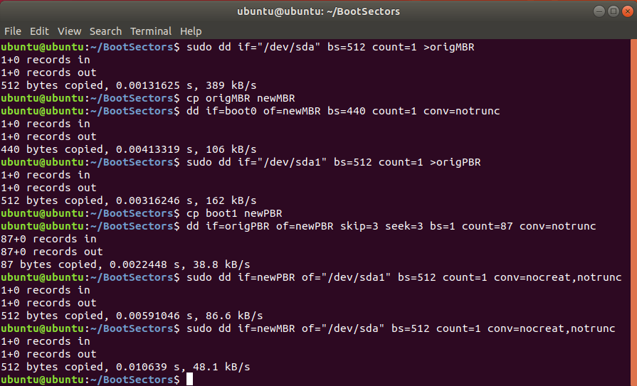

Badruzeus Posted January 5, 2019 Share Posted January 5, 2019 (edited) Well, my friend's old Pentium laptop has no UEFI support (also non Hackintosh compatible), but he wants Windows UEFI on it so.. I converted whole Disk to GPT, manually created 200MB EFI using gParted under Ubuntu Live and set is as=boot,esp. I restored my prev. Windows 10 64-bit backup using G4L (Ghost for Linux) to a new NTFS partition (/dev/sda2), restoring EFI\Microsoft\ to ESP (/dev/sda1), repairing BCD with Windows PE (bootrec /RebuildBcd bla bla bla) and it's booting just fine using USB FlashDisk with Clover on it (following @fusion71au guide actually, thanks to him). I then, manually installing Clover using Ubuntu Live into Internal EFI Partition (should be Legacy-GPT, but Windows is UEFI emulated, right?) Bootloader files used: boot (boot6) | boot0 (boot0af) | boot1 (boot1f32) \\Oh ya, I manually copying "BOOT && CLOVER" dir using FileManager, so not included on screenshot below LoL Seems no problem with bootloader installation on Legacy as usual (I think, CMIIW), Windows is also booting fine. The only issue is, everytime I powering on laptop it always goes to Firmware screen first (not laptop's BIOS) so I need to always pressing "Continue" to get Clover boot after it. My questions are: 1. What's causing this issue? I've tried boot6 && boot7 with a same result #btw 2. How to set "Timeout" with only single boot volume (so I don't need to press KB key twice but just boot to Windows directly)? I realized it doesn't work here. Thanks. Edited January 5, 2019 by Badruzeus Link to comment https://www.insanelymac.com/forum/topic/284656-clover-general-discussion/page/730/#findComment-2657338 Share on other sites More sharing options...

apianti Posted January 5, 2019 Share Posted January 5, 2019 (edited) 6 hours ago, Badruzeus said: Well, my friend's old Pentium laptop has no UEFI support (also non Hackintosh compatible), but he wants Windows UEFI on it so.. I converted whole Disk to GPT, manually created 200MB EFI using gParted under Ubuntu Live and set is as=boot,esp. I restored my prev. Windows 10 64-bit backup using G4L (Ghost for Linux) to a new NTFS partition (/dev/sda2), restoring EFI\Microsoft\ to ESP (/dev/sda1), repairing BCD with Windows PE (bootrec /RebuildBcd bla bla bla) and it's booting just fine using USB FlashDisk with Clover on it (following @fusion71au guide actually, thanks to him). I then, manually installing Clover using Ubuntu Live into Internal EFI Partition (should be Legacy-GPT, but Windows is UEFI emulated, right?) Bootloader files used: boot (boot6) | boot0 (boot0af) | boot1 (boot1f32) \\Oh ya, I manually copying "BOOT && CLOVER" dir using FileManager, so not included on screenshot below LoL Seems no problem with bootloader installation on Legacy as usual (I think, CMIIW), Windows is also booting fine. The only issue is, everytime I powering on laptop it always goes to Firmware screen first (not laptop's BIOS) so I need to always pressing "Continue" to get Clover boot after it. My questions are: 1. What's causing this issue? I've tried boot6 && boot7 with a same result #btw 2. How to set "Timeout" with only single boot volume (so I don't need to press KB key twice but just boot to Windows directly)? I realized it doesn't work here. Thanks. You have a problem with NVRAM as nothing will ever be saved, you should replace the EmuVar module with the FSVariable module from DUET for some partial support. You can skip clover GUI entirely by just putting microsoft bootmgfw.efi as bootx64.efi. EDIT: You may want to just use DUET actually. EDIT2: Oh, actually I think the legacy firmware loads CLOVERX64.efi by default not BOOTX64.efi. Edited January 5, 2019 by apianti 1 Link to comment https://www.insanelymac.com/forum/topic/284656-clover-general-discussion/page/730/#findComment-2657372 Share on other sites More sharing options...
Badruzeus Posted January 5, 2019 Share Posted January 5, 2019 (edited) 41 minutes ago, apianti said: You have a problem with NVRAM as nothing will ever be saved, you should replace the EmuVar module with the FSVariable module from DUET for some partial support. Hmmb that's why how many times I "Change Boot Order" on firmware it'll always reset to default after mach reboot, a same issue with VirtualBox even if configured as UEFI.. firmware configurations are not saved once app relaunched due to lack of NVRAM. Funny thing here's (sorry, my bad); it boots directly into Clover w/o pressing "Continue" when I plugged Laptop's KeyBoard off (using USB ext-KB to replace it). I just realized that some Laptop's keys are broken (always keep pressed) after checking it using Keyboard Test software under Windows. I think they prevent (or suspend) Clover boot. 41 minutes ago, apianti said: You can skip clover GUI entirely by just putting microsoft bootmgfw.efi as bootx64.efi. Oh great, thank you. Much better idea with single Windows boot (though, I never tried this before.. honestly) But my friend now (seems) feel happy using Clover bcoz he could place his gf's photo on it (I believe in his mind, Clover=Theme not a Boot Manager LoL). Edited January 5, 2019 by Badruzeus Link to comment https://www.insanelymac.com/forum/topic/284656-clover-general-discussion/page/730/#findComment-2657379 Share on other sites More sharing options...
apianti Posted January 5, 2019 Share Posted January 5, 2019 4 hours ago, Badruzeus said: Hmmb that's why how many times I "Change Boot Order" on firmware it'll always reset to default after mach reboot, a same issue with VirtualBox even if configured as UEFI.. firmware configurations are not saved once app relaunched due to lack of NVRAM. Funny thing here's (sorry, my bad); it boots directly into Clover w/o pressing "Continue" when I plugged Laptop's KeyBoard off (using USB ext-KB to replace it). I just realized that some Laptop's keys are broken (always keep pressed) after checking it using Keyboard Test software under Windows. I think they prevent (or suspend) Clover boot. Oh great, thank you. Much better idea with single Windows boot (though, I never tried this before.. honestly) Yeah but it boots directly into clover with the usb right? So I doubt the keyboard is the issue, although maybe who knows... I know the NVRAM is for sure as there is no way to save the nvram.plist from windows to be loaded later. The FSVariable module from DUET saves the variable store when exiting boot services instead, so no runtime changes are saved but at least your would get semi working nvram. Either that or write an administrator app or kernel driver that dumps the uefi variables into a plist on the ESP. You might want to read my edit in the previous post about the default boot as I forgot it is different for clover legacy firmware, although if he wants to keep it whatever, lol. You can set DefaultVolume to the ESP (which you can get from log) and the DefaultLoader to \EFI\Microsoft\Boot\bootmgfw.efi, then set Timeout to whatever and it should automatically boot. As for the FSVariable module you can edit Clover.fdf and uncomment the line for it and comment out the other lines for NVRAM below or you can try using -DREAL_NVRAM to build and see if the real nvram can be used, however, I'm not sure how safe that is. 1 Link to comment https://www.insanelymac.com/forum/topic/284656-clover-general-discussion/page/730/#findComment-2657433 Share on other sites More sharing options...

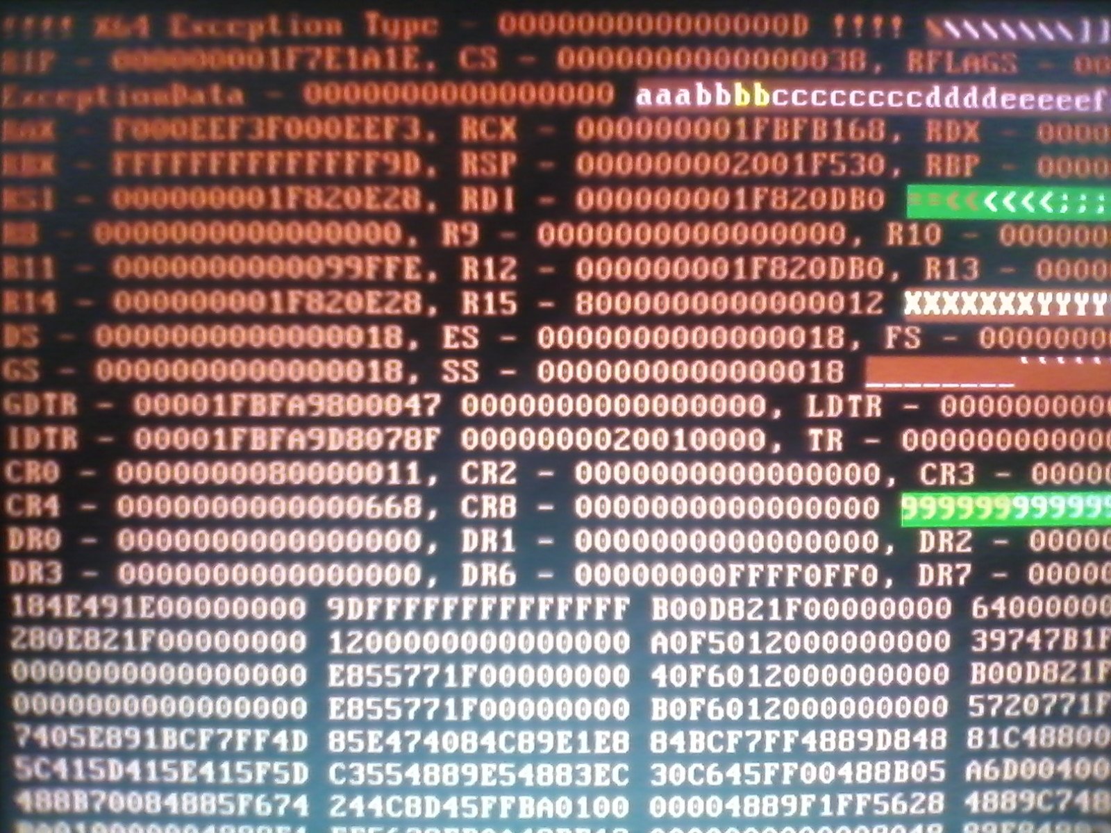

apianti Posted January 6, 2019 Share Posted January 6, 2019 Oh cool, I got it..!!! Fully powering off mach, F11 to reset NVRAM, reboot.. freeze! A same issue like yours (UEFI) LoL, no problem on 1st reboot though. And using legacy it leads me to red screen of death, du no what's wrong with r4839. (I'm still able booting to Linux using BIOS StartUp key for rolliing back to r4836, nevermind). What is the last legacy revision that works because I don't see anything that should be affecting legacy in between those revisions. You are getting a general protection fault which means usually that a pointer has an incorrect address of unallocated memory region being used. 1 Link to comment https://www.insanelymac.com/forum/topic/284656-clover-general-discussion/page/730/#findComment-2657555 Share on other sites More sharing options...
Badruzeus Posted January 6, 2019 Share Posted January 6, 2019 (edited) What is the last legacy revision that works because I don't see anything that should be affecting legacy in between those revisions. You are getting a general protection fault which means usually that a pointer has an incorrect address of unallocated memory region being used. OK, r4839 (UEFI / Legacy) is now working fine after commenting those line. Thanks. I no longer hear "../Theme Name/sound.wav" ringing before GUI loaded though. It looks like I misunderstood @Slice r4833 changelogs: \Theme Name\sound.wav = Before Clover GUI \drivers64UEFI\BootChimeDxe.efi = After it (pausing 5 secs on Apple logo, similar to a real mac w/o *.wav) Honestly, I assumed *.wav file provided by him is Apple BootChime audio LoL With r4836, I could hear both of them ringing (before & after Clover GUI, having diff. StartUp audios). preboot.log_r4839_legacy_pointer.zip Edited January 6, 2019 by Badruzeus Link to comment https://www.insanelymac.com/forum/topic/284656-clover-general-discussion/page/730/#findComment-2657560 Share on other sites More sharing options...

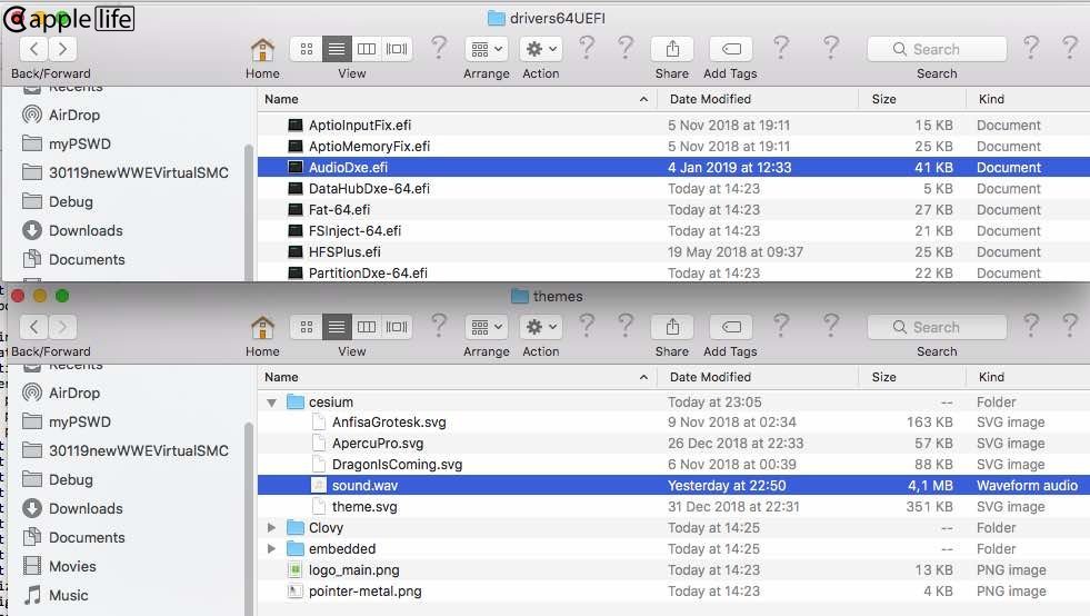

D-an-W Posted January 6, 2019 Share Posted January 6, 2019 (edited) Thanks apianti and blackosx got me booting with 4839, now to figure out the changes to make sounds work on boot! EDIT: For me the sample provided by Slice works fine before the Clover GUI loads (Is it a cat?!?) and if I setup and test the boot chime in the shell I can hear it just fine using "BootChimeCfg.efi -t" but I don't hear anything when the OS is loading, could this be due to commenting out that line? Boot.log of the important bit (I think)... 4:500 0:000 === [ InitTheme ] ========================================= 4:500 0:000 use night theme 4:512 0:011 Using theme 'Mojave' (EFI\CLOVER\themes\Mojave) 4:512 0:000 theme Mojave defined in NVRAM found and theme.plist parsed 4:512 0:000 OS main and drive as badge 4:513 0:000 file sound not found 4:517 0:004 Channels: 2 Sample rate: 44100 Hz Bits: 16 4:517 0:000 found 2 handles with audio 4:518 0:000 stored device=PciRoot(0x0)/Pci(0x1B,0x0)/VenMsg(A9003FEB-D806-41DB-A491-5405FEEF46C3,02000000) 4:518 0:000 got index=1 4:518 0:000 got volume 80 4:518 0:000 output to channel 1 with volume 80, len=353440 7:846 3:327 Loading font from ThemeDir: Success 7:847 0:000 theme inited 7:847 0:000 Chosen theme Mojave 7:847 0:000 after NVRAM boot-args= Edited January 6, 2019 by D-an-W Link to comment https://www.insanelymac.com/forum/topic/284656-clover-general-discussion/page/730/#findComment-2657627 Share on other sites More sharing options...
apianti Posted January 6, 2019 Share Posted January 6, 2019 No you need BootChimeDxe.efi in drivers64UEFI for the chime to happen during macos boot. Also you may need to configure it if you haven't. 1 Link to comment https://www.insanelymac.com/forum/topic/284656-clover-general-discussion/page/730/#findComment-2657644 Share on other sites More sharing options...
