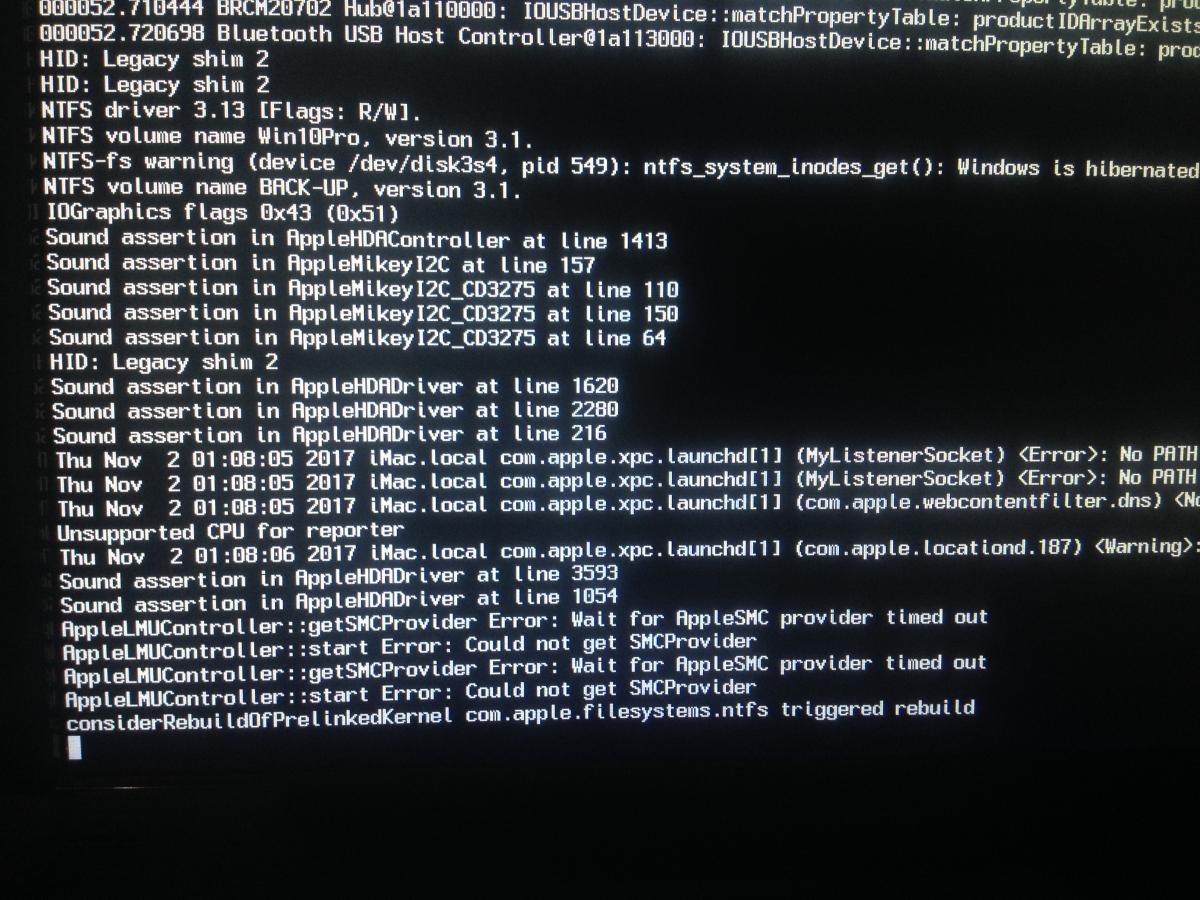

25:127 21:365 BootVariable of the entry is empty
25:127 0:000 === [ StartLoader ] =======================================
25:127 0:000 Finally: ExternalClock=25MHz BusSpeed=100214kHz CPUFreq=4009MHz PIS: hw.busfrequency=100000000Hz
25:127 0:000 Loading boot.efi status=Success
25:157 0:030 GetOSVersion: 10.13.2 (17C60c)
25:157 0:000 CSR_CFG: CSR_ALLOW_UNTRUSTED_KEXTS | CSR_ALLOW_UNRESTRICTED_FS | CSR_ALLOW_TASK_FOR_PID | CSR_ALLOW_UNRESTRICTED_DTRACE | CSR_ALLOW_UNRESTRICTED_NVRAM | CSR_ALLOW_DEVICE_CONFIGURATION | CSR_ALLOW_ANY_RECOVERY_OS | CSR_ALLOW_UNAPPROVED_KEXTS
25:157 0:000 Filtering KextPatches:
25:157 0:000 - [00]: AMD9500Controller (ORINOCO FB patch) :: BinPatch :: [OS: 10.13.2 | MatchOS: All | MatchBuild: All] ==> allowed
25:157 0:000 - [01]: AMD9500Controller (Connectors Patch for Framebuffer ACRE for RX460 NITRO) :: BinPatch :: [OS: 10.13.2 | MatchOS: All | MatchBuild: All] ==> allowed
25:157 0:000 - [02]: AMD9500Controller (ATY,Part#_Patch) :: BinPatch :: [OS: 10.13.2 | MatchOS: All | MatchBuild: All] ==> allowed
25:157 0:000 - [03]: AMD9500Controller (ATY,Part#_Patch) :: BinPatch :: [OS: 10.13.2 | MatchOS: All | MatchBuild: All] ==> allowed
25:157 0:000 - [04]: AppleUSBXHCIPCI (Change 15 port limit to 24 in XHCI kext 10.13 PB1) :: BinPatch :: [OS: 10.13.2 | MatchOS: All | MatchBuild: All] ==> disabled by user
25:157 0:000 Will not patch boot.efi
25:157 0:000 === [ PatchSmbios ] =======================================
25:157 0:000 insert table 9 for dev 0:0
25:157 0:000 insert table 9 for dev 0:1
25:157 0:000 insert table 9 for dev 1F:6
25:158 0:000 Trusting SMBIOS...
25:158 0:000 Channels: 2
25:158 0:000 Interleave: 0 2 1 3 4 6 5 7 8 10 9 11 12 14 13 15 16 18 17 19 20 22 21 23
25:158 0:000 partNum=CMK32GX4M4B3200C16
25:158 0:000 SMBIOS Type 17 Index = 0 => 0 0:
25:158 0:000 BANK 0 DIMM0 3200MHz 8192MB
25:158 0:000 SMBIOS Type 17 Index = 1 => 2 2:
25:158 0:000 BANK 1 DIMM0 3200MHz 8192MB
25:158 0:000 SMBIOS Type 17 Index = 2 => 1 1:
25:158 0:000 BANK 0 DIMM1 3200MHz 8192MB
25:158 0:000 SMBIOS Type 17 Index = 3 => 3 3:
25:158 0:000 BANK 1 DIMM1 3200MHz 8192MB
25:158 0:000 mTotalSystemMemory = 32768
25:158 0:000 NumberOfMemoryDevices = 4
25:158 0:000 Type20[0]->End = 0x7FFFFF, Type17[0] = 0x2000
25:158 0:000 Type20[1]->End = 0x17FFFFF, Type17[2] = 0x8000
25:158 0:000 Type20[2]->End = 0xFFFFFF, Type17[1] = 0xC000
25:158 0:000 Type20[3]->End = 0x1FFFFFF, Type17[3] = 0x14000
25:158 0:000 Table 131 is present, CPUType=10
25:158 0:000 Change to: 705
25:158 0:000 === [ PatchACPI ] =========================================
25:158 0:000 RSDT 0x8EE39028
25:158 0:000 FADT from RSDT: 0x8EE39178
25:158 0:000 XSDT 0x8EE390A0
25:158 0:000 FADT from XSDT: 0x8EE5D7E8
25:158 0:000 Xsdt reallocation done
25:158 0:000 old FADT length=114
25:160 0:002 Apply DsdtFixMask=0x20430085
25:160 0:000 drop _DSM mask=0xFFFF
25:160 0:000 === [ FixBiosDsdt ] =======================================
25:160 0:000 VideoCard devID=0x67DF1002
25:160 0:000 DisplayADR1[0] = 0x10000, DisplayADR2[0] = 0x0
25:160 0:000 USBADR[0] = 0x140000 and PCIe = 0xFFFE
25:161 0:000 Patching DSDT:
25:161 0:000 - [Rename _OSI to XOSI]: pattern 5F4F5349, patched at: [ (AD06) (889B) (3) (11) (18) (1C) (1C) (1A) (18) (18) (18) (18) ]
25:161 0:000 - [Rename HDAS to HDEF]: pattern 48444153, patched at: [ (2E7) (12) (12) (BD7E) (157F) (84) (D) (2B) (32) (4F) (6F) (C3) (15866) ]
25:161 0:000 - [Rename SAT0 to SATA]: pattern 53415430, patched at: [ (329) (16) (D) (16) (16) (D) (16) (16) (D) (16) (D4EF) (30) (12471) (1501) (4E2) (2A) (29) (2E) (2E) (2E) ]
25:161 0:000 - [Rename H_EC to EC]: pattern 485F4543, patched at: [ (2D1) (2D6) (CEB6) (10) (534A) (1B) (15) (14) (139) (15) (25) (22) (15) (763) (16) (16) (33) (185) (9A) (A9C) (12) (F) (29) (12) (F) (2322) (14) (13A) (14) (CBC6) (1F) (24) (25) (57) (12) (10) (1D) (12) (10) (1B) (11) (1C) (11) (48D) (516) ]
25:161 0:000 first CPU found at A9BD offset A9C0
25:161 0:000 score candidate at A9B9
25:161 0:000 score inserted in acpi_cpu_score _PR_
25:161 0:000 Found ACPI CPU: CPU0 | CPU1 | CPU2 | CPU3 | CPU4 | CPU5 | CPU6 | CPU7 , within the score: _PR_
25:162 0:000 Found PCIROOTUID = 0
25:162 0:000 Start RTC Fix
25:162 0:000 found RTC Length not match, Maybe will cause CMOS reset will patch it.
25:162 0:000 found RTC had IRQNoFlag will move -3 bytes
25:162 0:000 ...len=24625
25:162 0:000 new size written to 2345A shift=0 len=24625
25:162 0:000 len after correct outers 24625
25:163 0:000 Start SBUS Fix PCI=377D len=24625
25:163 0:000 device (SBUS) found at C38D
25:163 0:000 _DSM in SBUS already exists, dropped
25:163 0:000 SBUS code size fix = 0x0000005E
25:163 0:000 deleting device CRT_
25:163 0:000 deleting device DVI_

Were upgrading my operating system from 10.13 to 10.13.1 through the apple store, when restarting to continue with the update, the system would stand still on the apple screen and this was for hours.
I forced the reboot, I put it again but now in verbose mode and the screen was for that line in the image below:
I saw that it was giving error in the SMC keys, then it was the FakeSMC that was not being injected by the Clover, but the kext is in the folder 10.13
I took it out and put it in the "other" folder and continued with the upgrade as usual.

Thanks @Fabiosun. I don't test fresh install, only update for 10.13.2 Beta 1. So I've a 10.13 Hard drive bootable with Clover.
But I think it's a temporary solution. The problem is whole: how to disable directly kexts.

also updating you can solve these problems clover have with kext injection
if you move selection from boot Mac OS from  install to boot macOS  to (your disk name) kext injection menu is not empty and you can choose ie lilu to disable or any kext you have in other or 10.13 folders
then you come back to boot macOS from macOS install and you have problematic kext disable
In this case, for unsupported cpu there is also another problem
you have to select Kernel XCPM to boot, otherwise system reboots in +++++++ phase..
and this only happens when you do first boot after any macOS installation and if you start from boot macOS from "your disk name" install in first step of updating

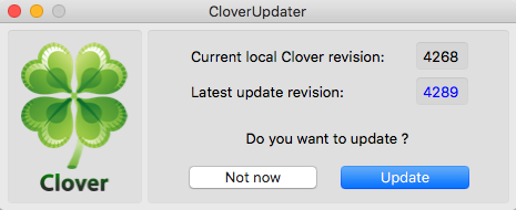

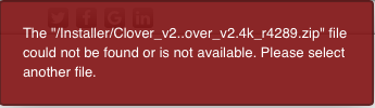

Guys I am getting this error when I click to update;
CloverUpdater was not changed since 4000 when it changes 2.3 -> 2.4.
Did you check any other 4xxx revision?

4289 is booting in verbose mode rather than with the Apple logo/progress bar - is this a change or do I need to set something?
Cheers!
Remove "-v" from boot-args.
Remove nvram.plist from EFI partition and from Mac root partition.
