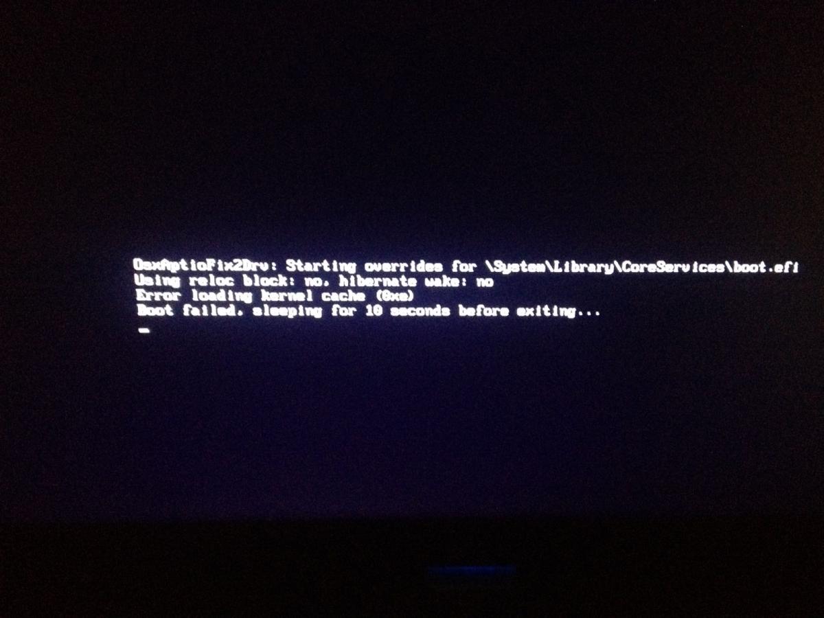

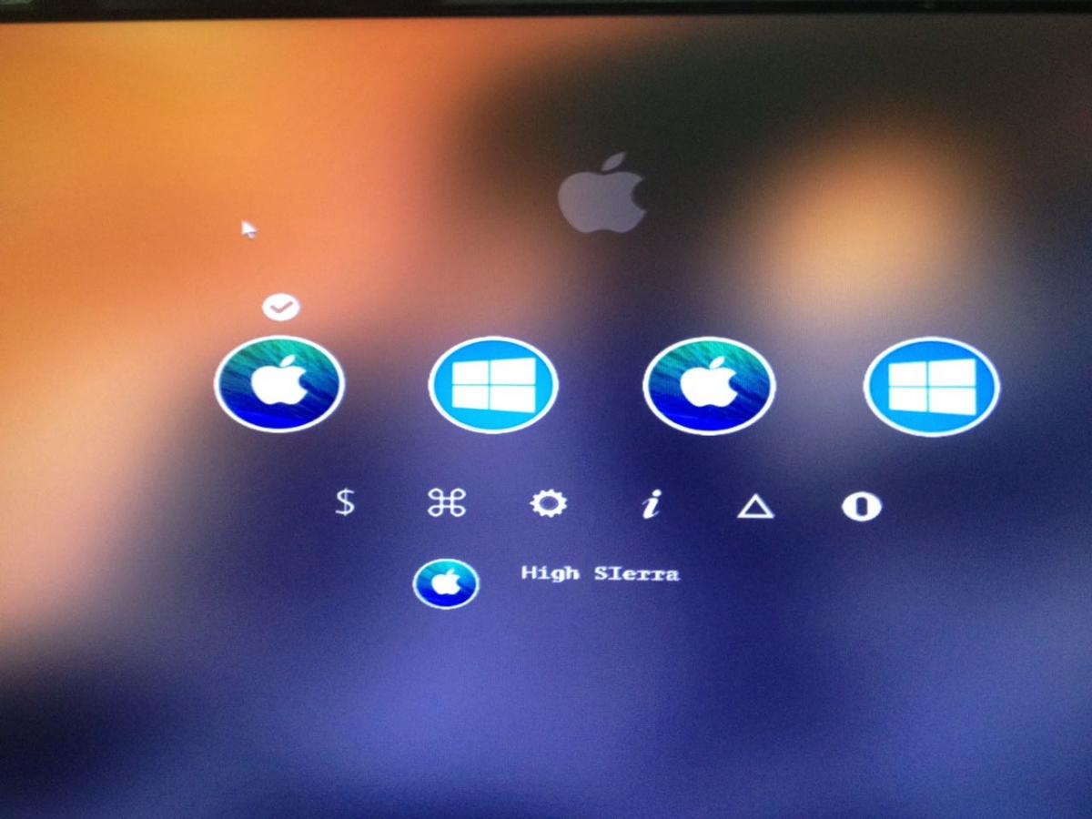

Hello guys. I have been having this problem since the High Sierra came out, and there are several other people with the same problem. This is due to Fusion Drive. I can not do a clean install or update the system. Already 2 updates came out after the release of High Sierra, and the two times I updated I had the same problem.
Always after I click to install the update or the system, it restarts and enters the black screen with a warning that is installing the update (or the system). Soon after doing the installation faster, again it restarts, enters the Clover and from there no more enters the system to finish the installation.
I'm stuck again between Clover and the system because I can not boot to finish the installation, it seems that it can not find the location where the files were placed. Can solve this in Clover? Is there a way I can get this resolved so I can log in and finish the installation?
Note 1: the times I managed to get around the problem, I had to do a clean installation on an old notebook hard drive, and then restore the HD image to the Fusion Drive. But now that I'm full of files and programs on Fusion Drive, I can not do the restore anymore because of space.
Note 2: I'm using HFS+
Clover after the second restart, where I can not go any further.
Stuck here, after choosing the boot.
I had the same issue, and it was caused by APFS.efi. Maybe your issue is the same. Try to use the one you find on your updated system disk in /usr/standalone/i386/.

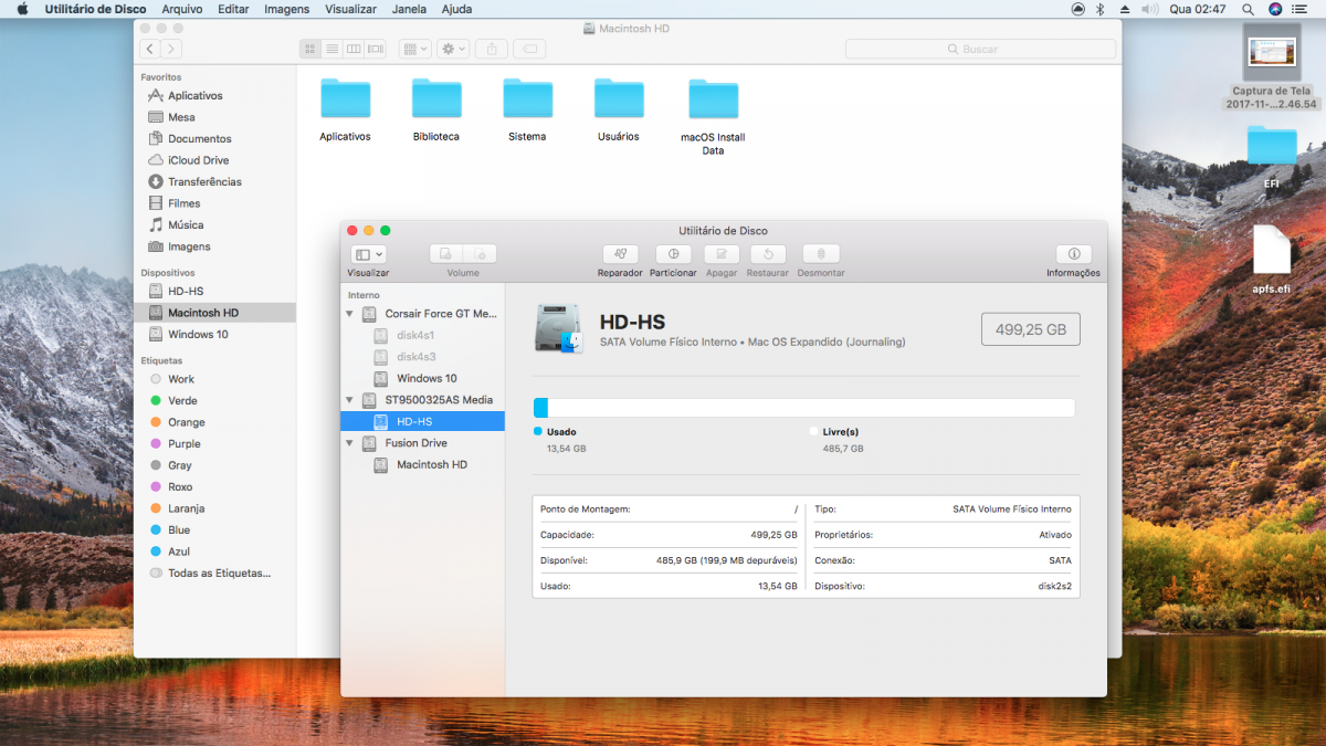

I just installed the system on a notebok hard drive, and update it to version 10.13.1. I noticed that in the notebook HD, when it will install the update, that first line of the boot, where have written "Starting overrides for \ System \ Library \ CoreServices \ boot.efi" changes to another pat, but in boot with Fusion Drive, the path does not change. That may be the conflict that is happening, on Fusion Drive need to change the path too, but it is not changing.
Now the doubt, how to make change? Could only the Clover developers fix it? I was unable to note which path was correct in the notebook hd.
I also noticed that a boot partition was created in Clover, name: Install from HD. In Fusion Drive the new install partition was not created. This partition served to install the update, then returned the normal boot partition.
I deleted APFS.efi, I tried without it, I put the new one, but nothing worked.
I think the problem is not there, but on Fusion Drive, and this path is not changing at the time of installation.
A doubt; is OsxAptioFix2Drv that changes the path automatically at installation and update time? Is it the problem in him?
You can boot into the installer and inspect the volumes. Whenever it says that line, it means that AptioFix is overriding the start image method for that boot.efi. Your issue is either the known path to the next stage of the installer boot.efi has changed and needs added to the list of installer paths, or that the apfs container probably has moved the boot.efi from the main volume, and you need to look at the preboot or boot, or whatever it's called for the boot.efi that actually loads the kernel. You can create a custom entry to start the next stage of the installer.
Can you tell me how to do this? This problem has bothered me since the release. If I can solve this I can still help several people who have the same problem.
Note: I'm using JHFS+
I just did, boot into the installer, go into the terminal and inspect the volumes. You should have the ability to use simple shell commands for unix/linux based OSes, especially if you are really using this as a learning experience and not just a way to save money by not buying a real mac, which violates TOS btw. Then create a custom entry for the volume and path to the next stage installer. You can check out the wiki for custom entries. If you absolutely need more help with the custom entry I can help you because I wrote that feature, but I want all the information about where the next stage installer is, the volume identifier, etc.... I have a feeling the entry will be easy after finding that stuff.
EDIT: The next stage installer may be in a directory beginning with a period so remember that it's hidden without using the correct parameters to commands, like
ls -a
EDIT2: Err... I'm not sure I was clear enough... I want the information even if you get the entry working because the installer path finder code probably needs adjusted.
EDIT3: If you don't have an installer to boot, try booting the recovery, single user mode, or recovery in single user (is that even possible? lol).
EDIT4: If you can't get anything to boot to get into terminal then you can use a linux live usb or the EFI shell, this probably helping more since you can find the identifiers of the volume easier. The boot.log would help with that too, you can generate debug.log (boot.log written to file as it is written in memory) by setting Boot/Debug=true in config.plist. You can edit config.plist in linux live cd or EFI shell with edit command.
Wait what does this mean? Seems like you installed perfectly fine....?
Well, let me try to be clearer. It's just that my English is not very good.
I have a flash drive with the installation of the High Sierra, and I also have an old 320GB hard drive, of notebook, with the High Sierra installed in it. This HD installs and updates perfectly because the problem is only on Fusion Drive.
The place where I want to get the installation and updates perfectly is on Fusion Drive with JHFS + partition, as I have a 250GB SSD and a 3TB HD.
This problem started happening in High Sierrra, previous versions of macOS did not have the problem.
I can open the High Sierra through the 500GB HD (HD-HS) and walk through the folders on Fusion Drive (Macintosh HD) as shown in the photo. I also have another HD with Windows 10, but this one is irrelevant.
Note: I do not leave the 500GB HD with the High Sierra on the computer. I only plug it in when there is a problem on Fusion Drive. It is for testing and troubleshooting purposes only.
Edit: I'm trying to understand how to solve the problem, but I think it's going to take a while.
