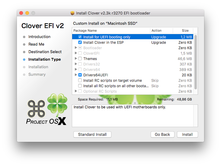

Fab1Man Posted October 2, 2015 Share Posted October 2, 2015 I managed to update my machine to El Capitan. Only problem is, I can't boot it with Clover on EFI. The Clover revision it's loading is 3197. I have a separate USB stick with the exact same config.plist on the latest 3270 revision and this can boot. I've cleaned out the EFI partition, copied everything from USB to EFI and still revision 3197 comes up at boot. Is there any way to do this more rigid? Link to comment https://www.insanelymac.com/forum/topic/284656-clover-general-discussion/page/331/#findComment-2172111 Share on other sites More sharing options...
arsradu Posted October 2, 2015 Share Posted October 2, 2015 I managed to update my machine to El Capitan. Only problem is, I can't boot it with Clover on EFI. The Clover revision it's loading is 3197. I have a separate USB stick with the exact same config.plist on the latest 3270 revision and this can boot. I've cleaned out the EFI partition, copied everything from USB to EFI and still revision 3197 comes up at boot. Is there any way to do this more rigid?did you check the box for installation in the ESP? Link to comment https://www.insanelymac.com/forum/topic/284656-clover-general-discussion/page/331/#findComment-2172127 Share on other sites More sharing options...

Fab1Man Posted October 2, 2015 Share Posted October 2, 2015 did you check the box for installation in the ESP? Yes. Attached the screenshot. EDIT: I had to update the CLOVERX64.efi version which was located in my Microsoft folder as bootmgfw.efi. All is fixed. Link to comment https://www.insanelymac.com/forum/topic/284656-clover-general-discussion/page/331/#findComment-2172235 Share on other sites More sharing options...

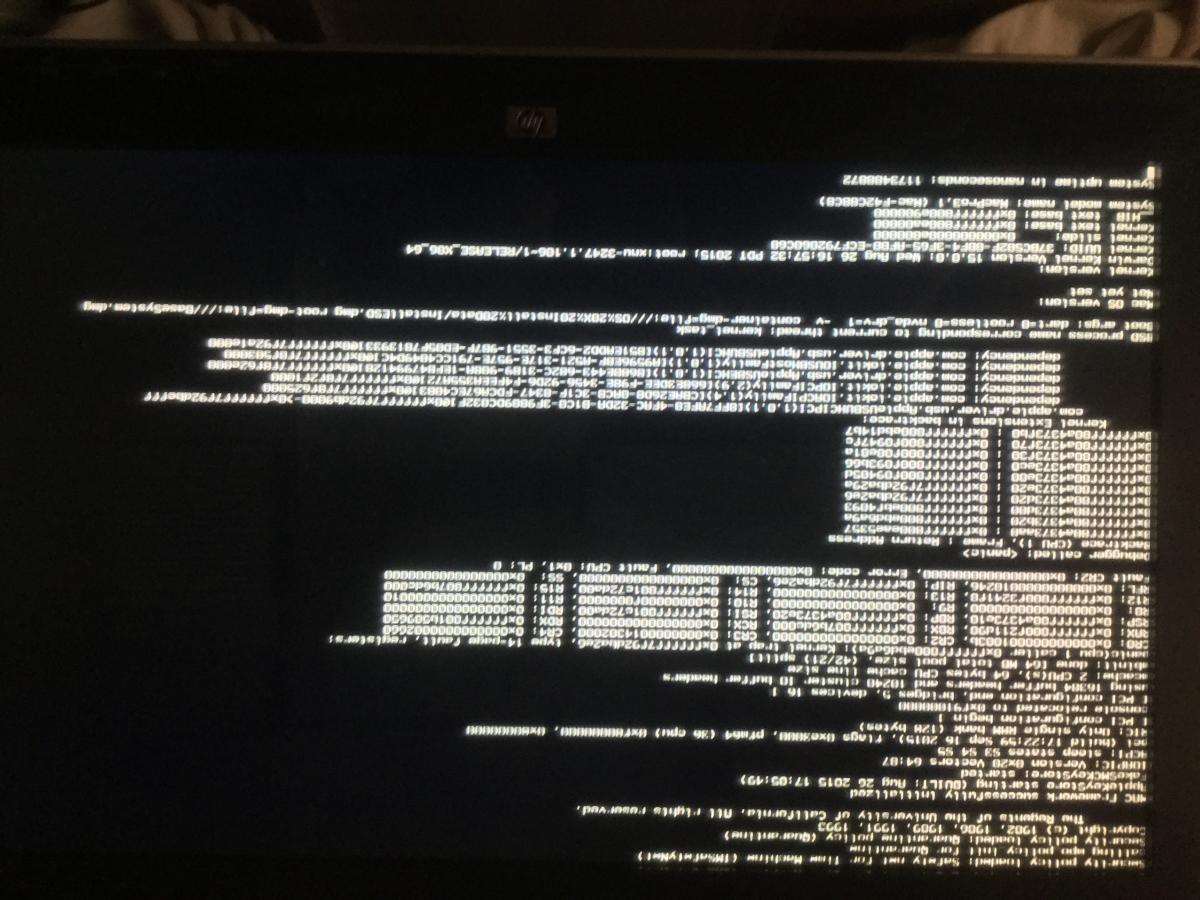

my.hackintosh.lb Posted October 2, 2015 Share Posted October 2, 2015 Hi, I think I am doing everything right (I'm noob though), I set bootconfig and csractiveconfig to 0x28 and 0x67 and also copy kexts to 10.11 folder, yet when I do a direct mac store upgrade or even a clean install from a usb, I get a kernel panic. This is weird! I been using clover ( now on r3270) on my HP pavilion p6230in (+gtx 750 ti) since mavericks and never did I encouter a kernel panic. I am lost! Link to comment https://www.insanelymac.com/forum/topic/284656-clover-general-discussion/page/331/#findComment-2172315 Share on other sites More sharing options...
