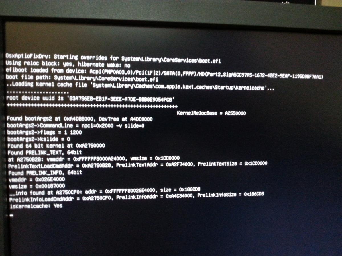

This is the error...
http://postimg.org/image/4l64ud0cl/
From the page:
http://wiki.phoenix.com/wiki/index.php/EFI_EXCEPTION_TYPE
My error code  X64  00000000000E should point to this:  #define EXCEPT_X64_PAGE_FAULT 14.
My system is overclocked, but the memory is well within the spec  1369Mhz with 9 9 9 27 timings. Never had this error before, this is the first. Maybe page_fault is somehow related to new efi drivers, but i am booting legacy on asus rampage III gene (x58). Don't know if it can be fixed or it is rev. 2808 the last clover for me :)
From the page:
Same thing here on my Asus p7p55d with i5-750 (legacy boot).  rev. 2815 works fine.  Updated to 2820 today and got the X64 exception.
Use new Clover with old boot (CloverEFI) file because all new feature in CloverX64.efi while boot works as is.

Thanks, no more X64 exception error, rev. 2820 works.Does this means that i should keep your boot, and replace new one on every new clover revision with yours, to get properly working clover on my system ?
Until we repair new boot.
