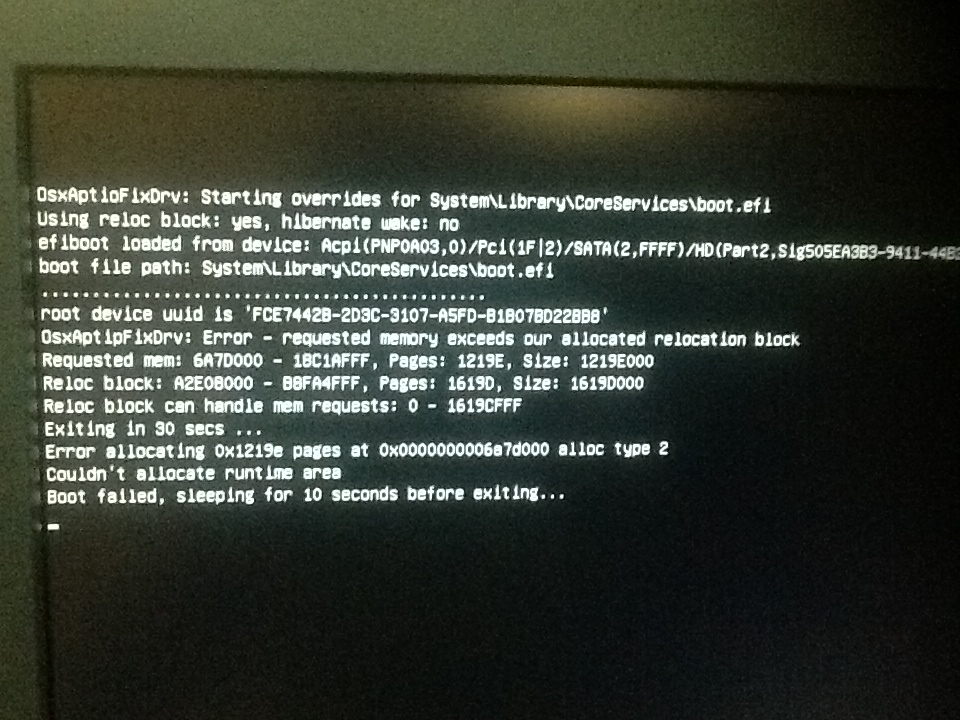

magnifico Posted August 7, 2014 Share Posted August 7, 2014 I have OsxAptioFix. Look why have you two osxaptio? not normal..delete Ops Link to comment Share on other sites More sharing options...

crusher Posted August 7, 2014 Share Posted August 7, 2014 You should read the installer's description of OsxAptioFixDrv and OsxLowMemoryFixDvr, it is suggested to use only one of those drivers. EDIT: does loading an existing and probably older IONetworkingFamily kext actually works? 5:512 0:009 Extra kext: EFI\CLOVER\kexts\10.10\IONetworkingFamily.kext Look only work and I manually go to sleep mode and after wake don't work USB 3.0 and after 2-5min System restart. Link to comment Share on other sites More sharing options...
