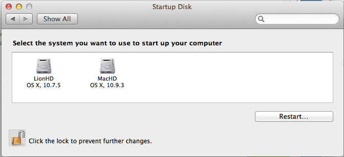

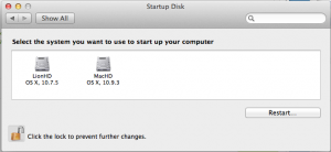

blackosx Posted June 13, 2014 Share Posted June 13, 2014 Changing boot device from the Startup Disk pref pane works fine using Clover in UEFI mode, though I'm not sure when using legacy boot mode (I will need to test) It works due to the nvram efi-boot-device variable. You can test it by issuing nvram -p from terminal. Here's mine before making a loading the Startup Disk pref pane and making a change efi-boot-device <array><dict><key>IOMatch</key><dict><key>IOProviderClass</key><string>IOMedia</string><key>IOPropertyMatch</key><dict><key>UUID</key><string>A9A532E5-2625-4E75-A807-B6642847CBF1</string></dict></dict></dict></array> and after efi-boot-device <array><dict><key>IOMatch</key><dict><key>IOProviderClass</key><string>IOMedia</string><key>IOPropertyMatch</key><dict><key>UUID</key><string>47E2A5DE-B075-4993-AFC1-B7867A644A5D</string></dict></dict><key>BLLastBSDName</key><string>disk1s3</string></dict></array> And looking at my Clovers boot-log from next boot I see 6:538 0:019 GetEfiBootDeviceFromNvram: 6:539 0:000 efi-boot-device-data: PciRoot(0x0)\Pci(0x1F,0x2)\Sata(0x0,0x0,0x0)\HD(3,GPT,47E2A5DE-B075-4993-AFC1-B7867A644A5D,0x224028,0x6C72FC0) EDIT: Yep, works fine using legacy boot too but make sure you have the following rc.script installed: /etc/rc.shutdown.d/80.save_nvram_plist.local Looking at boot-log from next boot. 4:727 0:000 Loading nvram.plist from Vol 'BackupMAV' - loaded, size=4015 4:742 0:015 PutNvramPlistToRtVars ... …. 4:742 0:000 Adding Key: efi-boot-device: String: Size = 264, Val = '<array><dict><key>IOMatch</key><dict><key>IOProviderClass</key><string>IOMedia</string><key>IOPropertyMatch</key><dict><key>UUID</key><string>47E2A5DE-B075-4993-AFC1-B7867A644A5D</string></dict></dict><key>BLLastBSDName</key><string>disk2s3</string></dict></array>': Success 4:742 0:000 Adding Key: efi-boot-device-data: Data: Size = 74: Success … These test were from 10.9. If using 10.10 then you will need the latest workaround for initiating the rc.scripts as the current method no longer works with 10.10. 2 Link to comment https://www.insanelymac.com/forum/topic/284656-clover-general-discussion/page/181/#findComment-2029869 Share on other sites More sharing options...

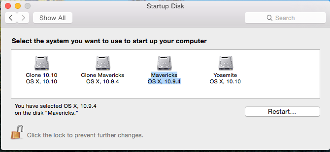

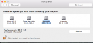

ADHDMedia Posted June 14, 2014 Share Posted June 14, 2014 Changing boot device from the Startup Disk pref pane works fine using Clover in UEFI mode, though I'm not sure when using legacy boot mode (I will need to test) It works due to the nvram efi-boot-device variable. You can test it by issuing nvram -p from terminal. Here's mine before making a loading the Startup Disk pref pane and making a change efi-boot-device <array><dict><key>IOMatch</key><dict><key>IOProviderClass</key><string>IOMedia</string><key>IOPropertyMatch</key><dict><key>UUID</key><string>A9A532E5-2625-4E75-A807-B6642847CBF1</string></dict></dict></dict></array>and after efi-boot-device <array><dict><key>IOMatch</key><dict><key>IOProviderClass</key><string>IOMedia</string><key>IOPropertyMatch</key><dict><key>UUID</key><string>47E2A5DE-B075-4993-AFC1-B7867A644A5D</string></dict></dict><key>BLLastBSDName</key><string>disk1s3</string></dict></array>And looking at my Clovers boot-log from next boot I see 6:538 0:019 GetEfiBootDeviceFromNvram: 6:539 0:000 efi-boot-device-data: PciRoot(0x0)\Pci(0x1F,0x2)\Sata(0x0,0x0,0x0)\HD(3,GPT,47E2A5DE-B075-4993-AFC1-B7867A644A5D,0x224028,0x6C72FC0)EDIT: Yep, works fine using legacy boot too but make sure you have the following rc.script installed:/etc/rc.shutdown.d/80.save_nvram_plist.local Looking at boot-log from next boot. 4:727 0:000 Loading nvram.plist from Vol 'BackupMAV' - loaded, size=4015 4:742 0:015 PutNvramPlistToRtVars ... …. 4:742 0:000 Adding Key: efi-boot-device: String: Size = 264, Val = '<array><dict><key>IOMatch</key><dict><key>IOProviderClass</key><string>IOMedia</string><key>IOPropertyMatch</key><dict><key>UUID</key><string>47E2A5DE-B075-4993-AFC1-B7867A644A5D</string></dict></dict><key>BLLastBSDName</key><string>disk2s3</string></dict></array>': Success 4:742 0:000 Adding Key: efi-boot-device-data: Data: Size = 74: Success …These test were from 10.9. If using 10.10 then you will need the latest workaround for initiating the rc.scripts as the current method no longer works with 10.10. Where do I find that rc.script? Never mind, I have it installed... Trying to reboot to different OS now. Ya mine just restarts to Clover GUI. Link to comment https://www.insanelymac.com/forum/topic/284656-clover-general-discussion/page/181/#findComment-2029905 Share on other sites More sharing options...
Slice Posted June 14, 2014 Share Posted June 14, 2014 This feature was the first goal in creating the Clover. It works for me since the first version. blackosx already explained how it works. I have to say about NVRAM used in the technology. Legacy Clover (CloverEFI). rc script will create a file nvram.plist after the Restart button pressed and keep information about next drive started. UEFI Clover with hardware not supporting NVRAM. You should have /EFI/CLOVER/drivers64UEFI/EmuVariableUefi-64.efi UEFI Clover with hardware NVRAM. This is my computer #1 in signature. Additional bonus I have is Panic.log. For example Anonymous UUID: 43065937-BBF0-8F2F-C339-5635BC71CE03 Wed May 28 07:56:29 2014 panic(cpu 0 caller 0xffffff80002dbf5e): Kernel trap at 0xffffff7f8253ca25, type 13=general protection, registers: CR0: 0x000000008001003b, CR2: 0x0000000103b83fc8, CR3: 0x000000000fd3405b, CR4: 0x00000000000606e0 RAX: 0x6a5993c096a5009c, RBX: 0x0000000000000001, RCX: 0x000000000000064c, RDX: 0xffffff8000686fd0 RSP: 0xffffff80e7c77ea0, RBP: 0xffffff80e7c77ed0, RSI: 0x0000000000000000, RDI: 0x0000000000000000 R8: 0x0000000000000000, R9: 0x0000000000000010, R10: 0x0000000000000000, R11: 0xffffff8000686fd0 R12: 0xffffff80184015e8, R13: 0xffffff80279e6284, R14: 0xffffff8110cdbb40, R15: 0x0000000000000000 RFL: 0x0000000000010002, RIP: 0xffffff7f8253ca25, CS: 0x0000000000000008, SS: 0x0000000000000010 Fault CR2: 0x0000000103b83fc8, Error code: 0x0000000000000000, Fault CPU: 0x0 Backtrace (CPU 0), Frame : Return Address 0xffffff80e7c83c50 : 0xffffff8000222fa9 0xffffff80e7c83cd0 : 0xffffff80002dbf5e 0xffffff80e7c83ea0 : 0xffffff80002f3456 0xffffff80e7c83ec0 : 0xffffff7f8253ca25 0xffffff80e7c77ed0 : 0xffffff80002e336e 0xffffff80e7c77f10 : 0xffffff80002e2c8e 0xffffff80e7c77f50 : 0xffffff80002e1fd6 0xffffff80e7c77f80 : 0xffffff80002db51f 0xffffff80e7c77fd0 : 0xffffff80002f3619 0xffffff810fa1bde0 : 0xffffff800021a3e7 0xffffff810fa1be20 : 0xffffff800021baba 0xffffff810fa1be70 : 0xffffff8000217b9b 0xffffff810fa1bf10 : 0xffffff8000229627 0xffffff810fa1bf40 : 0xffffff800021d604 0xffffff810fa1bf70 : 0xffffff80002c989d 0xffffff810fa1bfb0 : 0xffffff80002f3c76 Kernel Extensions in backtrace: com.coresystems.driver.DirectHW(1.3)[46ED721E-1B50-31CA-B1A2-D6F7140E7906]@0xffffff7f8253b000->0xffffff7f8253efff BSD process name corresponding to current thread: Terminal Boot args: -v slide=0 Mac OS version: 13D65 Kernel version: Darwin Kernel Version 13.2.0: Thu Apr 17 23:03:13 PDT 2014; root:xnu-2422.100.13~1/RELEASE_X86_64 Kernel UUID: ADD73AE6-88B0-32FB-A8BB-4F7C8BE4092E System model name: iMac12,2 (Mac-942B5BF58194151B) System uptime in nanoseconds: 13885620970427 last loaded kext at 855277706575: com.apple.filesystems.cd9660 1.4.4 (addr 0xffffff7f8253f000, size 36864) loaded kexts: com.coresystems.driver.DirectHW 1.3 org.voodoo.driver.VoodooHDA 2.8.4 org.slice.RadeonMonitor 1.0.0d1 2 Link to comment https://www.insanelymac.com/forum/topic/284656-clover-general-discussion/page/181/#findComment-2029936 Share on other sites More sharing options...
ADHDMedia Posted June 14, 2014 Share Posted June 14, 2014 So what is the end result when you use this feature with legacy boot (not UEFI)? Does your system go through a full reboot and go through bios and then just boot through Clover into the selected OS? Or how does it work...? I'd like to be able to jump back and forth between 10.10 and 10.9.3 with the prefpane, but I'm not ready to make the jump to upgrading my board to UEFI boot... Haha Link to comment https://www.insanelymac.com/forum/topic/284656-clover-general-discussion/page/181/#findComment-2029939 Share on other sites More sharing options...
Slice Posted June 14, 2014 Share Posted June 14, 2014 So what is the end result when you use this feature with legacy boot (not UEFI)? Does your system go through a full reboot and go through bios and then just boot through Clover into the selected OS? Or how does it work...? I'd like to be able to jump back and forth between 10.10 and 10.9.3 with the prefpane, but I'm not ready to make the jump to upgrading my board to UEFI boot... Haha Yes, exactly as you said. I have two systems 10.7.5 and 10.9.3. I can choose one in Startup Disk and reboot. I can go out and wait what is happen. The computer goes through full restart, bios, then CloverGUI, timeout set to 5 seconds, then start the OS chosen in Startup DIsk. I am lazy to show you the Video, trust me, it occurs. It works for both legacy Clover and UEFI Clover. Tested and always works with all Clover versions on all 4 my computers. Link to comment https://www.insanelymac.com/forum/topic/284656-clover-general-discussion/page/181/#findComment-2029951 Share on other sites More sharing options...
ADHDMedia Posted June 14, 2014 Share Posted June 14, 2014 I just got mine working, and it works exactly as advertised Thanks bro. Is there any way to speed up the CloverGUI process? I set the timeout to 0, but it still takes a good 15-20 seconds, maybe longer, for Clover to finish loading and start booting the OS. What can I do to speed up Clover? You guys were right, this is getting better and better lol Link to comment https://www.insanelymac.com/forum/topic/284656-clover-general-discussion/page/181/#findComment-2029953 Share on other sites More sharing options...
