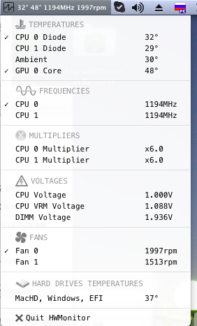

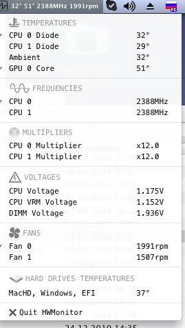

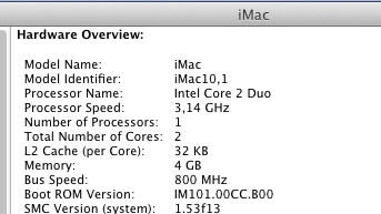

There is the method. I have C2D @2400MHz but set into config.plist
	<key>CPU</key>
	<dict>
		<key>FrequencyMHz</key>
		<integer>3141</integer>
	</dict>
And results
Speedstep works normally
So this setting is cosmetic only.
