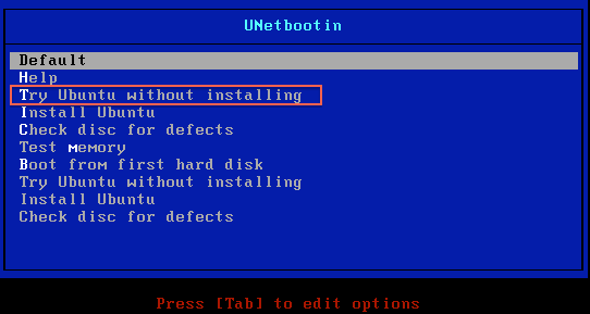

Guest AllanMax Posted December 18, 2013 Share Posted December 18, 2013 I'm trying to install Ubuntu, but not loads. create flash boot using Unebootin app for Mac, restart and select the flash drive menu in Clover, and I select this option. Link to comment Share on other sites More sharing options...
Allan Posted December 18, 2013 Share Posted December 18, 2013 Try create penboot without unebootin. Link to comment Share on other sites More sharing options...

joe75 Posted December 18, 2013 Share Posted December 18, 2013 I'm trying to install Ubuntu, but not loads. create flash boot using Unebootin app for Mac, restart and select the flash drive menu in Clover, and I select this option. Normally you would boot directly from your unetbootin usb. My experience is unetbootin is only dependable when used from windows or linux Link to comment Share on other sites More sharing options...

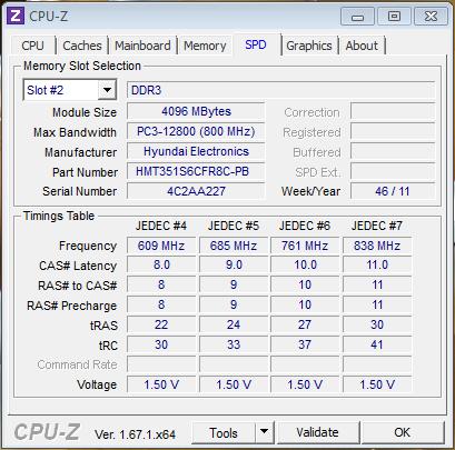

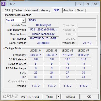

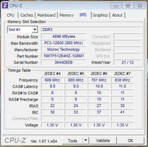

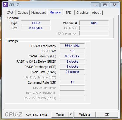

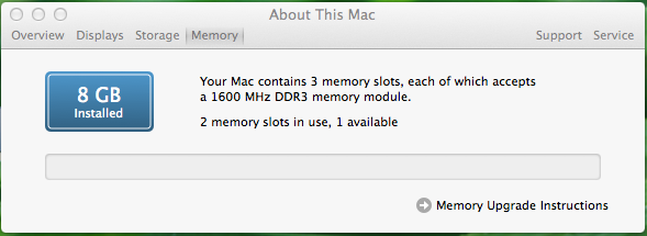

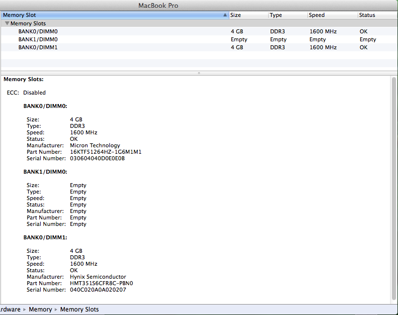

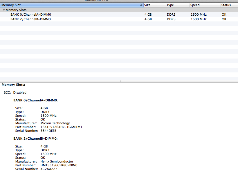

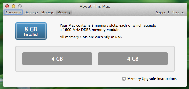

sot_22 Posted December 20, 2013 Share Posted December 20, 2013 hello , i installed Clover v2k_r2377 (legacy bios mbr boot) and it detects memory slots incorrectly (3 instead of 2) , here i have some screenshots and my config.plist : the screenshots with 3 memory banks are from clover, the other are from chameleon and win 7 my config.plist : http://www48.zippyshare.com/v/80566198/file.html my specs are below my avatar and smbios correct ,thank you *** my boot.log : detects it correctly at first but: 2:714 0:000 ScanSPD() start 2:715 0:000 SMBus CmdReg: 0x3 2:715 0:000 Scanning SMBus [8086:1C22], mmio: 0xF2524004, ioport: 0xEFA0, hostc: 0x1 2:730 0:014 SPD[0]: Type 11 @0x50 2:740 0:009 Not using XMP because it is not present 2:740 0:000 DDR speed 1600MHz 2:740 0:000 Slot: 0 Type 24 4096MB 1600MHz Vendor=Micron Technology PartNo=16KTF51264HZ-1G6M1M1 SerialNo=030604040D0E0E0B 2:755 0:014 SPD[1]: Type 11 @0x51 2:764 0:009 Not using XMP because it is not present 2:764 0:000 DDR speed 1600MHz 2:764 0:000 Slot: 1 Type 24 4096MB 1600MHz Vendor=Hynix Semiconductor PartNo=HMT351S6CFR8C-PBN0 SerialNo=040C020A0A020207 2:791 0:026 SPD[4]: Type 82 @0x54 2:806 0:015 SPD[5]: Type 82 @0x55 2:821 0:014 SPD[6]: Type 78 @0x56 2:978 0:156 SPD[12]: Type 63 @0x5C 3:044 0:066 ScanSPD() end 43:635 0:000 Trusting SMBIOS... 43:635 0:000 Channels: 2 43:635 0:000 Interleave: 0 2 1 3 4 6 5 7 8 10 9 11 12 14 13 15 16 18 17 19 20 22 21 23 43:635 0:000 partNum=16KTF51264HZ-1G6M1 43:635 0:000 SMBIOS Type 17 Index = 0 => 0 0: 43:635 0:000 BANK0 DIMM0 1600MHz 4096MB 43:635 0:000 mTotalSystemMemory = 4096 43:635 0:000 SMBIOS Type 17 Index = 1 => 2 2: 43:635 0:000 BANK1 DIMM0 EMPTY 43:635 0:000 partNum=HMT351S6CFR8C-PB 43:635 0:000 SMBIOS Type 17 Index = 2 => 1 1: 43:635 0:000 BANK0 DIMM1 1600MHz 4096MB 43:635 0:000 mTotalSystemMemory = 8192 43:635 0:000 NumberOfMemoryDevices = 3 --------------- Link to comment Share on other sites More sharing options...

Slice Posted December 20, 2013 Share Posted December 20, 2013 hello , i installed Clover v2k_r2377 (legacy bios mbr boot) and it detects memory slots incorrectly (3 instead of 2) , here i have some screenshots and my config.plist : the screenshots with 3 memory banks are from clover, the other are from chameleon and win 7 my config.plist : http://www48.zippyshare.com/v/80566198/file.html my specs are below my avatar and smbios correct ,thank you *** my boot.log : detects it correctly at first but: 2:714 0:000 ScanSPD() start 2:715 0:000 SMBus CmdReg: 0x3 2:715 0:000 Scanning SMBus [8086:1C22], mmio: 0xF2524004, ioport: 0xEFA0, hostc: 0x1 2:730 0:014 SPD[0]: Type 11 @0x50 2:740 0:009 Not using XMP because it is not present 2:740 0:000 DDR speed 1600MHz 2:740 0:000 Slot: 0 Type 24 4096MB 1600MHz Vendor=Micron Technology PartNo=16KTF51264HZ-1G6M1M1 SerialNo=030604040D0E0E0B 2:755 0:014 SPD[1]: Type 11 @0x51 2:764 0:009 Not using XMP because it is not present 2:764 0:000 DDR speed 1600MHz 2:764 0:000 Slot: 1 Type 24 4096MB 1600MHz Vendor=Hynix Semiconductor PartNo=HMT351S6CFR8C-PBN0 SerialNo=040C020A0A020207 2:791 0:026 SPD[4]: Type 82 @0x54 2:806 0:015 SPD[5]: Type 82 @0x55 2:821 0:014 SPD[6]: Type 78 @0x56 2:978 0:156 SPD[12]: Type 63 @0x5C 3:044 0:066 ScanSPD() end 43:635 0:000 Trusting SMBIOS... 43:635 0:000 Channels: 2 43:635 0:000 Interleave: 0 2 1 3 4 6 5 7 8 10 9 11 12 14 13 15 16 18 17 19 20 22 21 23 43:635 0:000 partNum=16KTF51264HZ-1G6M1 43:635 0:000 SMBIOS Type 17 Index = 0 => 0 0: 43:635 0:000 BANK0 DIMM0 1600MHz 4096MB 43:635 0:000 mTotalSystemMemory = 4096 43:635 0:000 SMBIOS Type 17 Index = 1 => 2 2: 43:635 0:000 BANK1 DIMM0 EMPTY 43:635 0:000 partNum=HMT351S6CFR8C-PB 43:635 0:000 SMBIOS Type 17 Index = 2 => 1 1: 43:635 0:000 BANK0 DIMM1 1600MHz 4096MB 43:635 0:000 mTotalSystemMemory = 8192 43:635 0:000 NumberOfMemoryDevices = 3 --------------- Set SMBIOS->Trust=false 1 Link to comment Share on other sites More sharing options...
sot_22 Posted December 20, 2013 Share Posted December 20, 2013 i did nothing changed here is and this from log , it seems it detects ok but in about this mac has 3 slots 2:494 0:000 Total Memory Slots Count = 2 2:494 0:000 Type 17 Index = 0 2:494 0:000 SmbiosTable.Type17->Speed = 1333 2:494 0:000 SmbiosTable.Type17->Size = 4096 2:494 0:000 Type 17 Index = 1 2:494 0:000 SmbiosTable.Type17->Speed = 1333 2:494 0:000 SmbiosTable.Type17->Size = 4096 2:494 0:000 Boot status=0 2:494 0:000 Clover revision: 2377 running on 4291AN9 2:494 0:000 ... with board 4291AN9 2:494 0:000 Clover load options size = 0 bytes 2:494 0:000 PlistPath: EFI\CLOVER\config.plist Link to comment Share on other sites More sharing options...
Slice Posted December 20, 2013 Share Posted December 20, 2013 i did nothing changed here is and this from log , it seems it detects ok but in about this mac has 3 slots 2:494 0:000 Total Memory Slots Count = 2 2:494 0:000 Type 17 Index = 0 2:494 0:000 SmbiosTable.Type17->Speed = 1333 2:494 0:000 SmbiosTable.Type17->Size = 4096 2:494 0:000 Type 17 Index = 1 2:494 0:000 SmbiosTable.Type17->Speed = 1333 2:494 0:000 SmbiosTable.Type17->Size = 4096 2:494 0:000 Boot status=0 2:494 0:000 Clover revision: 2377 running on 4291AN9 2:494 0:000 ... with board 4291AN9 2:494 0:000 Clover load options size = 0 bytes 2:494 0:000 PlistPath: EFI\CLOVER\config.plist And what about second part of your log? 43:635 0:000 Trusting SMBIOS... 43:635 0:000 Channels: 2 43:635 0:000 Interleave: 0 2 1 3 4 6 5 7 8 10 9 11 12 14 13 15 16 18 17 19 20 22 21 23 43:635 0:000 partNum=16KTF51264HZ-1G6M1 43:635 0:000 SMBIOS Type 17 Index = 0 => 0 0: 43:635 0:000 BANK0 DIMM0 1600MHz 4096MB 43:635 0:000 mTotalSystemMemory = 4096 43:635 0:000 SMBIOS Type 17 Index = 1 => 2 2: 43:635 0:000 BANK1 DIMM0 EMPTY 43:635 0:000 partNum=HMT351S6CFR8C-PB 43:635 0:000 SMBIOS Type 17 Index = 2 => 1 1: 43:635 0:000 BANK0 DIMM1 1600MHz 4096MB 43:635 0:000 mTotalSystemMemory = 8192 43:635 0:000 NumberOfMemoryDevices = 3 Link to comment Share on other sites More sharing options...
sot_22 Posted December 20, 2013 Share Posted December 20, 2013 second part is: 9:867 0:000 SMBIOS Type 17 Index = 0 => 0 0:9:867 0:000 BANK0 DIMM0 1600MHz 4096MB9:867 0:000 mTotalSystemMemory = 40969:867 0:000 SMBIOS Type 17 Index = 1 => 2 2:9:867 0:000 BANK1 DIMM0 EMPTY9:867 0:000 SMBIOS Type 17 Index = 2 => 1 1:9:867 0:000 BANK0 DIMM1 1600MHz 4096MB9:867 0:000 mTotalSystemMemory = 81929:867 0:000 NumberOfMemoryDevices = 3 it just dont have the "Trusting SMBIOS..." my boot log : http://www23.zippyshare.com/v/26409746/file.html Link to comment Share on other sites More sharing options...
apianti Posted December 20, 2013 Share Posted December 20, 2013 You have a desktop? What is your motherboard/laptop model? Seems you either have the memory in incorrect slots or you have an old non dual channel setup, in that case set SMBIOS/Memory/Channels to 1. You're not already seeing that or any keys under SMBIOS/Memory are you? Link to comment Share on other sites More sharing options...
sot_22 Posted December 20, 2013 Share Posted December 20, 2013 hi , i'm on a laptop below my avatar are the specs "x220 lenovo with i5 2520m 8gb ram", as you can see from windows screenshots in : #3302 i have dual channel , 2 slots setup Link to comment Share on other sites More sharing options...
apianti Posted December 20, 2013 Share Posted December 20, 2013 First you don't have identical memory modules, so it can't work in dual channel. Second if you had dual channel then your modules would be in slots 0 and 2 according to the spd, they are not. Perform geekbench with chameleon, with clover, then with clover and one channel. Also your SMBIOS is probably wrong not correct like you said since it says your memory is 1333 not 1600... Link to comment Share on other sites More sharing options...
sot_22 Posted December 20, 2013 Share Posted December 20, 2013 have you look at the screenshots in #3302 ? please look chameleon and win screenshots and how it reports memory correctly when i mean that smbios is correct i mean that i have right type macbookpro 8,1 for my laptop and cpu , clover detects that correctly and how clover says my memory smbios is 1333 and then at system report says 1600? i know what memory i have and its obvious 1600 dual channel this is its clover bug Link to comment Share on other sites More sharing options...
apianti Posted December 20, 2013 Share Posted December 20, 2013 Nope you are incorrect, it's not clover bug, your ram controller can't be operating in dual channel if memory modules aren't populated in interleaved slots. Clover is only spitting out what it has gotten from your ram controller and original SMBIOS, that's what YOUR hardware is reporting. Windows and chameleon only appear to think that it's working correctly because your SMBIOS says that. As I said you can't have working dual channel with non identical modules, your modules require different voltages. Did you perform geek bench tests looking at memory scores? I doubt there will be much of difference... Link to comment Share on other sites More sharing options...
sot_22 Posted December 20, 2013 Share Posted December 20, 2013 i'll perform the tests but first clover must work correctly and not report 3 slots , this don't have to do with my memory modules , and when i edit my config.plist <key>Memory</key><dict><key>Channels</key><integer>2</integer> <key>SlotCount</key><integer>2</integer> clover does not change the number to 2 slots in system report ... how can i expect to change the channels and do benchmarks ? it will be the same if clover does not change anything Link to comment Share on other sites More sharing options...
apianti Posted December 20, 2013 Share Posted December 20, 2013 Because the memory modules ARE NOT IN SLOTS 0 and 2!!!!!!!!! It's actually the only thing that is detecting correctly. You have the extra empty module in the second slot of the first channel because it's slot 2 which IS NOT POPULATED! Your firmware is trash and isn't properly generating SMBIOS. Set channels to one and you will no longer have empty slot. And I'm going to say it one last time, the memory controller INTERLEAVES the slots when it's working in dual channel mode meaning that with two modules installed they will be in slots 0 and 2, for single they will just count up from zero, so two modules will be in slots 0 and 1. Which mode do you think yours is working in? It's certainly NOT dual. Link to comment Share on other sites More sharing options...
sot_22 Posted December 20, 2013 Share Posted December 20, 2013 ok first thank you for your time i open up my laptop and see the modules , they are the same frequency 1600Mhz, hynix 4gb 2rx8 pc3-12800s-11-11-f3 and mt16ktf51264hz-1g6m1 i'll edit my config for single channel now to see and i'll report ****** here is my SMBIOS section of config.plist , is there something wrong? cause it reports exactly the same 3 slots as before (i test it and with Trust false and nothing changed) --------------------------- <key>SMBIOS</key> <dict> <key>Trust</key> <true/> <key>SerialNumber</key> <string>*************</string> </dict> <key>Memory</key> <dict> <key>Channels</key> <integer>1</integer> <key>SlotCount</key> <integer>2</integer> </dict> <key>SystemParameters</key> <dict> <key>InjectKexts</key> <false/> <key>InjectSystemID</key> <false/> </dict> ------------------------------------- Link to comment Share on other sites More sharing options...
apianti Posted December 20, 2013 Share Posted December 20, 2013 You ended the SMBIOS dictionary before the memory keys. Also I probably wouldn't trust your SMBIOS. Link to comment Share on other sites More sharing options...
sot_22 Posted December 20, 2013 Share Posted December 20, 2013 i changed to this : <key>SMBIOS</key> <dict> <key>Trust</key> <false/> <key>SerialNumber</key> <string>***********</string> <key>Memory</key> <dict> <key>Channels</key> <integer>1</integer> <key>SlotCount</key> <integer>2</integer> </dict> <key>SystemParameters</key> <dict> <key>InjectKexts</key> <false/> <key>InjectSystemID</key> <false/> </dict> and now it says in about mac - memory : Your Mac contains 0 memory slots, each of which accepts a ??? memory module. No user-installable memory slots exist. and in system report : There was an error while gathering this information. Link to comment Share on other sites More sharing options...
tluck Posted December 20, 2013 Share Posted December 20, 2013 @sot_22 et al, on my T420 is similar to the X220 finds this. 8GB is correct. 2 dimms. setting SMBIOS trust to true or false didn't make any difference in this aspect. $ grep -i slot boot.log 3:071 0:000 Total Memory Slots Count = 2 3:658 0:000 Slot: 0 Type 24 4096MB 1333MHz Vendor=Ramaxel Technology PartNo=RMT3020EC58E9F1333A SerialNo=040206030901010B 3:682 0:000 Slot: 1 Type 24 4096MB 1333MHz Vendor=Ramaxel Technology PartNo=RMT3020EC58E9F1333A SerialNo=04030C0D0509030A tluck@toms-mac /Library/Logs/CloverEFI $ grep -i bank boot.log 9:565 0:000 BANK0 DIMM0 1333MHz 4096MB 9:565 0:000 BANK1 DIMM0 EMPTY 9:565 0:000 BANK0 DIMM1 1333MHz 4096MB Link to comment Share on other sites More sharing options...
apianti Posted December 20, 2013 Share Posted December 20, 2013 Please post the three sections of the boot log pertaining to memory. Same thing applies to you tluck, only operating in single channel mode. Link to comment Share on other sites More sharing options...
