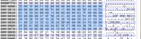

What about UEFI GOP AMD7xxx about Clover?
Clover AMD7xxx read UEFI?
As windows8.1 used in conjunction with Fast Boot GOP AMD7xxx UEFI?
What about?
In my config Clover works with UEFI AMD HD6670.
So I have a really strange problem. On my z68 build I was troubleshooting a usb3 issue and got an instant reboot, which is something to expect during troubleshooting of course, but when I rebooted clover will no longer auto boot. I have it configured to boot after 1 second and it has always worked flawlessly until now. It doesn't show a countdown or anything. I tried changing the values back and forth a few times but it made no difference. I also tried turning on fast boot, but to my surprise it still just sits at the boot loader until I press enter. Did cover create a file to override my config or something? I absolutely can't figure this out.
Yes but what I mean is if Clover work with UEFI Bios GOP in Graphics?
And in settings Fast Boot
Yes, I mean Clover works with CSM disabled, Graphics card reflashed to UEFI GOP BIOS and I see it take effect: no more black border at native resolution.
I also have VFCT table.
  0000: 56 46 43 54 84 46 00 00 01 65 41 4C 41 53 4B 41  VFCT.F...eALASKA
  0010: 41 20 4D 20 49 00 00 00 01 00 00 00 41 4D 44 00  A M I.......AMD.
  0020: 47 4F 50 31 32 9B A3 5D BD C6 CF 49 95 A6 E8 E4  GOP12..]...I....
  0030: 2E CD 79 A7 4C 00 00 00 00 00 00 00 00 00 00 00  ..y.L...........
  0040: 00 00 00 00 00 00 00 00 00 00 00 00 01 00 00 00  ................
See GOP
ASUS Fast boot?  :hysterical:
I am using Gigabyte.
See GOP

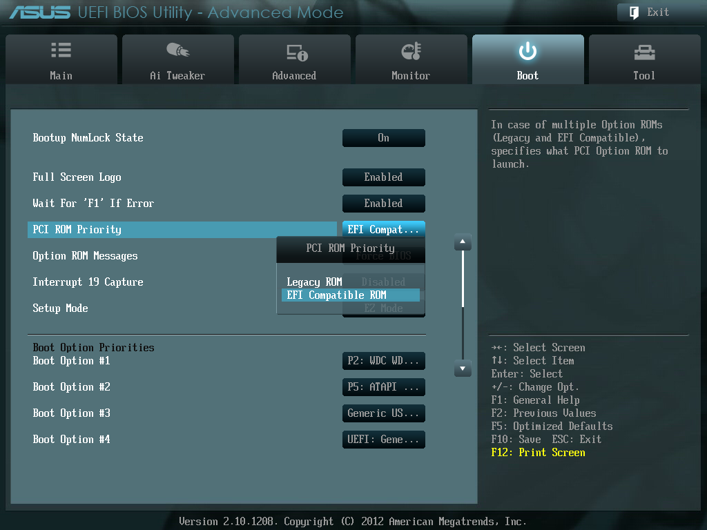

I put in my UEFI GOP Sapphire HD7770 and activated the EFI Compatible ROM function on my Asus UEFI BIOS.
But it does not change anything for Windows8 to have a fastboot
The problem is that the hardware bypass the MSM and get right!!
I do not know what the problem is this function not take my motherboard, or I have placed UEFI GOP fails or if the system (Windows8) not be abilitado to fastboot.
Clover not tested as the main boot and did not care nehum HD containing OS X.
Windows is on another HD unplugged from my pc, I do not want a dual boot with Windows and OS X.
I've unpacked the process of flashBios on my HD7770 and went back to the original bios;
